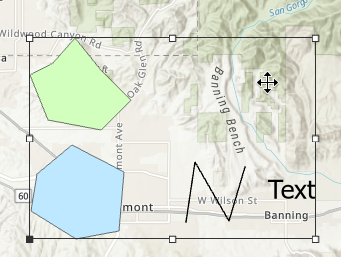

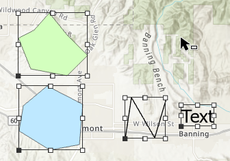

Select and UnSelect Elements
When a graphics element or group element is selected, it means its bounding box is displayed on the view and grab handles are also shown. Selected elements can be moved and resized interactively with any of the COTS graphics tools.
Setting elements as selected can be done programmatically or graphically on the view. Programmatic selection takes the element or elements to be selected and highlights them on the screen. Use SelectElement(element) and SelectElements(list_of_elements) accordingly. Graphic selection uses the selection geometry to intersect the geometries of those elements (graphic or group) that will be selected and then highlights them. In this example, all the elements with a name beginning with "Text" are selected programmatically:

When selecting elements programmatically, only a group element or its children can be selected but not both. This is reflected on the display when selected elements are highlighted. Note that the child elements nested within a given group element are never highlighted in conjunction with their parent - it's an either/or. If you specify a group element and one or more of its children in the list of elements to be selected then the child elements are filtered out of the list. When selecting graphically, the view element selection automatically applies the same filtering logic (the same is true for element selection on a layout) so that if a group element and one or more of its children are intersected by the selection geometry, the parent group element will be element that is selected.
| Group can be selected...or | Its children can be selected....but not both |
In this example, a group element and its children are being specified for selection. The selection logic will filter out the children selecting only the (top most) parent - the group element in this case.

Move Elements
Elements can be moved programmatically by applying a new anchor point via element.SetAnchorPoint(). The element will automatically move its location such that its anchor point is re-positioned at the new position specified. The relative position of the anchor point does not change (to change the anchor use element.SetAnchor(anchor) where anchor can be one of 9 relative positions)
Elements can also be moved interactively once they are selected by using the built-in element selection tool (which changes to "move" mode whenever the cursor is over or "hittests" against a selected element).
In this example, a user is using a custom map tool to move the selected elements to a point he or she clicks on the map. The tool calculates the distance between the point clicked and the closest element in the selected set then moves all elements "that" distance. This maintains the relative position of all the selected elements to each other (rather than them all simply being moved, one on top of the other, to the same point):
