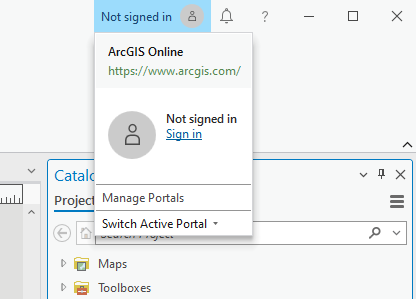

At any given point in time there is one Active Portal (or none if there are no portals specified). Usually, the active portal is connected but it does not have to be, especially if the logged on user has chosen (through the UI) not to cache his or her credentials between sessions. Refer to Sign in to your organization and Manage portal connections from ArcGIS Pro for more information on how to interact with ArcGIS Online and Portal via the Pro UI.
Note: You can be connected to many portals during a session but only one portal can be "the" active portal. The active portal drives the Pro catalog content, base maps, and so forth. The active portal is shown on the SignOnControl pulldown accessible on the top right of the Pro application ribbon bar.
portal_signon
To access the Active Portal, invoke the ArcGISPortalManager.Current.GetActivePortal() method. This will return an ArcGISPortal instance for the active portal which you can then manipulate to sign in, sign out, retrieve content, etc.
