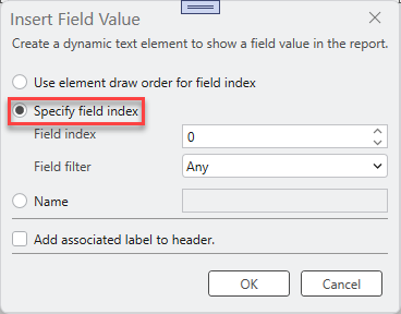

InsertFields
When the "Specify Field Index" option is used to add a field and field name labels, you can specify the field and field name labels using the database index. The index is zero based. The following table describes the filter options:
Filter type Description
Any All fields are included in the field. This is the default. Using this filter type and a field index value of 5 means use the sixth field in the table.
Text Only text fields are indexed. Using this filter type and a field index value of 3 means use the fourth text field.
Numeric Only numeric fields are indexed. Using this filter type and a field index value of 4 means use the fifth numeric field.
Date Only date fields are indexed. Using this filter type and a field index value of 2 means use the third date field.

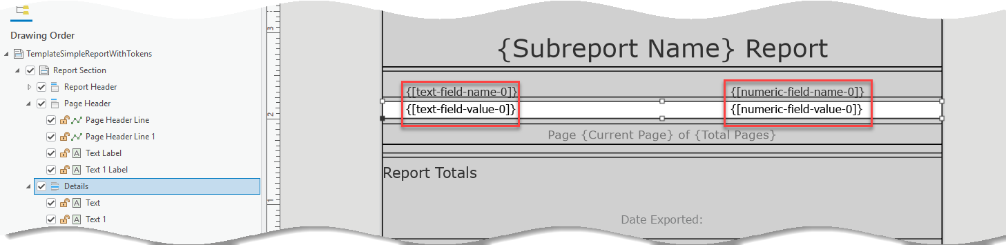

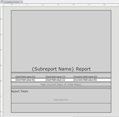

ArcGIS Pro creates dynamic text elements for these field and field name labels with tokens as place holders to reference the databases fields requested. The token is a string that defines the field and field name labels in the custom report template. For example, if a field and its title in the custom report template is set to use the "first text field" the token for the field and field title will be [text-field-value-0] and [text-field-name-0] respectively. Similarly, the first numeric field and field title will be [numeric-field-value-0] and [numeric-field-name-0] respectively.
Here is an image of a custom report template that defines two fields and their respective field titles. This template has been created to use the first text field and its title and the first numeric field and its title to generate a report. Notice the tokens used to define the fields and field titles in the custom report template image. These tokens are defined using the "Specify Field Index" option as described above.
ReportTemplateWithTokens
Refer to these tables below for the token naming conventions for fields and field headers:

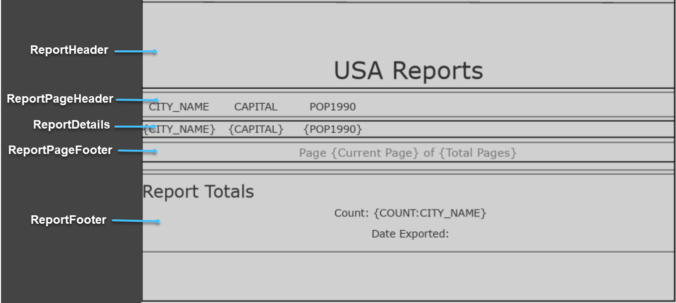

The ReportSection contains a collection of child sections including:
These five sections are available in the ReportSection by default. The ReportDetails section is where the attribute contents will be displayed.
UnGroupedReport

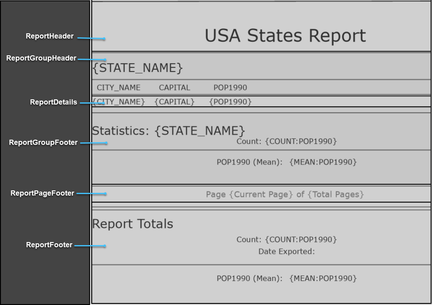

If the report is grouped on an attribute, the following two sections also exist in the report:
GroupedReport
Summary statistics for a report are added to either the ReportFooter or the ReportGroupFooter sections. See Sorting and Grouping data for how to group fields in a report and Summary Statistics for how to apply summary statistics.
