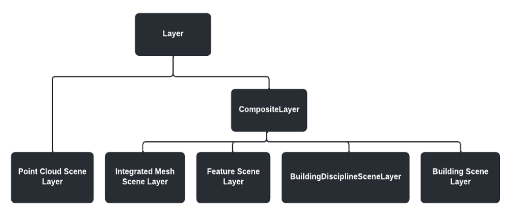

Pro scene layer model objects derive either directly from Layer (PointCloudSceneLayer) or, more commonly, from CompositeLayer. Their individual characteristics and capabilities can vary greatly depending on the underlying I3S layer type upon which they are based.
Given the heterogeneous nature of scene layers and the single inheritance hierarchy model of .NET, the Pro API uses an interface ISceneLayerInfo (ISceneLayerInfo) rather than a common base class to identify the methods and properties common across all scene layer model types.

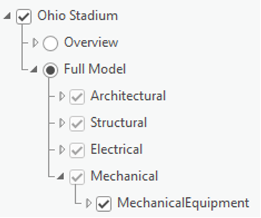

The BuildingSceneLayer can be considered as the entire building whereas the BuildingDisciplineSceneLayer are sublayers (of the BuildingScenelayer) representing each of the individual disciplines (architectural, structural, MEP, etc) that are contained within the building. The layer-sublayer hierarchy of a typical BuildingSceneLayer is shown below:
Notice the two sublayers "Overview" and "Full Model" contained within the BuildingSceneLayer. For display performance optimization, the BuildingSceneLayer contains a FeatureSceneLayer sublayer called "Overview" which renders the building exterior shell. The individual disciplines that provide the details of the building are contained within a BuildingDisciplineSceneLayer sublayer called "Full Model". When the "Full Model" layer is expanded in the TOC, it reveals child BuildingDisciplineSceneLayers for each of the disciplines that were extracted from the source revit data file.
In this example, the BuildingDisciplineSceneLayers for a BuildingSceneLayer are enumerated. Notice that BuildingDisciplineSceneLayers are, themselves, Composite layers that can contain both child discipline layers and FeatureSceneLayers that are used to render their contents:

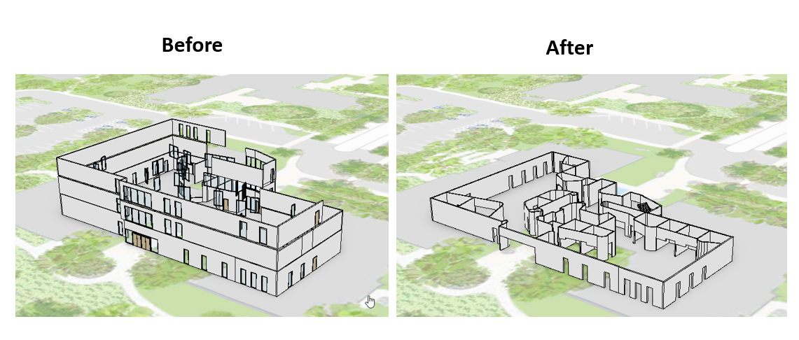

The display of the Full Model disciplines can be further refined via the use of filters. Filters are the topic of the next section.
Filters
Building scene layers allow you to isolate different aspects of its category layers through the concept of filters. A filter queries the underlying information to filter out all but the specified characteristics of the 3D building model (e.g. particular floors, rooms, etc structures across all category layers). Filter queries can use any field as filter type that is defined for all category layers. Using filters allows different aspects of a building's composition, properties, or location of structures to be displayed in a Pro scene view. A BuildingSceneLayer can have many filters defined but only one filter is active and can be accessed via BuildingSceneLayer.GetActiveFilter(). Each filter consists of up to two filter definition blocks. A block can either be a solid filter block or a wire frame filter block. The type of filter block dictates whether the features selected will be drawn as "solids" or as wire frames. The filter block type can be accessed via the FilterBlockDefinition.FilterBlockMode property which returns an enum of type Object3DRenderingMode.None for solid or Object3DRenderingMode.Wireframe for mesh. The active filter can be set by constructing a filter definition with the desired blocks, adding it to the collection of filters for the given BuildingSceneLayer and applying it via BuildingSceneLayer.SetActiveFilter(filterID). This is illustrated in the following example:

The following shows the result of the filter applied:

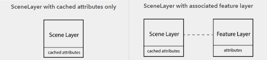

When a scene layer is created, its attributes are added to an internal cache. Cached attributes are used by scene layers to support popups, renderers, filters, and query definitions. However, when a web scene layer is published as a scene layer with an associated feature layer, the scene layer gets access to not just the cached attributes but to the attributes (stored in the feature dataset) for search and select.
Access to the feature dataset attributes in the geodatabase is enabled via an underlying feature service that is created on the feature dataset when it is published. The feature service is associated with the feature scene layer. When an associated feature service is present on the feature scene layer, the scene layer can support complex attribute and spatial queries via Search and Select API methods - both of which can be used to access row cursors to iterate over selected feature rows. Editing is also supported by the associated feature service assuming that editing was enabled when the web layer was published (via the web scene layer publishing pane "Configuration" tab).
Scene layer with cached attributes onlyScene layer with associated feature layer

HasAssociatedFeatureService
The presence of an associated feature service can be checked using the featureSceneLayer.HasAssociatedFeatureService property. If the property returns true then an associated feature service is present and Search, Select, and Editing (if enabled) are supported. The following table lists the capabilities provided by a feature scene layer with and without the associated feature service:
CapabilityWith feature serviceWithout feature service
Definition queriessupportedsupported
Field definitionssupportedsupported
Renderersupportedsupported
Select*supported
Searchsupported
Editing**supported
*Selection via mapView.SelectFeaturesEx and mapView.GetFeaturesEx (which uses a geometry) is always possible whether there is an associated feature service or not. The list of object ids within the SelectionSet are returned from the scene layer cache.
**Assumes editing is enabled on the associated feature service.
Note: Attempting to execute Search or Select on a scene layer when HasAssociatedFeatureService=false will throw a System.InvalidOperationException exception. In the following examples, a selection is illustrated first using the Mapview and SelectFeaturesEx() and/or GetFeaturesEx(). HasAssociatedFeatureService is irrelevant in this case. Second, the same selection is executed but this time using Select() and/or Search(). In this case HasAssociatedFeatureService==true is required otherwise a System.InvalidOperation exception will ensue. Notice that after the selection, fully populated features can be retrieved from the row cursor same as from any feature class or feature layer.
