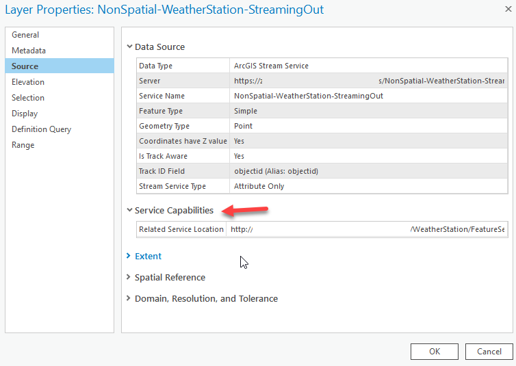

Service Capabilities
Service capabilities refers to the presence of:
  • An "archive" feature service used to record the latest observations (on the server).
  • A "related" feature service used to capture the spatial location of stationary events and/or static or non-changing event attributes such as vehicle make, manufacturer, plane type, passenger capacity, and so on.
Consult stream service json response keepLatestArchive and relatedFeatures properties.
Stream layers with an associated feature service (archive and/or related) will automatically display event locations when a connection is established. Stream layers without a service capability will only display events when they are received via a broadcast from the stream service. This can be a little disconcerting in cases where the stream service velocity is slow or infrequent. It is possible that streaming can be started but no data initially draws on the layer because no new events have been broadcast (since the connection was established) and so the layer remains "blank".
Although service capability does not affect the functionality of the stream layer, if add-ins wish to determine the service capabilities of a given stream layer they can interrogate the layer's RealtimeFeatureClass for its StreamServiceFeatureClassDefinition (derived from RealtimeFeatureClassDefinition) for an archive and/or related feature service url.

Service capabilities are also visible on the "Source" tab of the layer properties within the Pro UI.

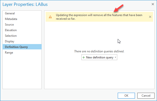

Definition queries (whether set on the layer or feature class) are applied on the connection to the stream service. If the stream layer is currently streaming its underlying connection is closed and a new connection is established with the query string from the definition query applied. In other words, if a layer or feature class is streaming when the query is applied, streaming is automatically stopped and restarted. When streaming is (re)started all previously retrieved observations are always automatically deleted from the feature class (see Start Streaming). Therefore, applying a definition query to a streaming layer (or feature class) truncates all existing rows. This is why, in the UI, the definition query tab shows a warning to the user if the layer is streaming.
If a definition query is applied to the feature class, via realTimeFC.SetFilterWhereClause(query), the query is not persisted in the layer and is not reflected in the layer UI (same as changing any setting on the feature class). Assuming the feature class was retrieved via a GetFeatureClass() call off a stream layer, and a query applied: when the Pro project is closed and reopened, the layer connection will be reestablished either with the layer's definition query, if it had one (persisted in the project) or with no definition query. It will not be reestablished with the query that was set on its feature class.
Stream layer and Realtime feature class definition queries follow the same rules as do GeoEvent Server attribute filters. For a list of the supported operators consult the GeoEvent Server attribute filter documentation.
