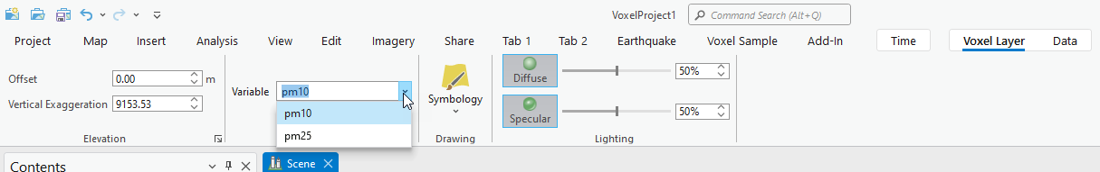

Voxel Layer Appearance
On the Pro UI, when a voxel layer is selected in the TOC, the "Voxel Layer" tab group is activated which includes an "Appearance" tab. The appearance tab provides a number of different options to configure vertical offset, vertical exaggeration, and various lighting options. These same properties are likewise accessible via the api and are described in this section.
(Refer to Change the appearance of a voxel layer for use of these settings from the Pro UI.)

Variable Profile
Voxels, beyond their dimensions and location, can have both quantitative and/or qualitative data values associated with them, referred to as "variables" or "variable profiles". The active variable is known as the selected variable profile and is shown as the currently selected variable in the variable profile combo box on the appearance tab. When a voxel layer is created, its default variable profile is automatically selected (which can be customized). The selected variable is accessible off the layer via the voxelLayer.SelectedVariableProfile property. Voxel variables are detailed in the Variable Profile section.
