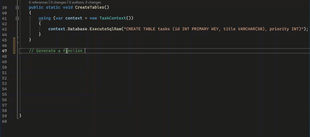

  1. Code completion while coding

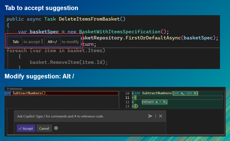

    GitHub Copilot provides auto-complete style suggestions for entire lines or blocks of code in real-time. Copilot draws the context for its suggestions from already existing source code and comments or from code and comments that you are typing in your source file. Suggestions can be entire lines of source code or even complete code blocks or functions. Suggestions are also provided for code comments. Copilot's suggestions can be accepted or rejected:
    • Accept the suggestion by pressing Tab or Enter.
    • Reject the suggestion by continuing to type or pressing Esc.
    • Type "Alt + /" to modify
    Code Completion: CodeCompletion1.gif

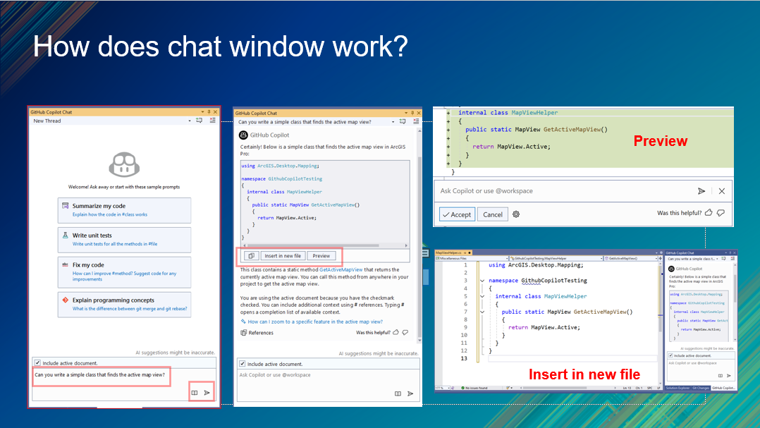

  2. Interactive Chat with Copilot
    GitHub Copilot also offers a chat interface from within Visual Studio, allowing you to ask in natural language coding-related questions, debug issues, or get explanations. Copilot chat can be invoked in two places:
    • Chat window accessed from the View menu of the Visual Studio IDE
    • In-line chat accessed from right inside the code editor by typing Alt + /
    In the Copilot Chat window, type your question into the Ask Copilot text box. Press Enter or select Send to ask Copilot. If Copilot Chat offers a code suggestion you want to use, select Copy code block to copy the code suggestion, Insert in new files to insert the code suggestion in a new file, or select Preview to insert the code suggestion in your current code file. Using the Preview button lets you preview the code in the target location so you can easily see what's being updated.
    If you select Preview, you'll see the code suggestions in normal Visual Studio "diff view pattern. You can review and refine what is being proposed and apply the suggestion to your code by selecting Accept or discard by selecting Cancel. If you select Insert in new file, you'll see the code suggestions in a new file. The file is not saved by default.

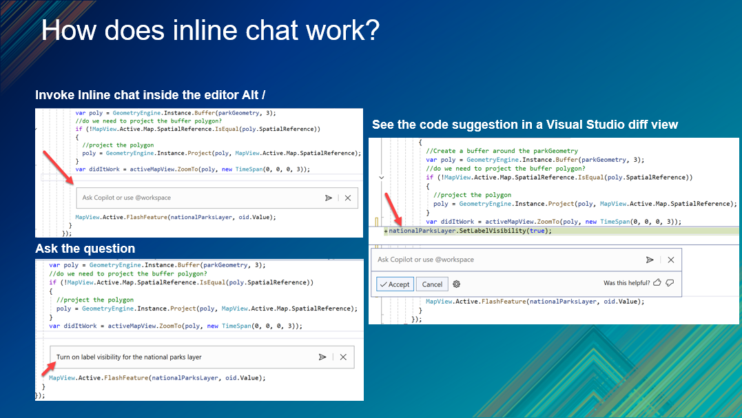

    In-line chat can be invoked by typing "Alt + /" in the code editor. This opens a chat interface right inside the code editor, allowing you to ask questions or request code suggestions without leaving your current context. This is particularly useful for quick queries or when you need immediate assistance while coding. The response will be displayed right in the code editor, making it easy to integrate suggestions into your code. You will be given the option to accept the suggestion and insert it into your code.
    Copilot chat provides a guided experience to help you ask better questions. It offers suggestions and prompts to refine your queries, making it easier to get the information you need. For example, if you ask a vague question, Copilot might suggest clarifying your request or provide examples of how to structure your question.

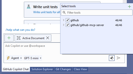

Tuning Copilot with MCP Server
The GitHub MCP (Model Context Protocol) server enables seamless integration of AI capabilities with GitHub. Connecting your development machine to a GitHub MCP server enables Copilot to access repositories on GitHub such as the Esri/arcgis-pro-sdk-community-samples repository. This can significantly enhance the relevance and quality of Copilot's suggestions, especially when working on ArcGIS Pro Add-in development. By using an MCP server, Copilot can leverage the specific code patterns, libraries, and best practices found in ArcGIS Pro SDK authoritative repositories to provide more accurate and context-aware suggestions.

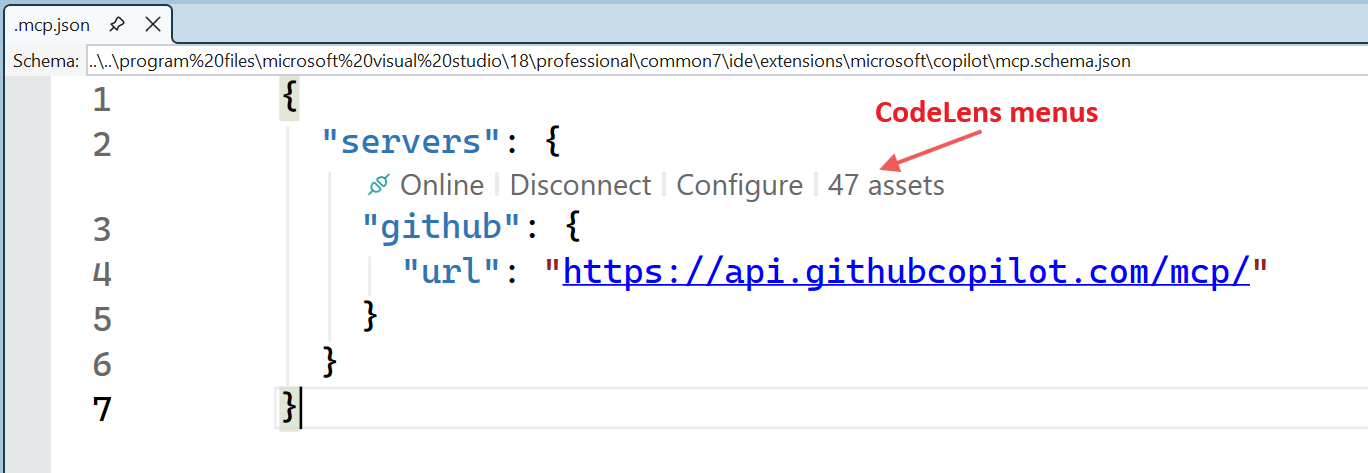

To configure GitHub MCP server for Visual Studio on your machine, perform the following setup instructions. Note that this requires Visual Studio 2022 version 17.14.9 or later. Also note that the remote GitHub MCP server is hosted by GitHub and provides automatic updates with no local setup required.
  1. Create a new file with the file name .mcp.json in your solution or %USERPROFILE% directory.
  2. Add this configuration to the newly create json file:
  "servers": {
    "github": {
      "url": "https://api.githubcopilot.com/mcp/"

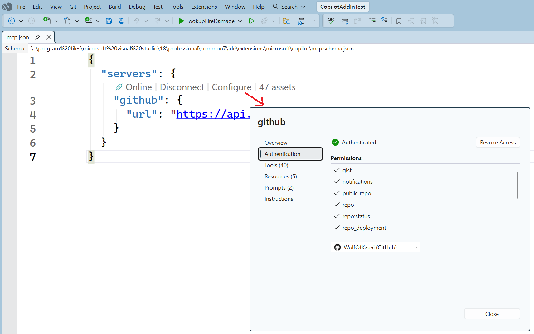

  1. Open Visual Studio and in Visual Studio open the '.mcp.json' file you created in step 1. Immediately open the json file in Visual Studio 2022 or 2026. You should now (if enabled) see the Visual Studio CodeLens control display the configuration options for the MCP server as shown here: MCP Server Configuration step 1 First you have to Authenticate the MCP server using your GitHub account that has an active Copilot subscription. Click on the 'Sign in to GitHub' link to authenticate. Next you 'Configure' the MCP server to use the 'github/github-mcp-server' repository as shown here: MCP Server Configuration step 2
  2. Restart Visual Studio to ensure that the MCP server configuration changes take effect.

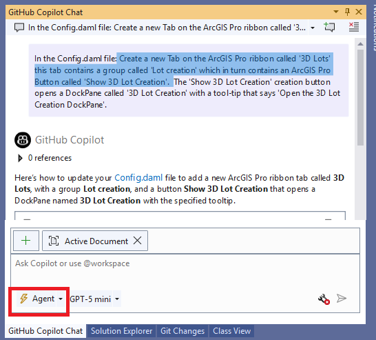

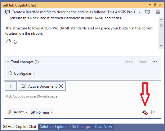

  3. In the GitHub Copilot Chat window in Visual Studio, switch to Agent mode. AgentMode.png

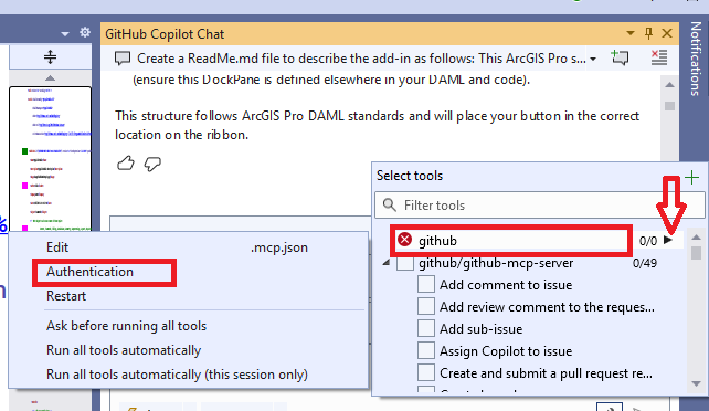

  4. Authenticate 'github' and 'github/github-mcp-server' using the settings button in the Copilot Chat prompt as shown here. Also make sure that your check-boxes for both items are checked. Authentication1.png Authentication2.png Authentication3.png

  1. Create/add a custom instructions file .github/copilot-instructions.md in the root folder of the GitHub repository you are working on.
  2. Enable the feature in Visual Studio via Tools > Options > GitHub > Copilot > check this 'Copilot Chat' option: Enable custom instructions to be loaded from .github/copilot-instructions.md files and added to requests.
You can ask Copilot for the references it is using and .github/copilot-instructions.md will be listed as a reference. Also a Chat query response usually includes all references used as well.
Here is an example of a custom instructions file that specifies that you are a Pro SDK developer and want to use the Pro SDK snippets as a reference. Please note that these instructions can probably be improved upon with newer releases of Copilot:

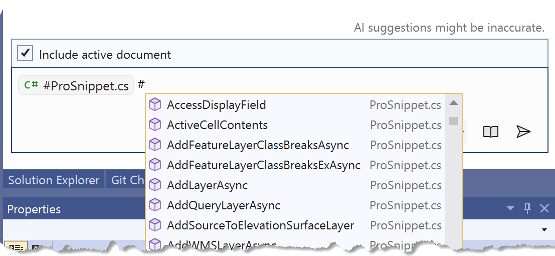

Scope the chat to your context using references
When asking questions in Copilot chat, Copilot is using any context provided in copilot-instructions.md (see Tuning Copilot with custom instructions), but you can also provide in-chat references to files or projects within your solution in order to change the context for Copilot to provide you with more relevant answers.
To easily reference a file in GitHub Copilot Chat, simply add a # symbol at the beginning of the file name. For example, if you want to set the scope to the MySnippets.cs file that is part of your solution, , you can refer to it in the chat session as #MySnippets.cs.
Similarly, you can reference methods, classes, or entire projects in your questions. For example, to access a function in ProSnippets.cs from the above example, you can ask "Can you explain the #CreateMapAsync function in #ProSnippets.cs?" to get a focused explanation.
using-references.png)
Refer to Reference: scope Copilot results to a particular file or entire solution on Microsoft's Learn site for a detailed explanation of how to use references in Copilot chat.

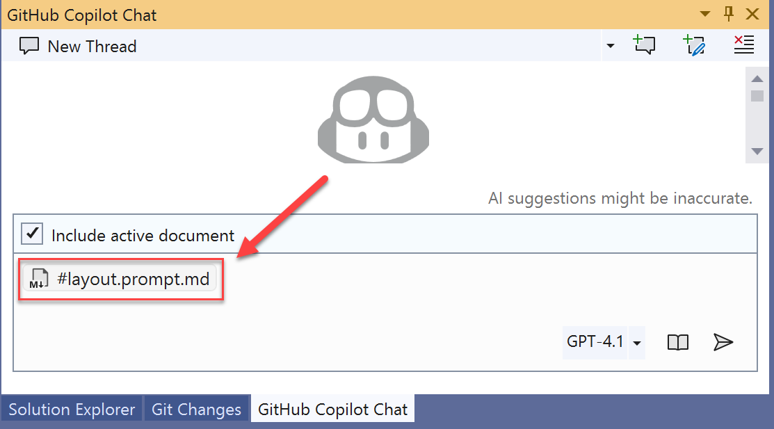

You can use reusable prompt files to run or share your frequently used prompts. Prompt files are text files that contain predefined questions or instructions that you want Copilot to consider when generating responses. This is particularly useful for complex coding tasks where you need to provide additional context or constraints.
To create a prompt file:
  1. Write your prompts as you normally would in the prompt box, using # references to include specific information from your solution, such as methods, classes, and files. You can even reference other prompt files for shared instructions.
  2. Copy the prompt into a markdown file, and save it with the .prompt.md extension in the .github/prompts folder at the root of your repository.
To use a prompt file:
  1. Type #prompt: in chat input to reference any prompt files from your .github/prompts folder, or click the ➕ icon in the chat input to add it as context.
  2. Add any extra details, or simply enter the prompt as is.
prompt-file-reference.png)
