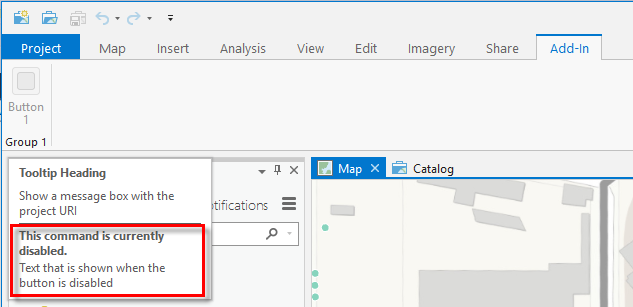

Show custom text on a tooltip when the button is disabled
In addition to controlling the enabled state of a button, you can also add a custom message on the tooltip to explain why the button is disabled. This is achieved using the disabledText attribute of the button's tooltip.
<controls>
  <!-- add your controls here -->
   <button id="ProAppModule_Button1" caption="Button 1" className="Button1" loadOnClick="true"
        smallImage="GenericButtonBlue16" largeImage="GenericButtonBlue32">
          <tooltip heading="Tooltip Heading">Show a message box with the project URI
          <disabledText>Text that is shown when the button is disabled</disabledText></tooltip>
   </button>
</controls>
Disabled tooltip
