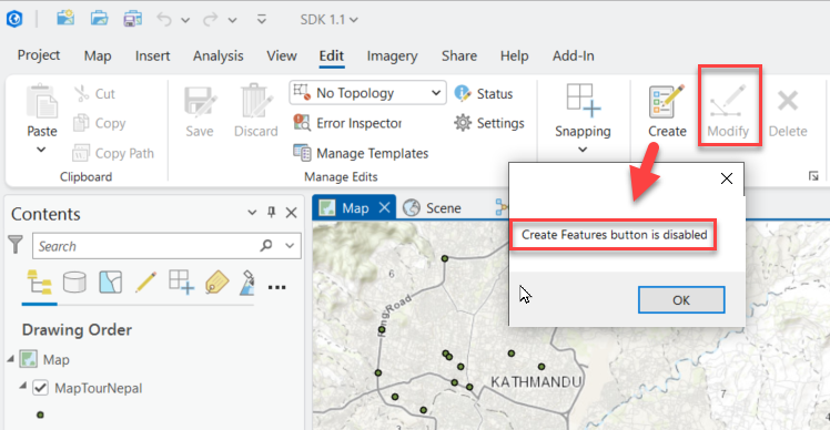

Compile and run the add-in. Test the logic by clicking on the "Create Features" button. You should see a message box indicating that the button is disabled. On the UI, the "Modify Features" button should be disabled.
