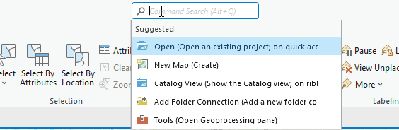

In ArcGIS Pro 2.8, the CommandSearch control was added to the top of the Pro ribbon. This feature lets users quickly find and execute commands by typing keywords into the search edit box. When focus is initially shifted to within the CommandSearch control by clicking or tabbing into it, the user will see recently used commands and a composite list of suggested commands in a drop down. Any commands that are executed from the CommandSearch control will be added to a "Recently Used list" of commands. This list is persisted within the user.config file located under the user’s roaming profile.

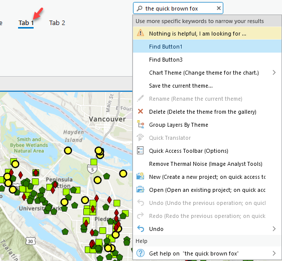

Let's try out the text search capabilities of Command Search.
With any tab activated, type in the phrase the quick brown fox. "Find Button 1" and "Find Button 3" should show in the list. Try "lazy dog". "Find Button 2" and "Find Button 4" should show in the list. The search is returning these results using the tooltip strings defined in your Config.daml.
Experiment with "Find" or "Find Button" to retrieve your commands based on their caption and so-on. Other Pro command content may also show in the list depending on the particular phrase you enter.
CommandSearch_QuickFox
