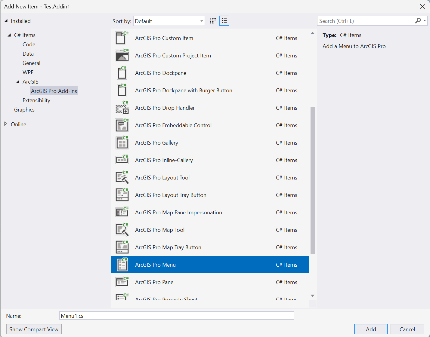

Step 2. Create a Menu
Create the map tool context menu. Use the ArcGIS Pro Menu item template. Add it to the "Menus" project folder. Name the menu "ToolContextMenu".
Menu Item Template

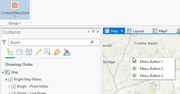

Compile and run your add-in in the debugger. Open any project in Pro. If you do not have any projects previously opened, create a new one using the "Map" template. On the "Add-in" tab, activate your tool. Right click anywhere on the map. Observe that your context menu, daml id "ContextMenu_Menus_ToolContextMenu", is shown.
Context Menu

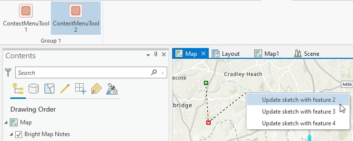

In the final scenario, the map tool intends to define its context menu item content on the fly by adding menu item options to its context menu programmatically. To add menu item content programmatically, the addin must use a "dynamic menu".
Dynamic menus can either be shown using the ContextMenuID map tool property (as described in Part 1.) or, more typically, with a custom right-click handler (as described in Part 2). The second scenario is described here.
Step 9. Dynamic Menu Workflow
The map tool will be using a line sketch geometry. The map tool will allow existing line features to have their feature geometry appended into the current active sketch. The procedure will be as follows:
  1. When the tool is activated, all line features intersecting the current map extent, from the first visible line feature layer in the TOC, will be retrieved and their object ids stored.
  2. When the tool is sketching and the user right-clicks, a dynamic context menu will show a menu item for each feature (line) retrieved when the tool was activated.
  3. The user can click on any menu item to append that feature's geometry to the existing sketch.
The map tool needs to define a dynamic menu with logic to retrieve the relevant feature geometries and append them (as needed) to the current sketch.

Second, in the right-click handler, in the map tool, add the following code to convert the right-click point to map coordinates and to retrieve the current sketch geometry. Note the method definition needs to change to become async override Task HandleMouseDownAsync.
  protected async override Task HandleMouseDownAsync(MapViewMouseButtonEventArgs e) {
    MapPoint clickedPoint = await QueuedTask.Run(() => {
      //This is the right-click location
      this.ClientPoint = e.ClientPoint;
      //Convert to map coordinates
      return MapView.Active.ClientToMap(this.ClientPoint);
    //retrieve the current sketch
    var sketch = await MapView.Active.GetCurrentSketchAsync();

Compile and run the code. Right click and select a menu item. The feature geometry associated with the clicked item will be appended to the sketch at the right-click location. Pan the map to show different content. Deactivate/reactivate the tool (click any other tool to deactivate) to refresh the retrieved line features. On the right click, notice how the list of menu items will be different when the menu is constructed using different line feature content (retrieved from the view).
Context Menu 2
If there are no line features visible in the map view when the tool is activated then a "No Features Found" menu item is displayed.
Refer to the MapToolWithDynamicMenu community sample for an example of a dynamic menu that is using a delegate on each dynamic menu item to handle a menu click rather than the OnClick override implemented in this guide.
