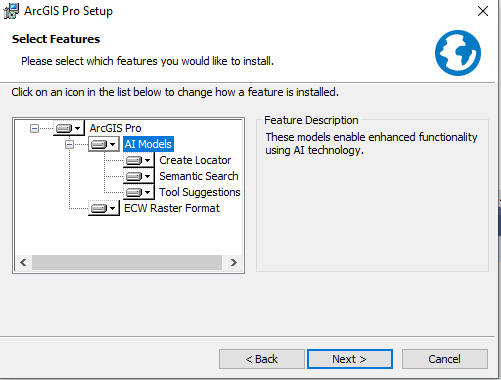

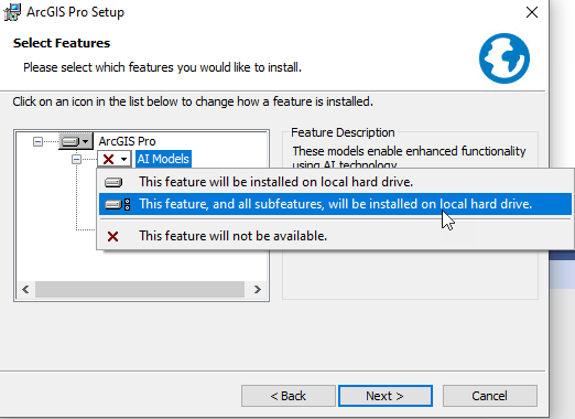

Ensure you have ArcGIS Pro 3.6 installed along with Pro Assistant ProAssistant.msi and the Pro SDK. When installing Pro, ensure that the optional install for AI models is enabled.

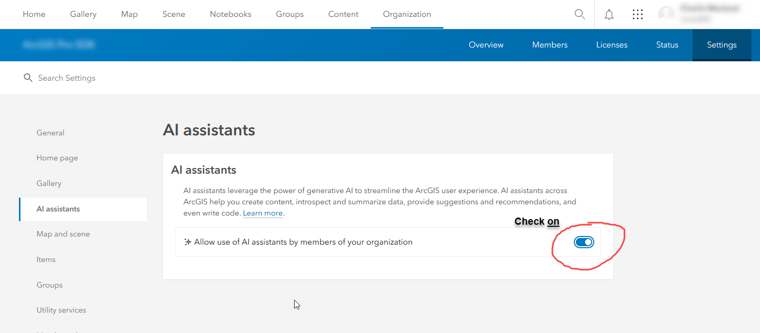

Online Administrator Settings
In your ArcGIS Organization, the following administrator settings must be enabled:

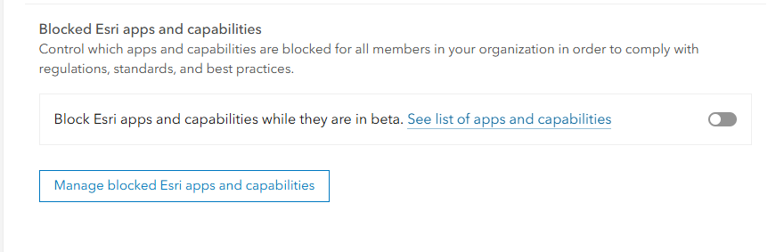

Also, ArcGIS Pro (Beta) must not be blocked on the security settings tab. The easiest way is to disable block of Esri apps.
However, if organization policy requires that Esri Beta apps be blocked, then use the "Manage blocked Esri apps and capabilities" button to add an exception for ArcGIS Pro.
Refer to Configure AI assistants and Blocked Esri apps for more information.

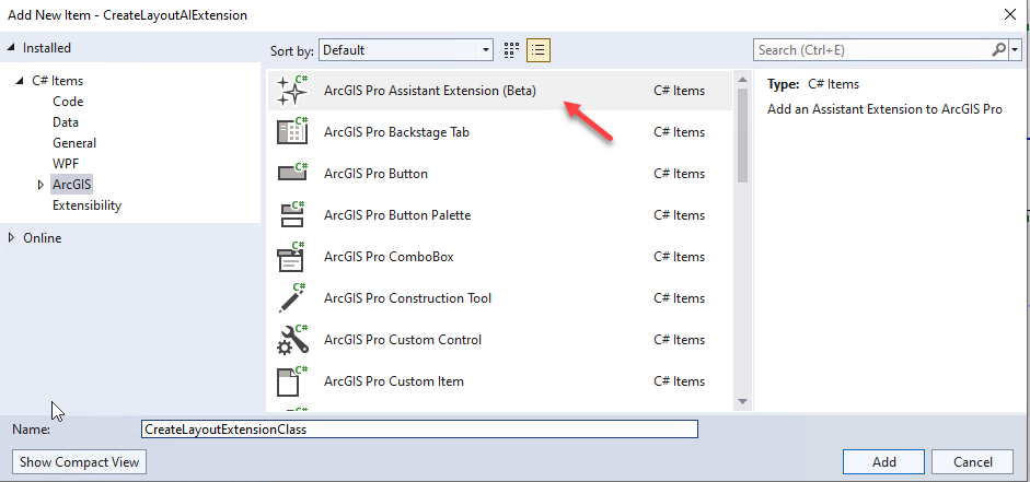

Step 2 Run the SDK Assistant Extension Item Template
From the right-click visual studio project context menu, select "Add->New Item...". Click on the (newly installed) "ArcGIS Pro Assistant Extension (Beta)" item template to create a new AI Assistant extension. Call your AI Assistant extension "CreateLayoutExtensionClass".

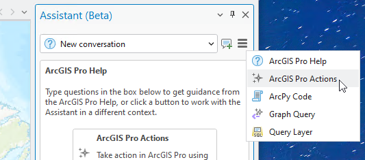

Step 11 Run the Pro Assistant
Start a "Pro Assistant action session". This will switch the Pro Assistant from executing Pro Help (the default) in response to your chat entries to executing Pro actions (as implemented by Pro assistant extension functions). You can initiate an action session either via the burger button "ArcGIS Pro Actions" option or by clicking the "ArcGIS Pro Actions - Take action in ArcGIS Pro..." button on the assistant dockpane.
Step 12 Invoke Your Extension via the Chat
Type into the chat "Create a layout using the current map". Hit enter. You should see a new layout pane generated (via your ai assistant function). Feel free to experiment with different phrasing and specifying a title string, or not.
