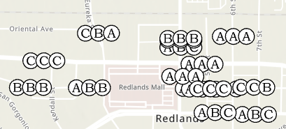

We are going to make a custom dictionary style that places three different symbols - a "letter" A, B, and C in one of three different placement positions: Left, Center, Right as shown below.
The style will work off three underlying feature attributes: one for the left letter choice, one for the middle letter choice and one for the right letter choice. Each letter choice must correspond to a distinct symbol in our dictionary style. There will be 9 symbols in our style to satisfy all possible 3x3x3=27 rendering options.
For example, to render a feature with AAA, will require: one A symbol offset to the left, another, distinct, A symbol for the middle, and a third, distinct, A symbol offset to the right and so on for other "letter" combinations.

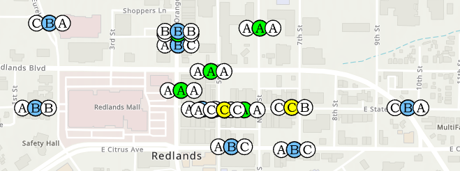

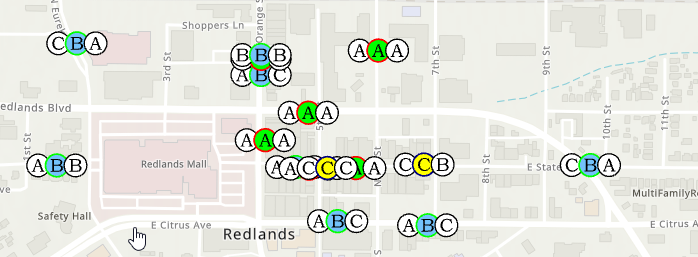

  2. Second, the procedure for making a style that uses primitive overrides to accomplish the same thing.
  3. Third (optional), we add a further override to change the symbol background color (in addition to the offset X).

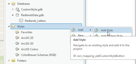

  • Add the Letters_with_offset.stylx style file to the Styles folder in Pro.

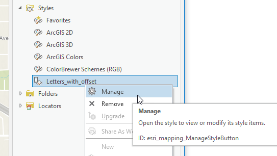

  • Right click on Letters_with_offset
  • Select "Manage". The Catalog pane will open. The Letters_with_offset style will be loaded showing all of its existing symbols (which are part of the original Runtime Restaurants style)
  • Select all of the symbols except the very last symbol (which is actually a label) called "Name label".
  • Delete all of the selected symbols (there is a "Delete" button on the Catalog tab or on the context menu).

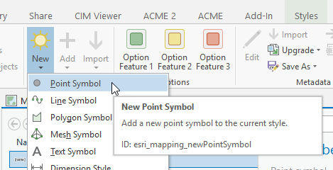

  • Add a new point symbol to the style (New->Point Symbol)

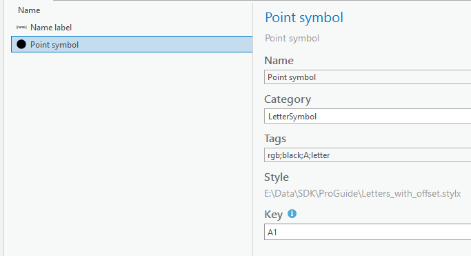

  • For Description, set the following metadata properties:
 Category: LetterSymbol
 Tags: rgb;black;A;letter
 Key: A1
  • Apply the changes.

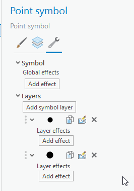

  • Click "Structure" (the "wrench icon" next to "Layers").

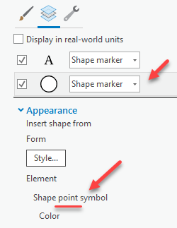

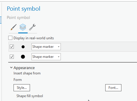

  • We are going to make a 2 layer symbol per letter. Add an additional marker layer (the symbol will now have two layers).
  • Switch back to symbol "Layers". Also notice that we (now) have two symbol layers.
  • Select the "top" layer. This will become our letter.

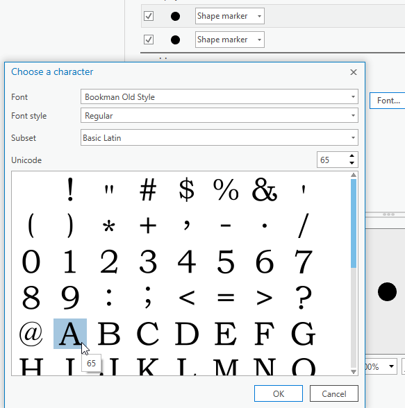

  • Click "Font...". Choose "Bookman Old Style" on the popup. Choose the letter "A". Click OK.
  • Change the Point size to 14pt.
  • Click Apply (on the bottom of the Properties tab).

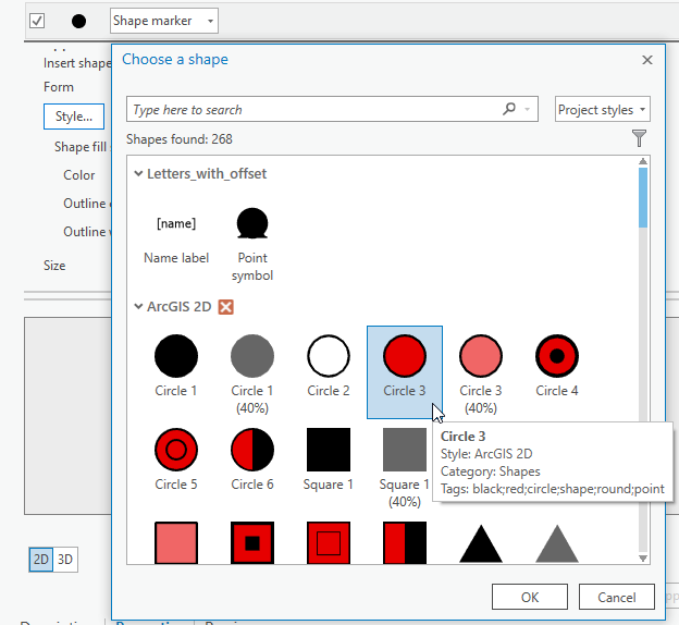

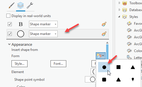

  • Select the second (ie "bottom" layer). Click "Style...". From the Popup, choose "Circle 3". Click OK.
  • Change the Point size to 18pt.
  • Change the Color (on the dropdown) to (Arctic) White. Click Apply.

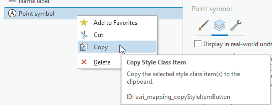

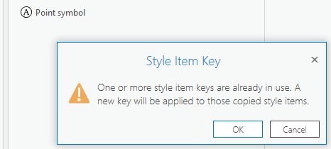

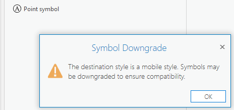

  • Right-click on the symbol, select "Copy". Click off the symbol (so it is not selected), right-click, select "Paste".
  • On paste, you will get the following warning message. Ignore it and click OK.
  • You will get a "Symbol Downgrade" message. Ignore it and click OK.
  • Repeat "Paste" until you have a total of 9 "A" symbols.

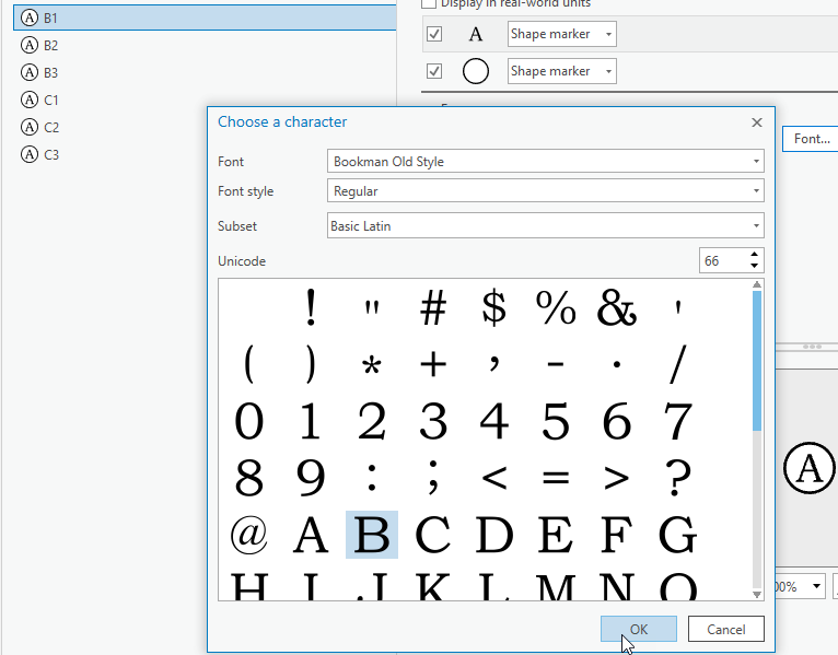

The three symbols designated as "B's" must now be changed to use the character "B" and likewise for the "C's".
  • Select each symbol in turn and return to the "Properties" tab. Select the top layer (which uses the font). Change the font character to "B" or "C" respectively. "Apply" the changes.

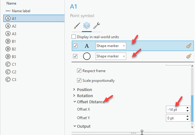

We are now going to add "Offset X" values to the symbols.
  • Select "A1". Go to properties.
  • Select "Layers".
  • Select each symbol layer in turn (there are two).
  • Expand "Offset Distance". Set the Offset X to -14pt (i.e. negative or "-" 14pt) (remember to repeat this for the other layer)
  • Click Apply.
  • Select the "A3" symbol
  • Set the Offset X to 14pt for both layers (i.e. positive or "+" 14pt).

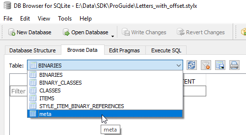

Run DB Browser (if you have not downloaded and installed the DB Browser for SQLite please do so now).
Open the Letters_with_offset.stylx style file. Use the "Open Database" button on the browser. Be sure to change the file filter to All Files (*). (The default filter is SQLite database files which will not show the .stylx files.)
  • Select the "meta" table
Refer to the dictionary tool kit, Understanding the dictionary topic for a detailed description of the meta table fields we will be editing.

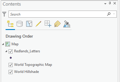

  • Create or open a project with a 2D map.
  • Add your Redlands_Letters dataset (created in Data Prep) to the TOC.

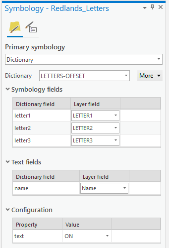

We are going to set the renderer of our layer to use our custom dictionary style.
  • Select the Redlands_Letters layer in the TOC
  • Open the symbology dockpane.

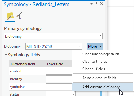

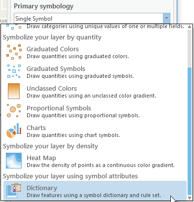

  • Change the Primary Symbology to be "Dictionary".
By default the MIL-STD-2525D symbol set will probably be selected. We need to change that to our custom style "LETTERS-OFFSET" but first we will have to add our style to the list of styles in the Dictionary combo.
  • Select "More"->"Add custom dictionary..."
  • Browse to the location of the "Letters_with_offset" style.
  • Click OK
The style will be added into the COMBO and should, by default, become selected. Otherwise just select "LETTERS-OFFSET" in the combo.
The letter1, letter2, and letter3 attributes in the feature dataset should automatically get mapped to the letter1,2, and 3 attributes defined in the custom style. If not, select them in the layer field combos.

Step 1
Make sure Letters_with_po.stylx is added to Catalog. Open the style using "Manage" (see previous Step 2). We will be adding "primitive names" to each of the symbols. Primitive names are arbitrary strings that are referenced in the Arcade script to "set" primitive overrides (note: you must have ArcGIS Pro 2.5 or better to edit primitive names on a symbol).

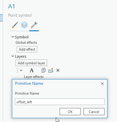

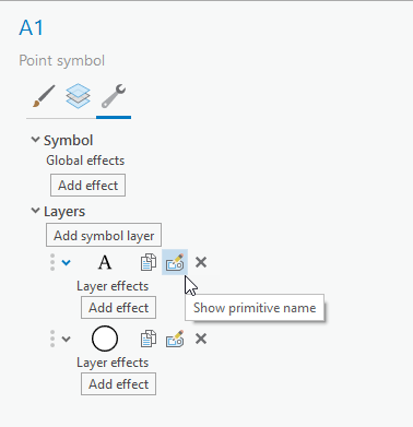

We will be adding a primitive_name for the left offset to A1, B1, and C1; a primitive name for the middle offset (for consistency - we don't actually use it) to A2, B2, and C2; and a primitive name for the right offset (to A3, B3, and C3).
  • Select A1.
  • Select the "Properties" view.
  • Switch to the "Structure" tab.
  • Click on the "show primitive name" icon (this is only available in Pro 2.5 or later) for the letter layer.
  • Enter "offset_left" in the popup.
  • Repeat for the "circle" layer.
  • Click Apply.
Repeat for all other symbols A2-C3. Use the table below to set the correct primitive name per symbol.
Symbol namePrimitive name
A1, B1, C1offset_left
A2, B2, C2offset_middle
A3, B3, C3offset_right
Note: If you do have an Offset X set for a given symbol be sure to set it back to 0.

  • Open the Letters_with_po.stylx in the DB Browser and open the style's meta table.
Make the following changes:
  • Change dictionary_name to "LETTERS-PO".
  • Change the dictionary_configuration value. Change the "symbol": json definition to: "symbol": ["letter1", "letter2", "letter3"], (see step 13)
  • Click Apply.

Part 3 - Optional - Modify Symbol Color via Primitive Override
Let's look at one final modification. We will use a primitive override to change the "middle" symbols' background color (A2, B2, and C3). We are going to change A2 to be green, B2 to be (baby) blue, and C2 to be yellow.
For the color primitive override to work we will have to change the structure of our symbols slightly to use a polygon fill (not a point symbol as currently) for the letter background.
We need to change the "Circle" shape maker symbol layer in each of the three "middle" symbols from this:
To this:
Note the change from "point symbol" to "fill symbol"

  • Open the Catalog view (i.e. "Manage")
  • Select A2.
  • Select "Properties". Select the "Layers" tab.
  • Select the "Circle" shape marker symbol layer.
  • Select the "Circle" shape from the "Form" combo
This will change the layer to use a "Shape fill symbol" which is what we want.
To replicate the look of the original symbol which used a point marker we need to tweak the size and outline.
  • Change the size to 17pt and the Outline width to 0.75pt and Apply the changes.

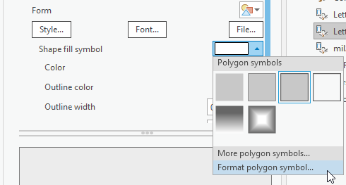

Step 2

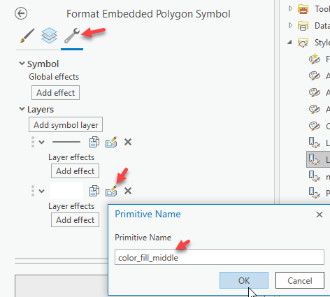

Next, we need to set the primitive name that we will use in the override (for the color). However, we need to set the primitive name _on the "embedded" polygon symbol_ used for the fill color and not on the "parent" shape marker layer (as we did for the x offsets).
  • Select the "Format polygon symbol..." menu option from within the "Shape fill symbol" combo (on the "Circle" shape marker symbol layer)
This will show the "Layers" for the embedded polygon symbol.
  • Select the "Structure" tab.
  • Add the primitive name "color_fill_middle" to the fill layer (to manipulate the outline, tag the outline with "color_outline_middle" or any name of your choice).
  • Click Apply to apply your changes.
  • Repeat for symbols B2 and C2.

Click "Apply" and "Write Changes"
Step 4
Open Pro. Your "Redlands_Letters" layer that is using the "LETTERS-PO" dictionary style should now be rendering the middle symbol with its associated background color. Debug your style and Arcade script as needed.
...and with the symbol outline code uncommented:
