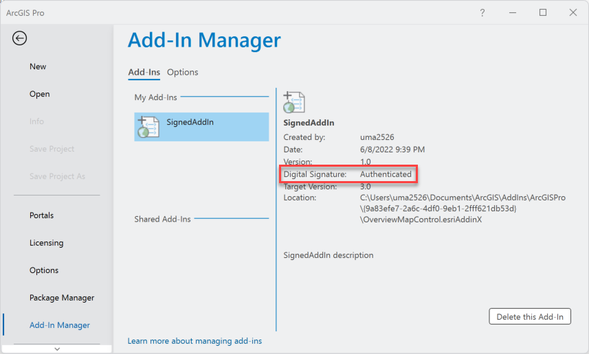

The Add-In Manager dialog box—accessible from ArcGIS Pro, by clicking Project > Add-In Manager—displays a list of all the add-in files currently installed on the user’s machine (configurations and plug-ins are not shown).
Along with other add-in file information, the digital signature status displays in the area indicated in the following screen capture:
Add-in-manager
The signature status is determined as shown in the following table and applies to all add-ins, configuration, and plug-ins equally:
Status Description
None The selected addin file does not contain any digital signatures.
Un-trusted The digital signature applied to the addin file is not from a trusted source.
Invalid The digital signature has been invalidated due to manipulation of the addin file contents, or the certificate has expired.
Authenticated The file is digitally signed with a signature that is valid and from a trusted source.

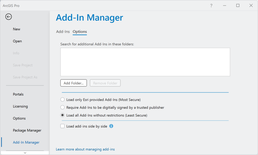

On the Options tab of the Add-In Manager dialog box, users can view and change options concerning how add-in file security is handled. The options, ranging from most secure to least secure, are as follows:
  • Load only Esri provided addins (most secure)
  • Require addins to be digitally signed by a trusted publisher
  • Load all addins without restrictions (least secure)
Users without administrator privileges cannot modify these settings in a way that makes the system less secure than the settings an administrator has already established on the machine. Options that are not available to non-administrators are disabled on this tab.

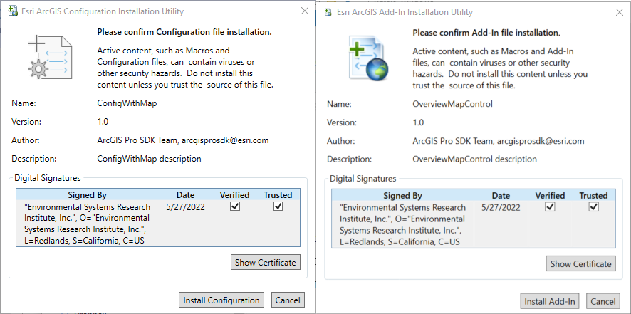

This dialog box displays pertinent add-in information, such as its name, date, author, version, and description. If the add-in file is digitally signed, signature information also displays in this dialog box. If any of the presented information is unsatisfactory, the installation process can be cancelled by the user and the add-in file will not be installed.
Add-in files can be signed with more than one digital signature, depending on the internal policies of the authoring organization. Within the digital signature area of the Esri ArcGIS Add-in Installation Utility dialog box, the signer, date stamp, and validity of the selected signature display with information on whether the associated certificate is from a trusted source. Detailed information on the selected signature’s certificate can be displayed by clicking the Show Certificate button.
A secure add-in file must have at least one digital signature that is valid and trusted. An invalid signature indicates that the contents of the file have been modified in some way since the signature was applied.

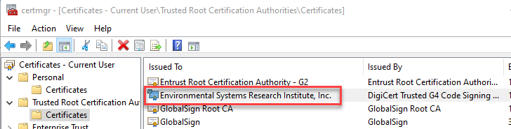

  • Windows Certificate Stores. Windows stores certificates locally on the computer in a storage location called the certificate store. A certificate store often has numerous certificates, possibly issued from a number of different certification authorities (CAs).
    • Starting on June 1, 2023, a digital certificate issued by a Commercial Certification Authority (such as DigiCert, Thawte, or Geotrust) will be stored on a Hardware Security Module, HSM or cloud HSM, certified as FIPS 140 Level 2, Common Criteria EAL 4+ compliant, or equivalent. Certificates are typically imported into the "Current user certificate store" from an HSM.

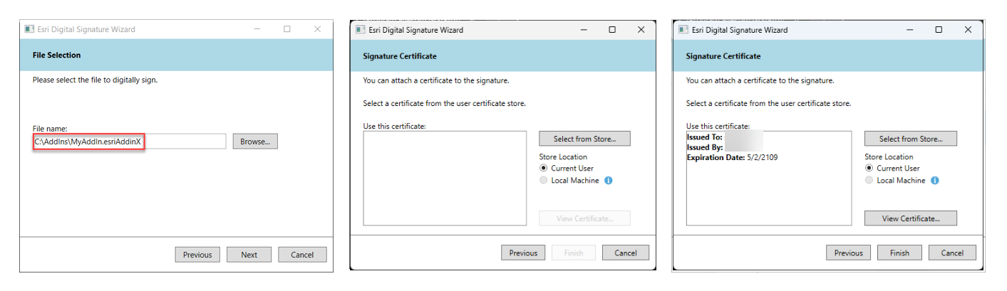

Double click the ArcGISSignAddIn.exe from the bin folder of your ArcGIS Pro installation location. This launches the wizard that will guide you through the process of code signing your add-in.
  • Select the .esriAddinX file that you want to sign. Click Next.

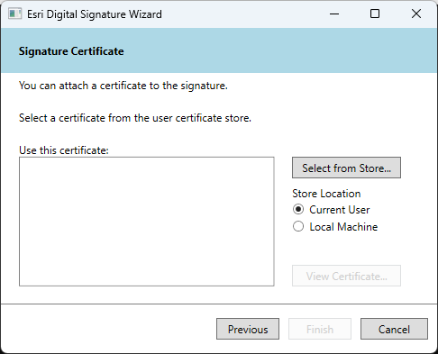

  • Pick the certificate you want to use from the Windows Certificate store*
  • You may be prompted for a password to complete the signing process (if a login credential has not been cached)
  • Click Finish.

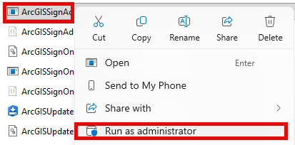

Note: Starting in ArcGIS Pro 3.6, when launched in the UI mode, ArcGISSignAddIn.exe allows you to access the digital certificates stored in the your local machine store if you run it as an administrator.
The UI mode of ArcGISSignAddIn.exe will display the digital certificates stored in the Current User store by default. If you have digital certificates stored in your local machine store, you must run the tool as an administrator to be able to switch store location to the Local Machine and use ArcGISSignAddIn.exe to sign your add-in with certificates in any of those stores.
UI when running as administrator:

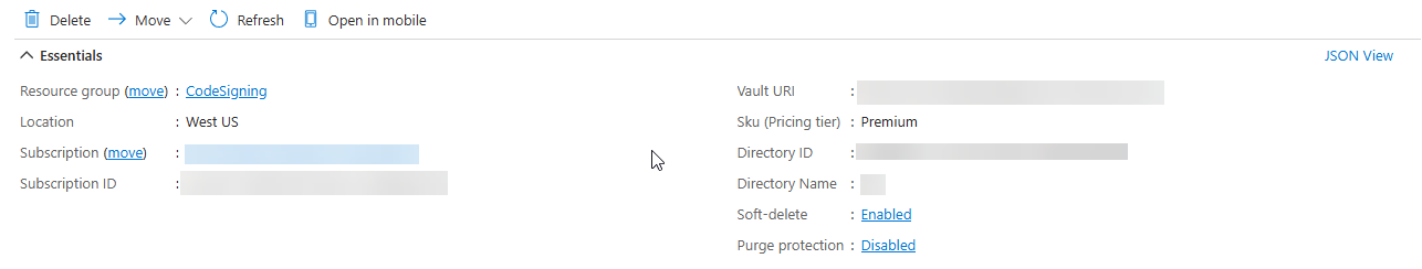

Here are example instructions on how to set up an Azure Key Vault to be used as certificate store for signing addins.
  • Log into Azure Portal as a user with sufficient rights to create resources and services (likely an Azure administrator).
  • Create a new resource of type Microsoft Key Vault:
    • Use the appropriate Azure subscription if you have access to more than one.
    • Use an existing resource group or create a new one (For Example: CodeSigning)
    • In the instance details section, provide:
      • a key vault name (For Example: CodeSigning)
      • a region that's relevant to you (For Example: West US)
      • a pricing tier - Premium is required for HSM backed keys
  • Choose the recovery options relevant to your use case or required by your organization.
  • Click Next to set the role-based access control (RBAC) in the Access Configuration page.
  • Click Next to configure the vault security.
  • Review and create the key vault. Screenshots to illustrate these steps are given below. AzureKeyVault.png Note: Refer to Get started with Key Vault certificates for detailed instructions for this process.

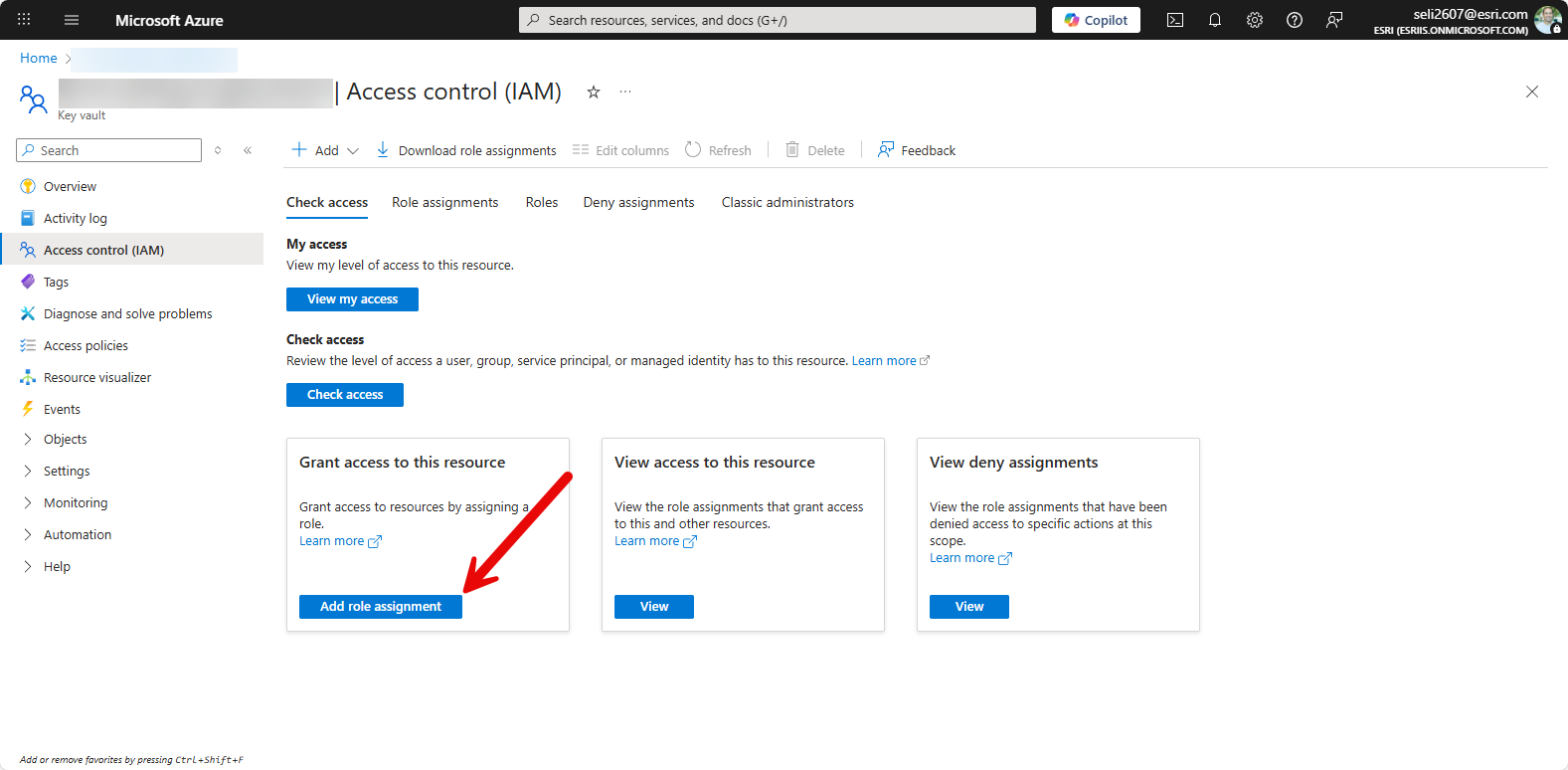

  • Grant access to the Key Vault so it can be used by the appropriate users. In the Key Vault configuration of the newly created key vault, open the Access control (IAM) and click on "Add role assignment": AzureKeyVault-IAM.png
    Add the relevant members to the Key Vault Certificate User role (assuming you're using the RBAC security model)

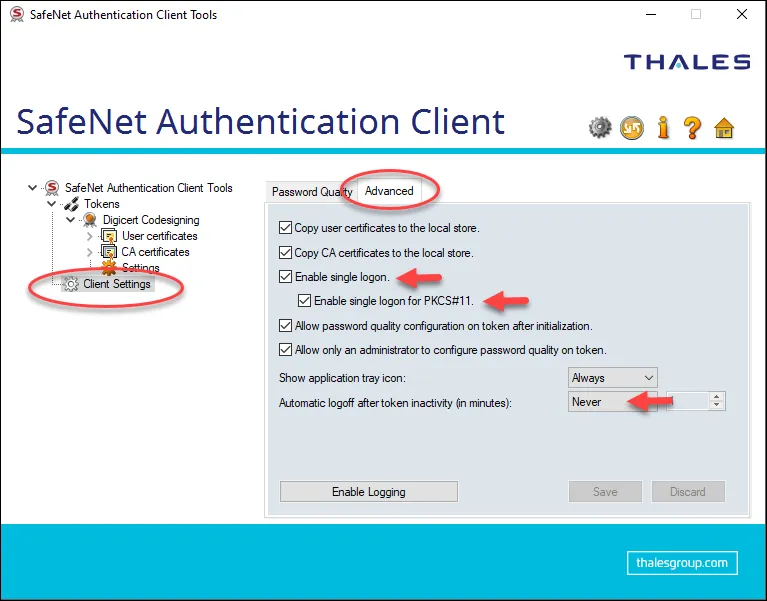

** Thales SafeNet Authentication Client
If your vendor does not directly support configuring your HSM for unattended access, you may be able to use the Thales SafeNet Authentication client software (please refer to their "Configure the USB dongle for unattended access" section).
On the SafeNet Authentication client software, go to Client Settings > Advanced tab. Check the “Enabled single logon” checkbox and “Enable single logon for PKCS#11” checkbox. Select “Never” in the “Automatic logoff after token inactivity (in minutes)” drop-down box.

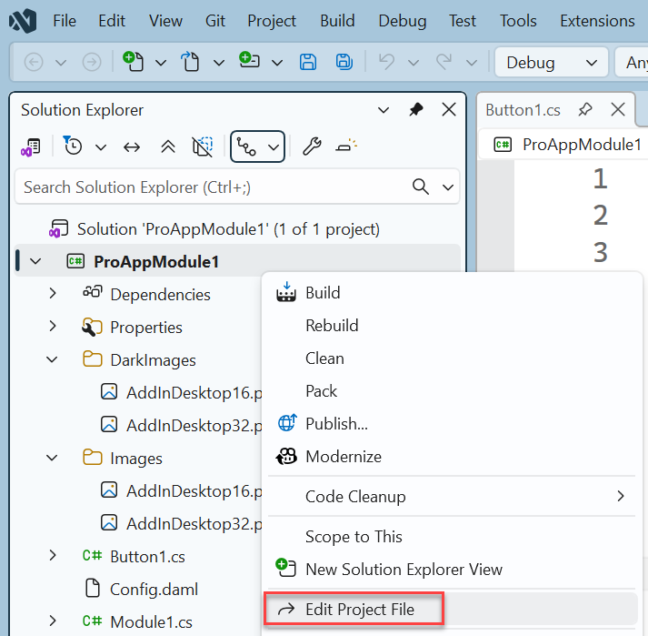

Step 1
Open your ArcGIS Pro add-in project in Visual Studio. Right-click the project context menu and choose Edit Project.
