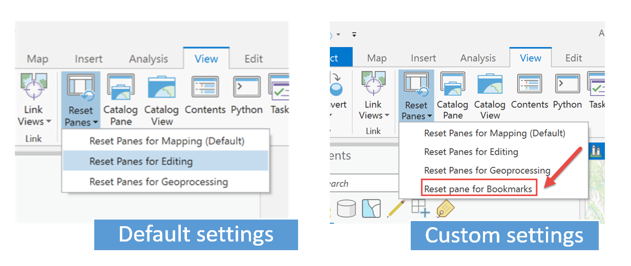

Reset Panes
After working in ArcGIS Pro for a long period of time, the application window can become crowded with a wide variety of panes. The Reset Panes command (View > Reset Panes) will reset the application panes to some predefined group. This new command provides a quick and easy way to close all of the open panes resetting the application to just a predefined group of panes. For example, "Reset Panes for Geoprocessing" closes all open panes, reopening only the Contents, Catalog, and Geoprocessing panes, with Geoprocessing brought to the foreground.
You can reset the Pro application to a predefined group of panes of your choice using DAML. The example DAML snippet below will add a "Reset Pane for Bookmarks" menu item in the "Reset Panes" drop down control on the View tab. When you click the "Reset Panes for Bookmark" menu items, all the currently open dockpanes in Pro will close and the "Manage Bookmarks" pane and the "Contents" pane will be opened. Add this snippet before the <modules> element.
<DockPaneSets>
 <insertDockPaneSet id="esri_DockPaneReset_bookmarks" caption="Reset Panes for Bookmarks">
    <DockPaneID refID="esri_mapping_showBookmarksWindow"/>
    <DockPaneID refID="esri_core_contentsDockPane"/>
 </insertDockPaneSet>
 </DockPaneSets>
In the screenshots below, the image on the left shows the default Reset Pane options available in ArcGIS Pro. The image on the right has a new "Reset Panes for Bookmark" option inserted in the Menu items using DAML customization.
ResetPaneComparisons

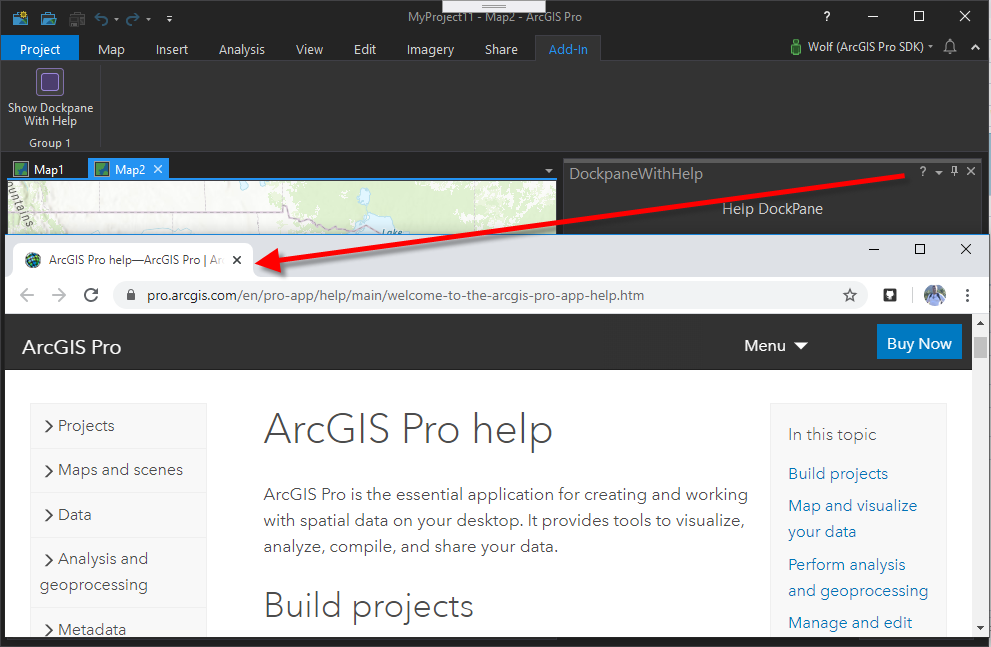

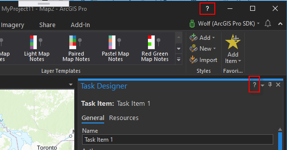

Enable contextual help for a dockpane
ArcGIS Pro provides a standard mechanism to enable contextual help on dockpanes and windows. In the screenshot below you can see two sample implementations of dockpane and window help.
ProHelpConcepts
You can implement help for your dockpane by adding the hasHelp="true" attribute to the dockPane tag in DAML and override the OnHelpRequested method of the base ArcGIS.Desktop.Framework.Controls.DockPane class.
Below the hasHelp attribute for the dockPane tag is set to "true":
<dockPanes>
  <dockPane id="DockpaneWithHelp_..." hasHelp="true"
            caption="..." className="..." dock="..." dockWith="...">
    <content className="DockpaneWithHelpView" />
  </dockPane>
</dockPanes>
Below is the code-behind implementation to override the OnHelpRequested method of the base ArcGIS.Desktop.Framework.Controls.DockPane class with our desired custom behavior that occurs when the help icon is clicked or the F1 key is pressed. In the sample below the help action simply spawns a browser showing the ArcGIS Pro help page.
internal class DockpaneWithHelpViewModel : DockPane
  private const string _dockPaneID = "DockpaneWithHelp_...";
  protected DockpaneWithHelpViewModel() { }
  /// <summary>
  /// Override the default behavior when the dockpane's help icon is clicked
  /// or the F1 key is pressed.
  /// </summary>
  protected override void OnHelpRequested()
      var startInfo = new System.Diagnostics.ProcessStartInfo(@"https://doc.esri.com/en/arcgis-pro/3.7/help/main");
      startInfo.UseShellExecute = true;
      System.Diagnostics.Process.Start(startInfo);
The help action is triggered when the operator clicks on the dockpane's help icon or the F1 key is pressed while the dockpane window is the active window.
