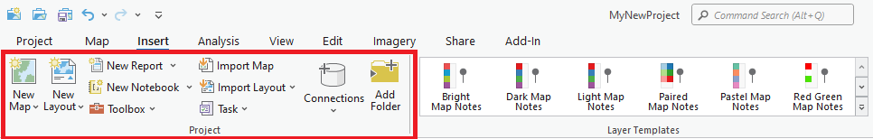

Groups
Groups are declared as lists of controls within a groups container element within the module DAML element :
<groups>
   <group id="esri_core_DockWindows" caption="Windows" condition="esri_core_MapPane">
      <button refID="esri_core_ShowProjectDockPane" size="large" />
   </group>
   <group id="esri_core_ProjectFile" caption="Project">
      <button refID="esri_core_OpenProjectButton" size="large" />
      <button refID="esri_core_NewProjectButton" size="middle"/>
      <button refID="esri_core_SaveProjectButton" size="middle"/>
      <button refID="esri_core_SaveProjectAsButton" size="middle" separator="true"/>
      <button refID="esri_core_CloseProjectButton" size="middle"/>
      <button refID="esri_core_ProjectSettingsButton" size="middle"/>
   </group>
   <group id="esri_core_ProjectImport" caption="Import">
      <button refID="esri_core_ImportMapButton" size="large" />
   </group>
   <group id="esri_core_ProjectNewItem" caption="New">
      <button refID="esri_core_NewMapButton" size="large" />
   </group>
</groups>
In the example above, four groups are declared. Note that the button elements refer to previously declared buttons. While the button image is supplied elsewhere in the button declaration, the size of the button is specified on the group. Note that the same button could appear in more than one group. Any control can be added to the group; label controls, checkboxes, editboxes, and so on. The separator attribute can be used to segregate multiple controls in the same group.

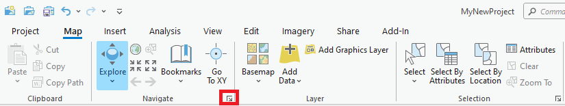

How to add a popup to a group
Groups may optionally support a “more” button—a small link widget located next to the group caption—that is used to show a dialog box where more obscure functions may be accessed. Use the launcherButtonID attribute on the group element to reference a button function.
<group id="esri_mapping_navigateGroup" caption="Navigate"
            launcherButtonID="esri_mapping_navigationOptionsButton"
            smallImage="pack://application:,,,/ArcGIS.Desktop.Resources;component/Images/3DNavigationTool16.png">
   <tool refID="esri_mapping_exploreSplitButton" size="large" />
   <button refID="esri_mapping_zoomFullButton" size="small" />
</group>
Group With Popup

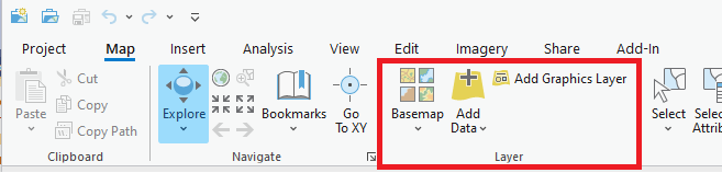

The Layer group on the Map tab is defined using multiple subGroups within the group.
Here is the group definition.
        <group id="esri_mapping_layerGroup" caption="Layer" smallImage="pack://application:,,,/ArcGIS.Desktop.Resources;component/Images/AddContent16.png" keytip="L">
          <subgroup refID="esri_mapping_firstLayerSubGroup"/>
          <subgroup refID="esri_mapping_secondLayerSubGroup"/>
        </group>
and the subGroup definitions.
        <subgroup id="esri_mapping_firstLayerSubGroup" >
          <gallery refID="esri_mapping_basemapGallery" inline="false" size="large" />
          <splitButton refID="esri_mapping_addDataSplitButton" />
        </subgroup>
        <subgroup id="esri_mapping_secondLayerSubGroup" size="MediumThenSmallWhenSmall">
          <button refID="esri_mapping_newGraphicsLayerButton" />
        </subgroup>
You can use the size attribute on the subGroups to manipulate the look and feel of the group.
Large
Medium
Small

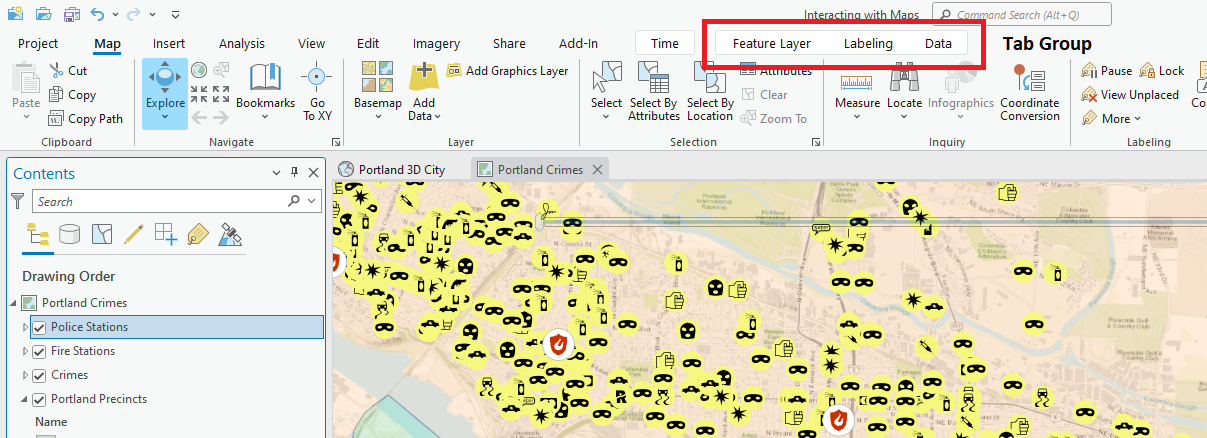

Tab groups
Collections of related tabs can be grouped together to improve clarity. These collections are called tab groups. In the ribbon displayed below, there is a tab group containing three tabs. Previously at 2x the tab groups supported a caption and a background color.
TabGroup
Tab groups are declared within a tabGroups collection element and consist of an ID. The Tabs are associated with a tab group using the tabGroupID attribute. The DAML below creates the tabs and tab group as displayed above.
<tabGroups>
   <tabGroup id="esri_mapping_featureLayerTabGroup">
   </tabGroup>
</tabGroups>

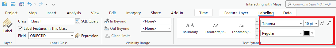

Toolbars
The ribbon group supports an inner collection and grouping of buttons into a toolbar. Toolbars are purely declarative and support multiple groups. The group definition describes what the toolbar looks like. Use the appropriate control element with a refID to specify the elements you want to appear in the toolbar. The example below shows a toolbar with several comboboxes and buttons.
Toolbar
<toolbars>
   <toolbar id="esri_mapping_labelTextSymbolFontToolbar">
     <group>
       <customControl refID="esri_mapping_labelClassFontControl"/>
       <comboBox refID="esri_mapping_labelTextSymbolFontSizeComboBox" size="small" />
       <button refID="esri_mapping_labelTextSymbolIncreaseSizeButton" size="small" />
       <button refID="esri_mapping_labelTextSymbolDecreaseSizeButton" size="small" />
     </group>
     <group>
       <comboBox refID="esri_mapping_labelTextSymbolFontStyleComboBox" />
       <customControl refID="esri_mapping_labelTextSymbolVariableFontSettings" size="small" />
       <customControl refID="esri_mapping_labelTextSymbolColorPicker" size="small" />
     </group>
   </toolbar>
</toolbars>
