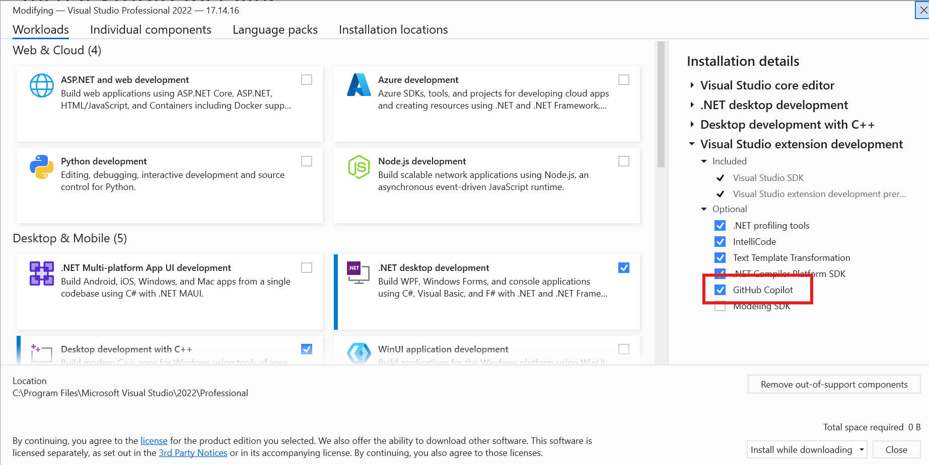

  • Visual Studio: GitHub Copilot provides an optional Visual Studio Extension for Visual Studio 2022 (Version 17.10 or later) that must be installed. lineCallOut
  • For Visual Studio 2026, Copilot is installed automatically.

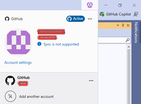

Step 2 Visual Studio GitHub Copilot Sign-in
  • In Visual Studio, sign in using your GitHub account with an active Copilot subscription. lineCallOut
  • Make your GitHub account the active account in Visual Studio.
  • If your GitHub account has an active Copilot subscription, you will be signed in to GitHub Copilot and Visual Studio will display the 'GitHub Copilot is Active' icon at the top right.

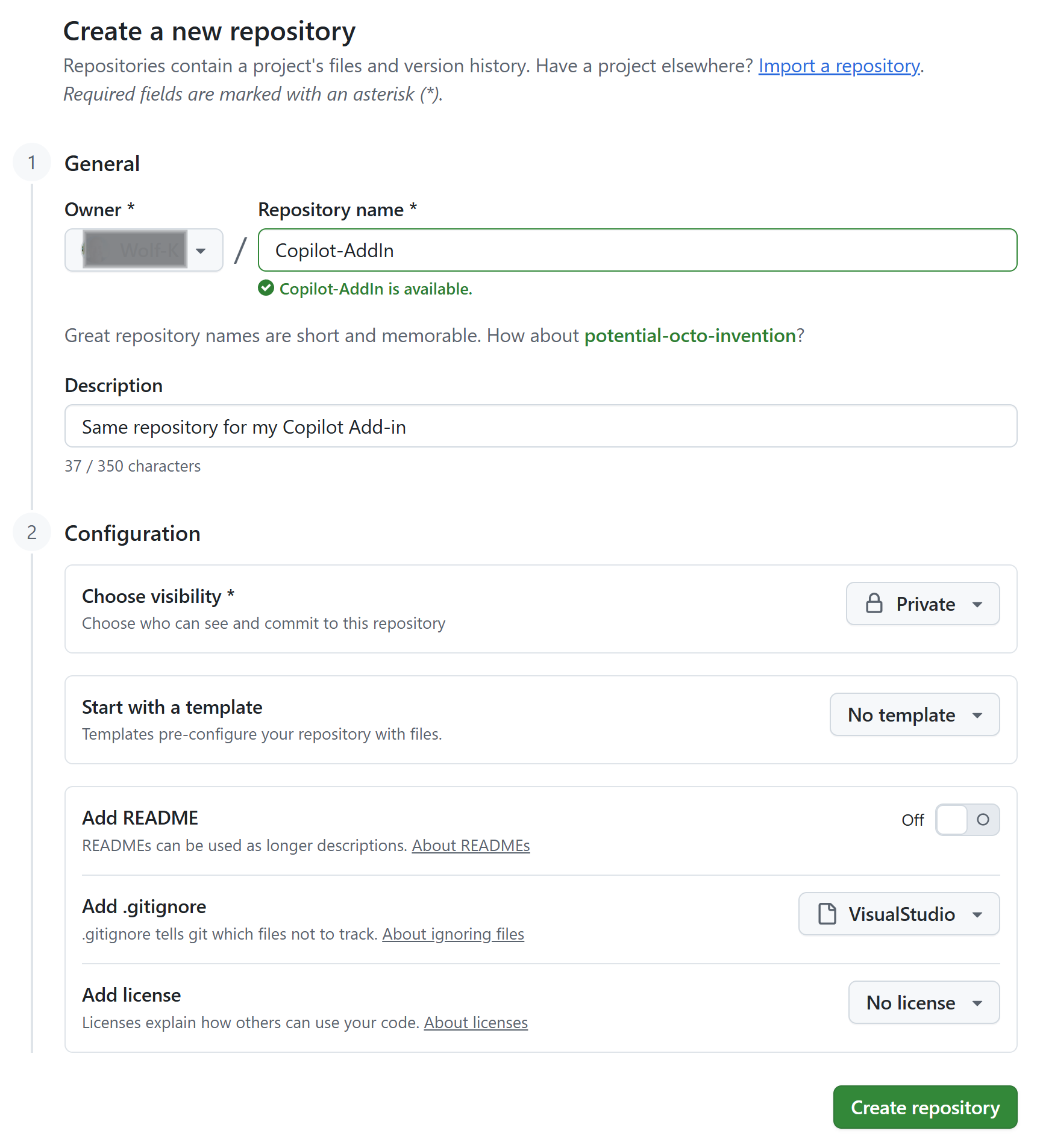

Step 3 Create a new GitHub Repository
  • On GitHub, create a new repository to store your ArcGIS Pro Add-in project. The repository can be made private to restrict access to the code.
  • Make sure to initialize the repository with the 'Visual Studio' .gitignore file to exclude files that should not be included in the repository. Create a new GitHub Repository

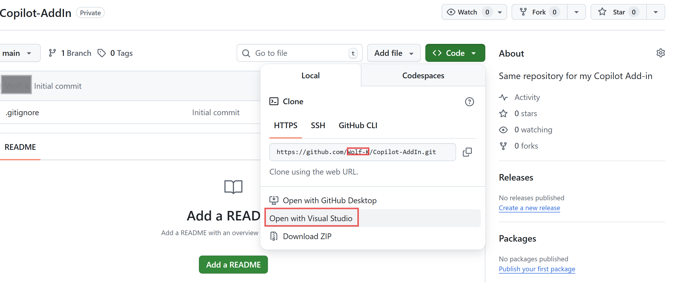

Step 4 Clone the GitHub Repository on your local machine
  • In Visual Studio, clone the GitHub repository you created in Step 3 to your local machine. You can use the 'Code' drop-down on the GitHub repository page to clone the repository directly into Visual Studio. Clone the GitHub Repository

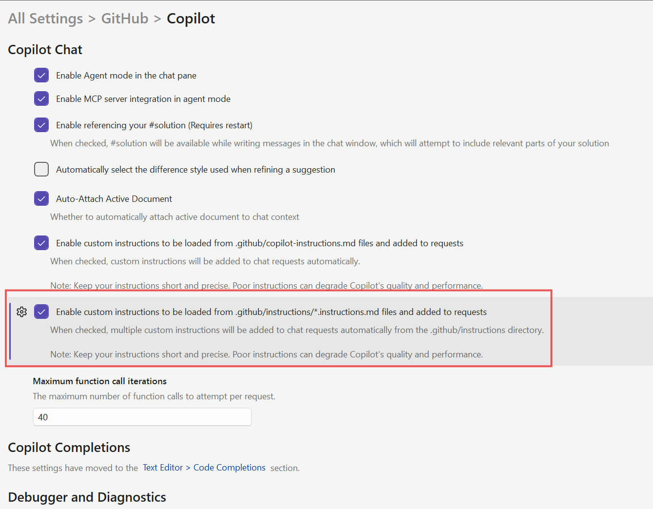

  1. Enable the feature in Visual Studio via Tools > Options > GitHub > Copilot > check this 'Copilot Chat' option: Enable custom instructions to be loaded from .github/copilot-instructions.md files and added to requests. Copilot Options

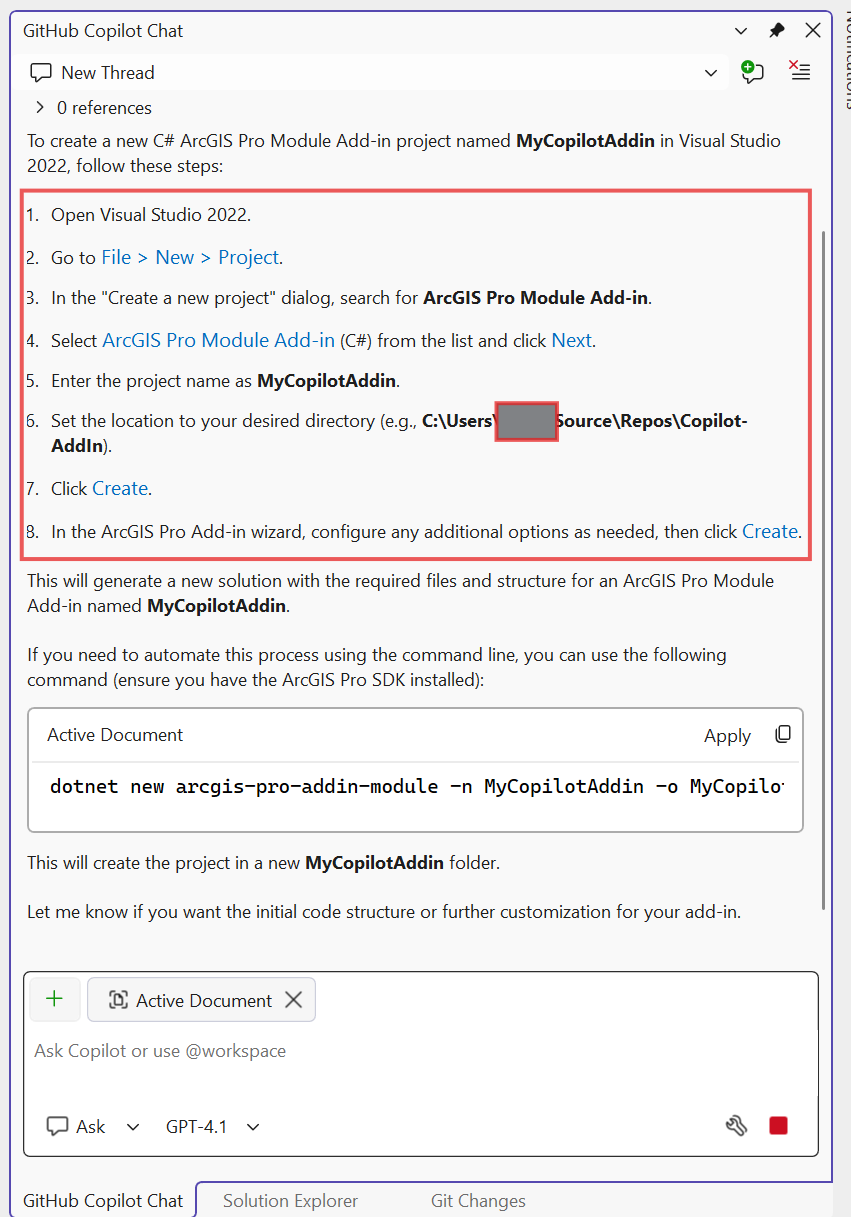

Step 1 Create a new ArcGIS Pro Add-in project
  1. In Visual Studio, create a new ArcGIS Pro Add-in project in the local folder where you cloned the GitHub repository. To do so you can simply open the 'GitHub Copilot Chat' window in Visual Studio and type the following prompt:
Create a new c# ArcGIS Pro Module Add-in Project called MyCopilotAddin
Create New Addin Project
  1. Copilot lists the manual steps to create the project. Follow this manual steps to create the project. Copilot also provides a command line option to create the project, however, at the time this document was released the command line didn't work. Rebuild the project to make sure everything is working.

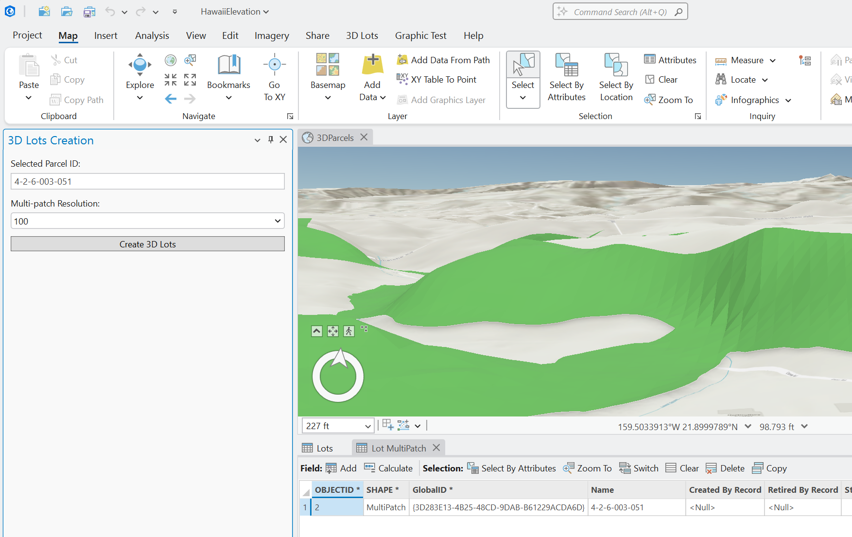

This ArcGIS Pro sample add-in uses a DockPane to guide the user through a GIS workflow. The DockPane allows the user to select a parcel lot feature from the map, displaying the selected parcel's ID, and has a drop-down option to select the final multi-patch polygon resolution (0 - rough, through 100 - fine in 10 increments), finally the dock-pane contains a button to initiate the 3D lot creation using the selected parcel lot as input.

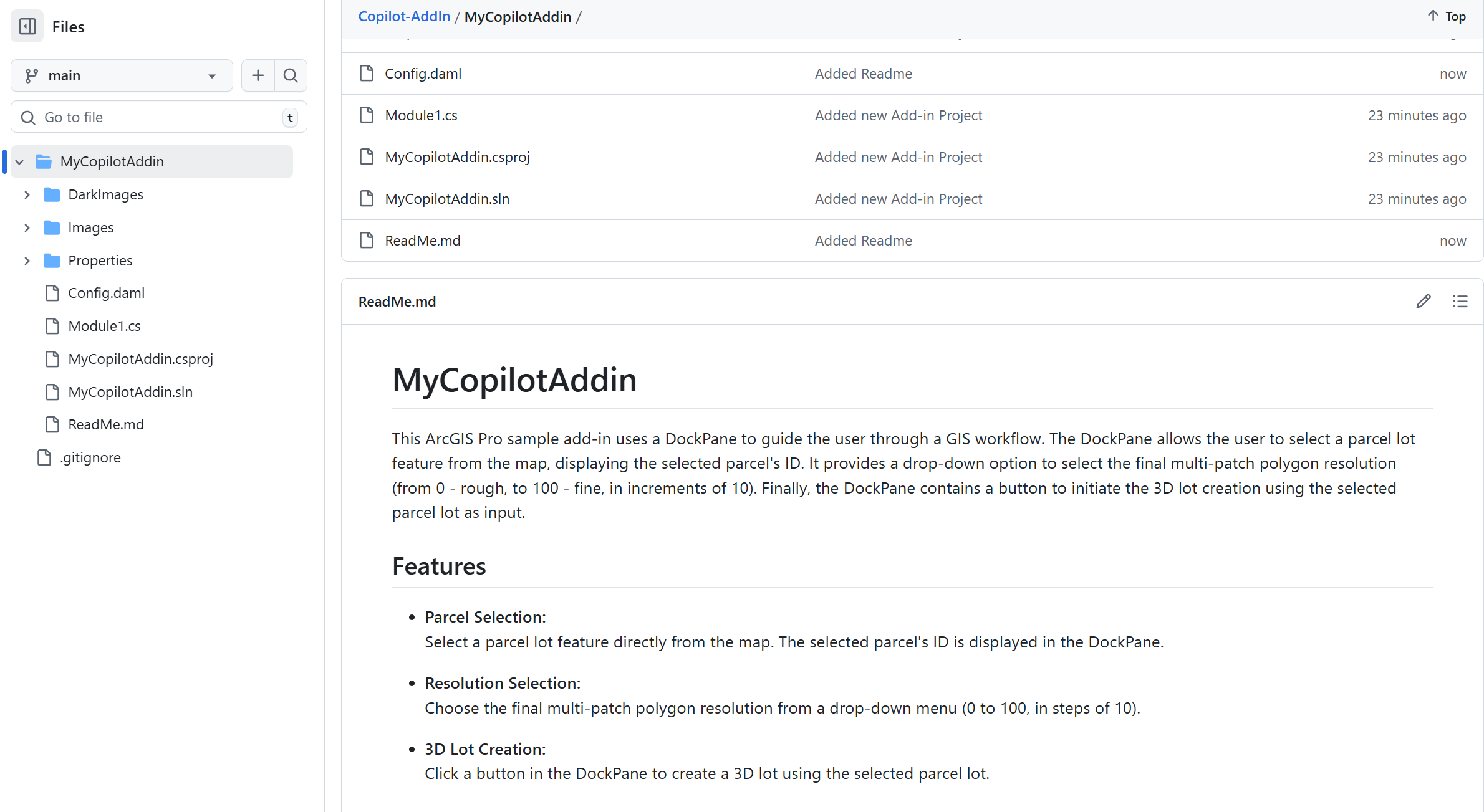

  1. Use GitHub Copilot to create a ReadMe.md file to describe the add-in, to do so type the following request in the 'GitHub Copilot Chat' window:
Create a README.md file to describe the add-in as follows: This ArcGIS Pro sample add-in uses a DockPane
Add Readme Note: In some cases you have to create an empty README.md file, make it the active document and then use the 'Apply' button in order to add the suggested text to the README.md file.

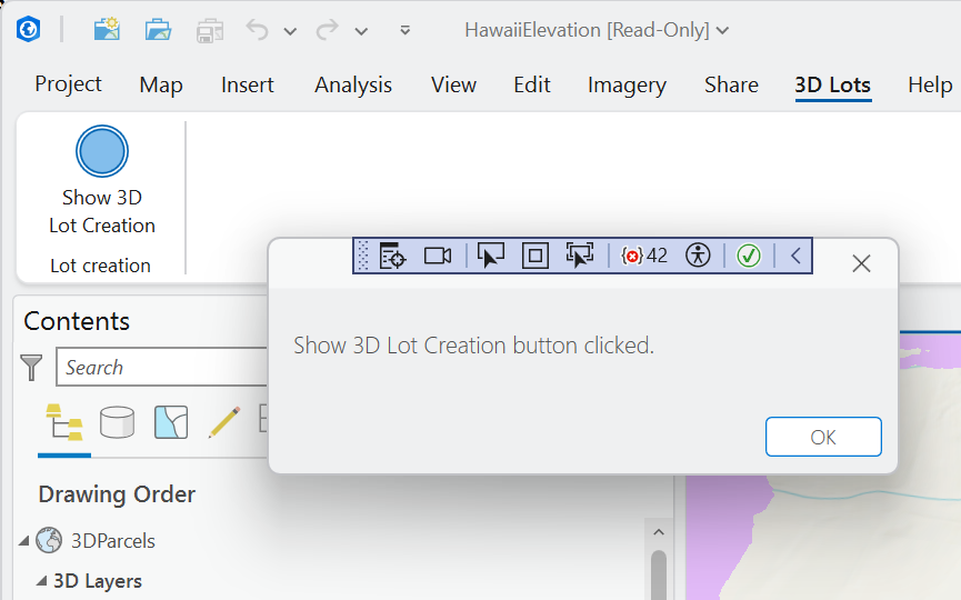

Step 4 Implement the Show3DLotCreationButton class
  1. In the 'GitHub Copilot Chat' window type the following prompt:
Implement next steps.
  1. In my case Copilot suggested the following stubbed implementation for the Show3DLotCreationButton class:
internal class Show3DLotCreationButton : Button
    protected override void OnClick()
        // TODO: Implement logic to show the 3D Lots Creation DockPane or dialog
        // Example: DockPane activation (replace with your DockPane ID)
        // DockPane pane = FrameworkApplication.DockPaneManager.Find("MyCopilotAddin_3DLotCreationDockPane");
        // if (pane != null)
        //     pane.Activate();
        // For now, show a simple message box as a placeholder
        MessageBox.Show("Show 3D Lots Creation button clicked.");
  1. Check the suggested code and accept it if it looks correct. Run the Add-in to verify that the 'Show 3D Lots Creation' button appears on the ArcGIS Pro ribbon under the '3D Lots' tab and 'Lots creation' group.

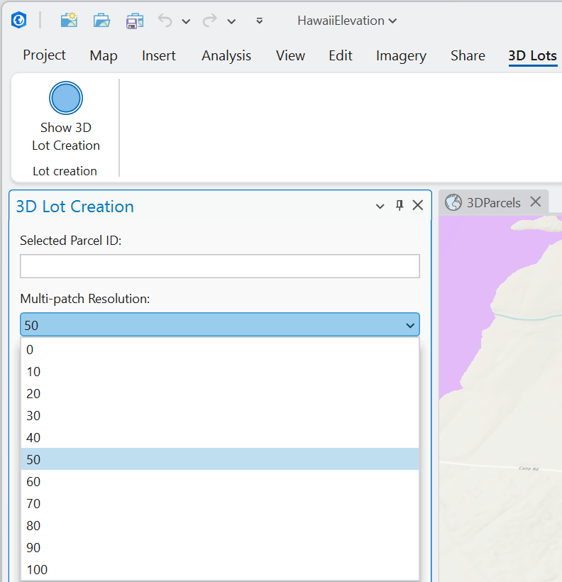

Step 5 Create the Dockpane for the addin
We add a tab, group, and button to the ArcGIS Pro ribbon to open the 'Show 3D lot creation' DockPane.

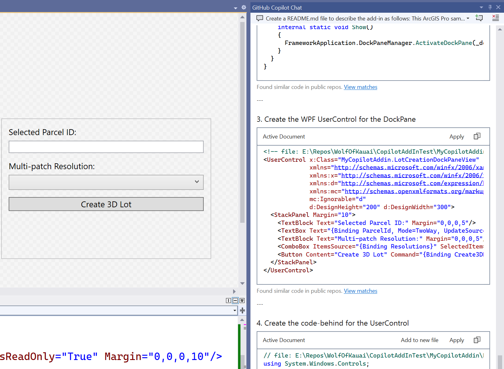

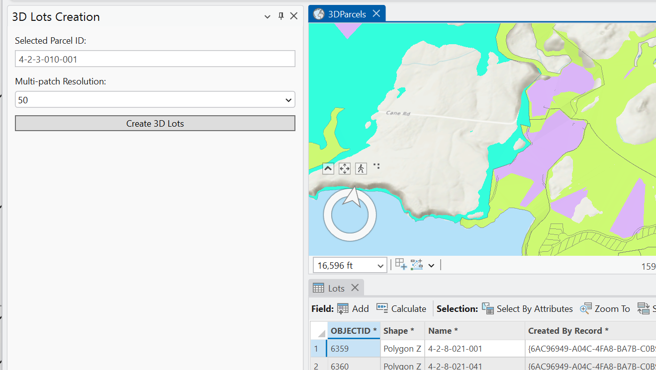

Create a DockPane with a text box to display the selected parcel ID, a drop-down to select the multi-patch resolution
(0 - rough, through 100 - fine in 10 increments), and a button to create the 3D lot.
  1. Examine the suggestions provided by Copilot and
  2. accept the suggestion if the code provided by Copilot is correct. Do not apply the addition of a new 'Show 3D Lots' button, since that button already exists. Note that Copilot provides updates to the config.daml and also creates the new files needed for the Dockpane MVVM. Dockpane UI added

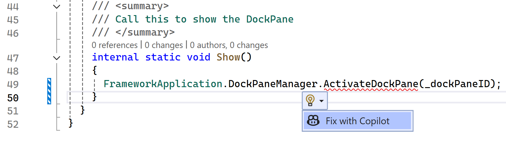

  3. Rebuild the project to make sure everything is working. In my case I had two errors a missing reference in the XAML file. I opened the XAML and asked Copilot:
Fix the missing StringNotEmptyConverter reference
  1. or you can navigate to the compiler error and Ask Copilot to fix the error.
    Fix With Copilot
  2. After accepting the changes rebuild the project again to verify that the errors have been fixed.

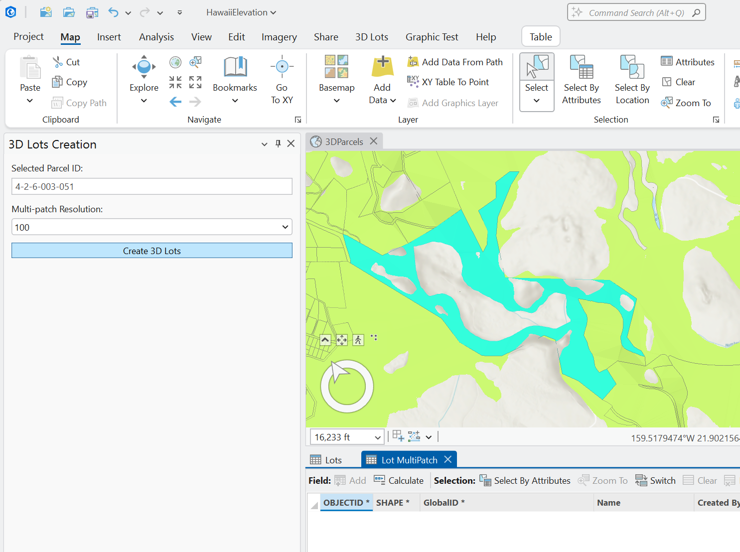

  3. When i tested the Add-in in ArcGIS Pro the DockPane didn't open and an examination of the config.daml file showed that the dockPane tag was added to controls and not to the dockPanes tag. I asked Copilot to fix the config.daml file by typing the following prompt in the 'GitHub Copilot Chat' window:
The dockpane tag has to be added under the dockPanes tag and is missing the content tag
  1. I accepted the suggestions and re-ran the Add-in to verify that the DockPane opened when clicking the 'Show 3D Lots Creation' button. Dockpane UI working

First, we need to fill in the SelectedParcelId property to display the selected parcel ID from the 'Lots' feature layer in the DockPane. To do this, we need to listen to the selection changed event in the MapView.
  1. In the GitHub Copilot Chat window, type the following prompt:
[Only add root namespace for ArcGIS.Desktop.]
In the DockPane ViewModel Subscribe to the MapView SelectionChanged event and use the first feature
from the selection in the 'Lots' feature layer to query the 'Lots' feature layer for the 'Name' field value.
In the DockPane ViewModel update the SelectedParcelId property with that Name field value.
Use the MapSelectionChangedEvent class to do this.

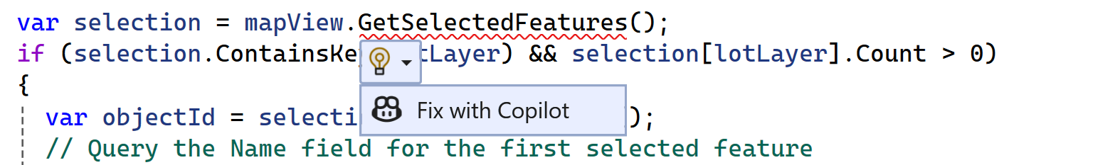

Note: In my case, Copilot provided a complete implementation that worked correctly; however, it added all possible ArcGIS.Desktop namespaces to the DockPane ViewModel. To prevent this, I asked Copilot to "Only add root namespaces for ArcGIS.Desktop." This fixed the issue.
  1. Rebuild the project to make sure everything is working. Run the Add-in, select a parcel in the 'Lots' feature layer, and verify that the selected parcel ID appears in the DockPane.
  2. If you encounter errors, you can ask Copilot to help you fix them. I navigated to the error and asked Copilot to fix it; note that this can be an iterative process. Dockpane ViewModel fix
  3. After accepting the changes, rebuild the project again to verify that the errors have been fixed. While debugging the feature selection, I noticed that Copilot didn't apply the QueuedTask.Run pattern properly. So I asked Copilot to fix this:
GetSelection has to be run within the context of QueuedTask.Run.
  1. Rebuild the project to make sure everything is working. You should now see that the SelectedParcelId property is being set correctly when selecting a lot in the map. Dockpane ViewModel fixed
