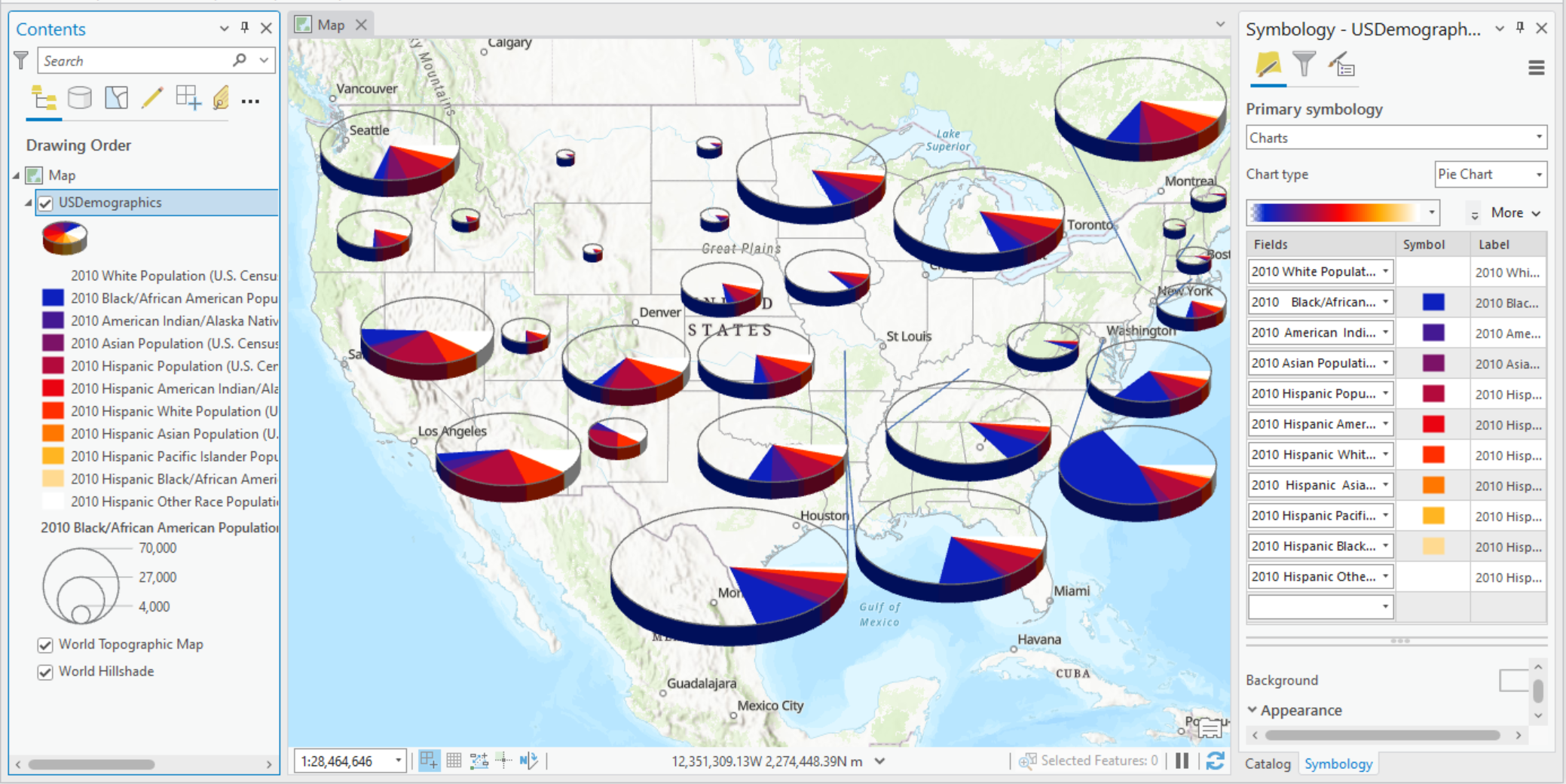

Pie chart renderer for a feature layer
Renders a feature layer using Pie chart symbols to represent data Pie chart renderer
//Check feature layer name
  //Code works with the USDemographics feature layer available with the ArcGIS Pro SDK Sample data
  var featureLayer = MapView.Active.Map.GetLayersAsFlattenedList().OfType<FeatureLayer>().FirstOrDefault(f => f.Name == "USDemographics");
  if (featureLayer == null)
    MessageBox.Show("This renderer works with the USDemographics feature layer available with the ArcGIS Pro SDK Sample data", "Data missing");
  //Note: Run within a QueuedTask
  //Fields to use for the pie chart slices
  var chartFields = new List<string>
          "WHITE10",
           "BLACK10",
           "AMERIND10",
           "ASIAN10",
           "HISPPOP10",
           "HAMERIND10",
           "HWHITE10",
           "HASIAN10",
           "HPACIFIC10",
           "HBLACK10",
            "HOTHRACE10"
  PieChartRendererDefinition pieChartRendererDefn = new PieChartRendererDefinition()
    ChartFields = chartFields,
    ColorRamp = colorRamp,
    SizeOption = PieChartSizeOptions.Field,
    FieldName = "BLACK10",
    FixedSize = 36.89,
    DisplayIn3D = true,
    ShowOutline = true,
    Orientation = PieChartOrientation.CounterClockwise,
  //Creates a "Renderer"
  var pieChartRenderer = featureLayer.CreateRenderer(pieChartRendererDefn);
  //Sets the renderer to the feature layer
  featureLayer.SetRenderer(pieChartRenderer);

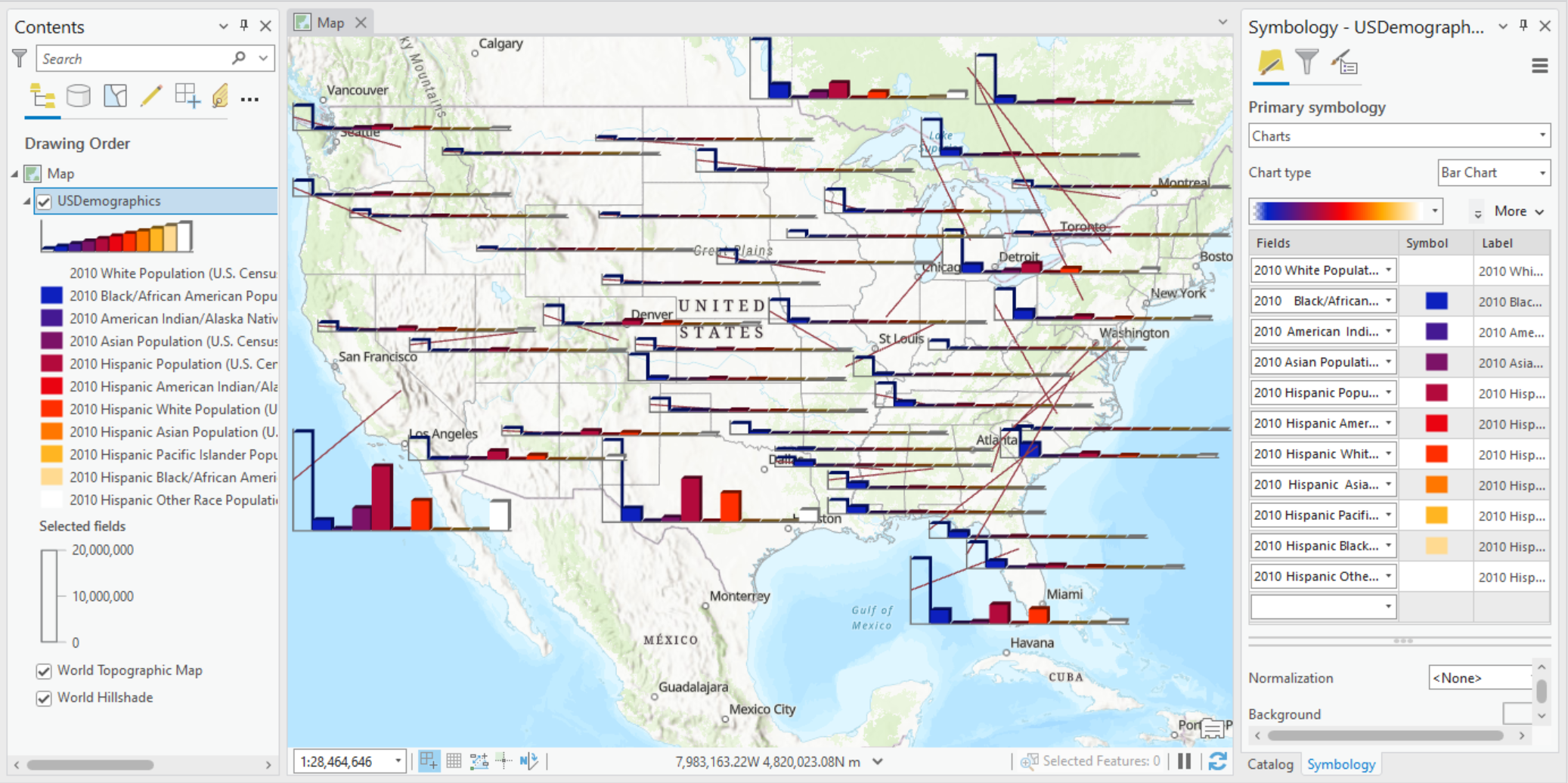

Bar Chart Value renderer for a feature layer
Renders a feature layer using Bar chart symbols to represent data bar chart renderer
        "WHITE10",
          "BLACK10",
          "AMERIND10",
          "ASIAN10",
          "HISPPOP10",
          "HAMERIND10",
          "HWHITE10",
          "HASIAN10",
          "HPACIFIC10",
          "HBLACK10",
          "HOTHRACE10"
  //Note: Run within QueuedTask
  BarChartRendererDefinition barChartRendererDefn = new BarChartRendererDefinition()
    BarWidth = 12,
    BarSpacing = 1,
    MaximumBarLength = 65,
    Orientation = ChartOrientation.Vertical,
    DisplayIn3D = true,
    ShowAxes = true,
  var barChartChartRenderer = featureLayer.CreateRenderer(barChartRendererDefn);
  featureLayer.SetRenderer(barChartChartRenderer);

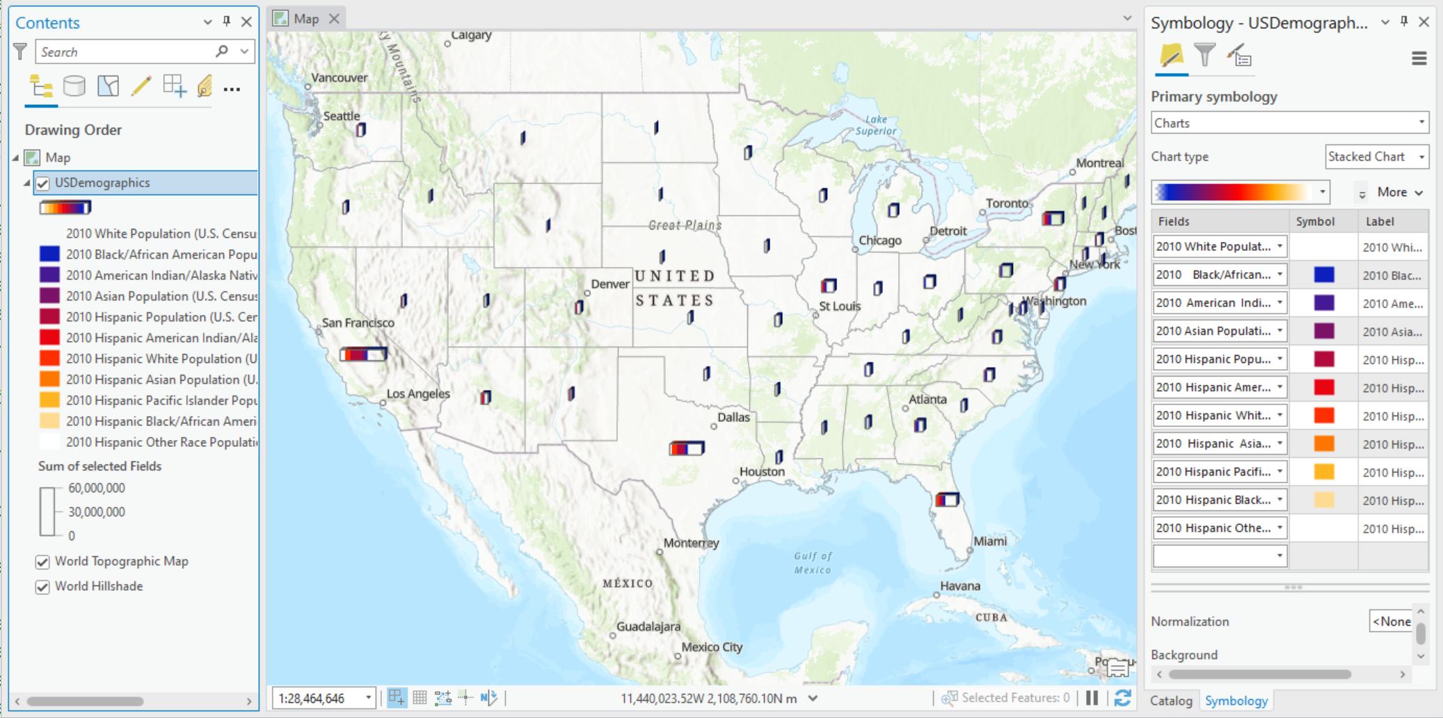

Stacked bar chart renderer for a feature layer
Renders a feature layer using stacked bar chart symbols to represent data stacked bar chart renderer
          "WHITE10",
           "BLACK10",
           "AMERIND10",
           "ASIAN10",
           "HISPPOP10",
           "HAMERIND10",
           "HWHITE10",
           "HASIAN10",
           "HPACIFIC10",
           "HBLACK10",
            "HOTHRACE10"
  StackedChartRendererDefinition barChartpieChartRendererDefn = new StackedChartRendererDefinition()
    SizeOption = StackChartSizeOptions.SumSelectedFields,
    Orientation = ChartOrientation.Horizontal,
    ShowOutline = true,
    DisplayIn3D = true,
    StackWidth = 8,
    StackLength = 25.87,
  var stackedBarChartChartRenderer = featureLayer.CreateRenderer(barChartpieChartRendererDefn);
  featureLayer.SetRenderer(stackedBarChartChartRenderer);

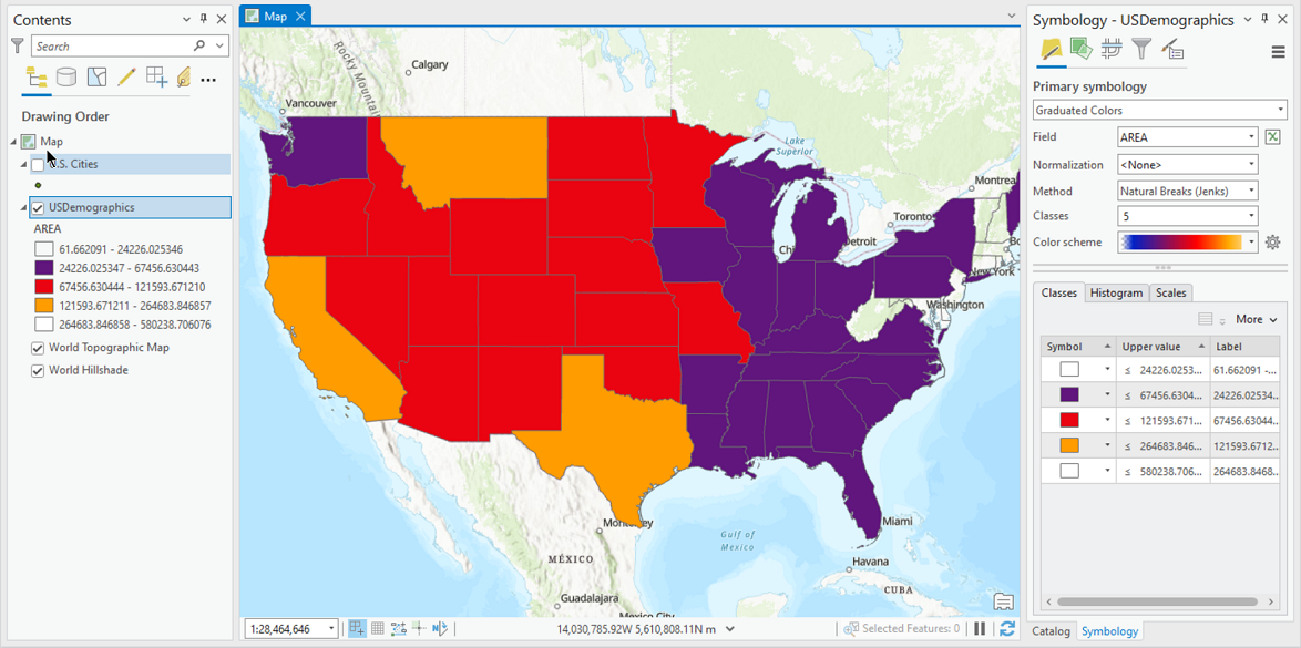

Class Breaks renderer with graduated colors.
Renders a feature layer using graduated colors to draw quantities. cb-colors.png
  GraduatedColorsRendererDefinition gcDef = new GraduatedColorsRendererDefinition()
    ClassificationField = "NumericFieldInFeatureLayer",
    ClassificationMethod = ClassificationMethod.NaturalBreaks,
    BreakCount = 5,
  CIMClassBreaksRenderer renderer = (CIMClassBreaksRenderer)featureLayer.CreateRenderer(gcDef);
  featureLayer?.SetRenderer(renderer);

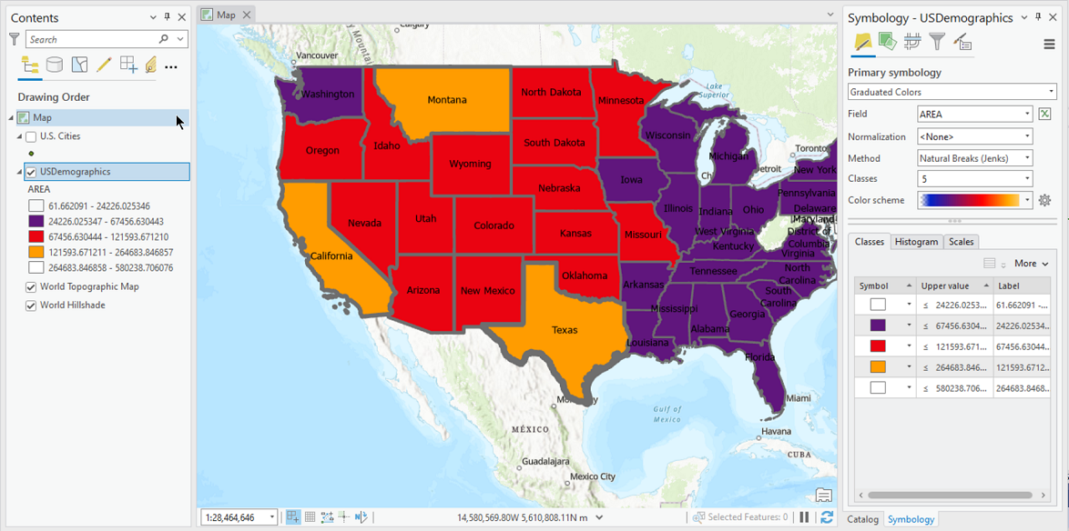

Class Breaks renderer with graduated colors and outline
Renders a feature layer using graduated colors to draw quantities. The outline width is varied based on attributes. graduatedColorOutline.png
  //Gets the first numeric field of the feature layer
  var firstNumericFieldOfFeatureLayer = "NumericFieldInFeatureLayer";
  //Gets the min and max value of the field
  var minMax = GetFieldMinMax(featureLayer, firstNumericFieldOfFeatureLayer);
    BreakCount = 5,
  //Create array of CIMVisualVariables to hold the outline information.
  var visualVariables = new CIMVisualVariable[] {
              new CIMSizeVisualVariable
                  ValueExpressionInfo = new CIMExpressionInfo
                     Title = "Custom",
                     Expression = "$feature.AREA",
                     ReturnType = ExpressionReturnType.Default
                  AuthoringInfo = new CIMVisualVariableAuthoringInfo
                      MinSliderValue = Convert.ToDouble(minMax.Item1),
                      MaxSliderValue = Convert.ToDouble(minMax.Item2),
                      ShowLegend = false,
                      Heading = firstNumericFieldOfFeatureLayer
                  VariableType = SizeVisualVariableType.Graduated,
                  Target = "outline",
                  MinSize = 1,
                  MaxSize = 13,
                  MinValue = Convert.ToDouble(minMax.Item1),
                  MaxValue = Convert.ToDouble(minMax.Item2)
  renderer.VisualVariables = visualVariables;

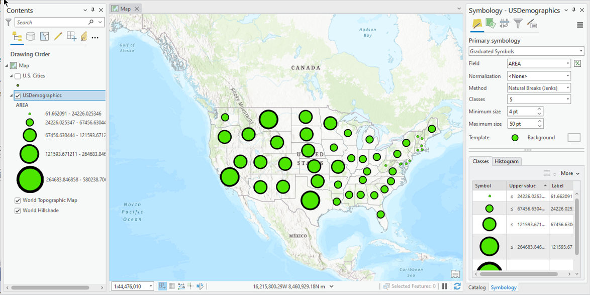

Class Breaks renderer with graduated symbols.
Renders a feature layer using graduated symbols and natural breaks to draw quantities. cb-symbols.png
  GraduatedSymbolsRendererDefinition gsDef = new GraduatedSymbolsRendererDefinition()
    ClassificationField = "NumericFieldInFeatureLayer", //getting the first numeric field
    SymbolTemplate = SymbolFactory.Instance.ConstructPointSymbol(CIMColor.CreateRGBColor(76, 230, 0)).MakeSymbolReference(),
    MinimumSymbolSize = 4,
    MaximumSymbolSize = 50,
    BreakCount = 5,
    ColorRamp = colorRamp, //getting a color ramp
  CIMClassBreaksRenderer renderer = (CIMClassBreaksRenderer)featureLayer.CreateRenderer(gsDef);

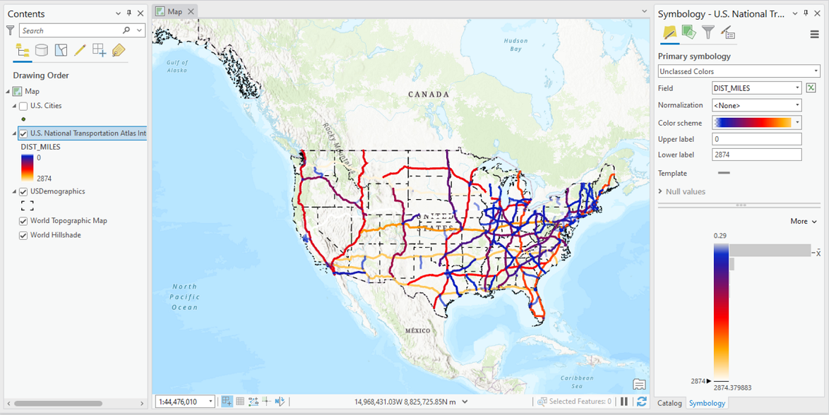

UnClassed graduated color renderer.
  var featureLayer = MapView.Active.Map.GetLayersAsFlattenedList().OfType<FeatureLayer>().FirstOrDefault(f => f.Name == "U.S. National Transportation Atlas Interstate Highways");
    MessageBox.Show("This renderer works with the U.S. National Transportation Atlas Interstate Highways feature layer available with the ArcGIS Pro SDK Sample data", "Data missing");
  //Refer to the GetFieldMinMax function below
  var labels = GetFieldMinMax(featureLayer, firstNumericFieldOfFeatureLayer);
  UnclassedColorsRendererDefinition ucDef = new UnclassedColorsRendererDefinition()
    Field = firstNumericFieldOfFeatureLayer,
    LowerColorStop = Convert.ToDouble(labels.Item1),
    UpperColorStop = Convert.ToDouble(labels.Item2),
    UpperLabel = labels.Item2,
    LowerLabel = labels.Item1,
  CIMClassBreaksRenderer renderer = (CIMClassBreaksRenderer)featureLayer.CreateRenderer(ucDef);

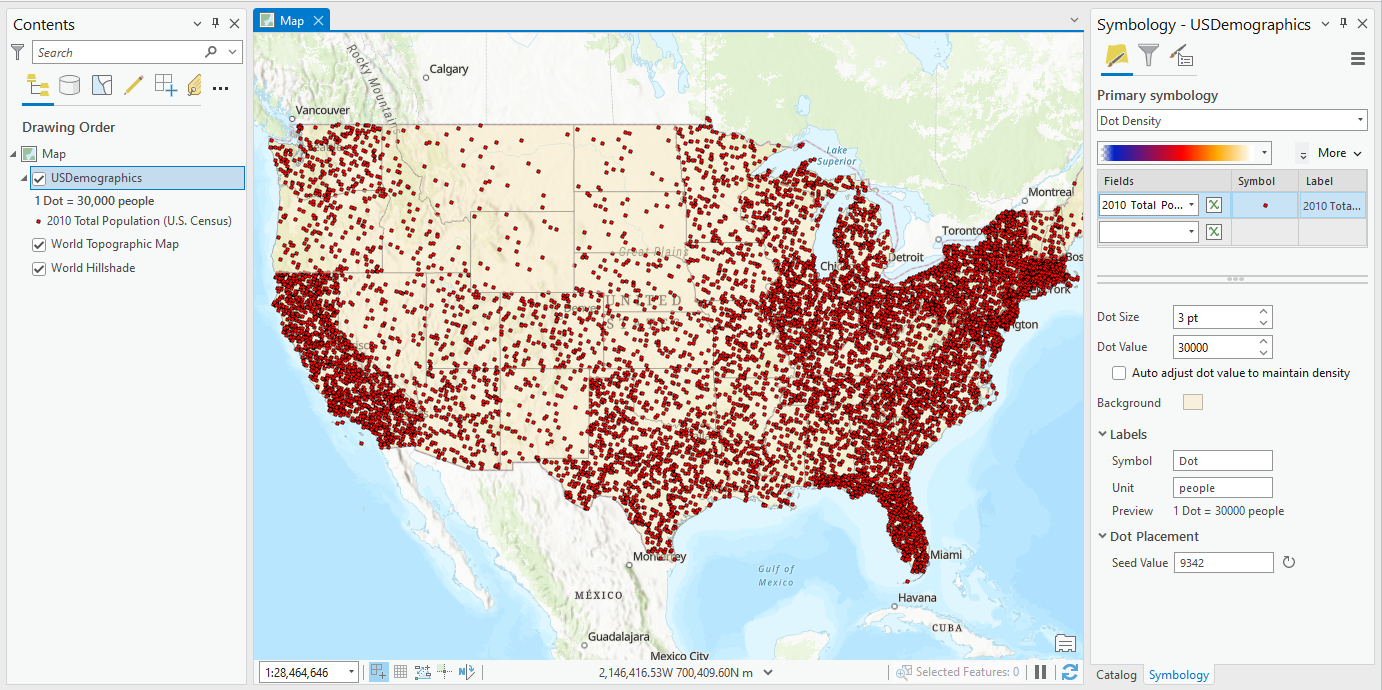

DotDensity Renderer
Dot Density renderer.
Renders a polygon feature layer with Dot Density symbols to represent quantities. Dot Density renderer
  //Define size of the dot to use for the renderer
  int dotSize = 3;
  //Check if the TOTPOP10 field exists
  int idxField = -1;
  using (var table = featureLayer.GetTable())
    var def = table.GetDefinition();
    idxField = def.FindField("TOTPOP10");
  // "TOTPOP10" field was not found
  if (idxField == -1)
    return;
  //array of fields to be represented in the renderer
  var valueFields = new List<string> { "TOTPOP10" };
  //Create the DotDensityRendererDefinition object
  var dotDensityDef = new DotDensityRendererDefinition(valueFields, colorRamp,
                                                                    dotSize, 30000, "Dot", "people");
  //Create the renderer using the DotDensityRendererDefinition
  CIMDotDensityRenderer dotDensityRndr = (CIMDotDensityRenderer)featureLayer.CreateRenderer(dotDensityDef);
  //if you want to customize the dot symbol for the renderer, create a "DotDensitySymbol" which is an
  //Amalgamation of 3 symbol layers: CIMVectorMarker, CIMSolidFill and CIMSolidStroke
  //Define CIMVectorMarker layer
  var cimMarker = SymbolFactory.Instance.ConstructMarker(ColorFactory.Instance.RedRGB, dotSize);
  var dotDensityMarker = cimMarker as CIMVectorMarker;
  //Define the placement
  CIMMarkerPlacementInsidePolygon markerPlacement = new CIMMarkerPlacementInsidePolygon { Randomness = 100, GridType = PlacementGridType.RandomFixedQuantity, Clipping = PlacementClip.RemoveIfCenterOutsideBoundary };
  dotDensityMarker.MarkerPlacement = markerPlacement;
  //Define CIMSolidFill layer
  CIMSolidFill solidFill = new CIMSolidFill { Color = new CIMRGBColor { R = 249, G = 232, B = 189, Alpha = 50 } };
  //Define CIMSolidStroke
  CIMSolidStroke solidStroke = new CIMSolidStroke { Color = ColorFactory.Instance.GreyRGB, Width = .5 };
  //Create the amalgamated CIMPolygonSymbol that includes the 3 layers
  var dotDensitySymbol = new CIMPolygonSymbol
    SymbolLayers = new CIMSymbolLayer[] { dotDensityMarker, solidFill, solidStroke }
  //Apply the dotDensitySymbol to the CIMDotDenstityRenderer's DotDensitySymbol property.
  dotDensityRndr.DotDensitySymbol = dotDensitySymbol.MakeSymbolReference();
  //Apply the renderer to the polygon Feature Layer.
  featureLayer.SetRenderer(dotDensityRndr);

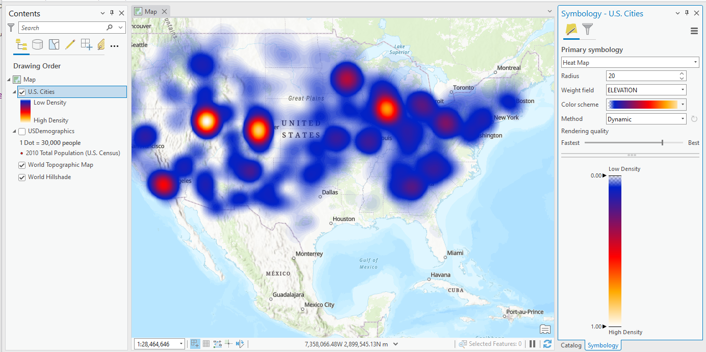

Heat map renderer
Renders a point feature layer using a continuous color gradient to represent density of points. Heat map renderer
  //Code works with the U.S. Cities feature layer available with the ArcGIS Pro SDK Sample data
  var featureLayer = MapView.Active.Map.GetLayersAsFlattenedList().OfType<FeatureLayer>().FirstOrDefault(f => f.Name == "U.S. Cities");
    MessageBox.Show("This renderer works with the U.S. Cities feature layer available with the ArcGIS Pro SDK Sample data", "Data missing");
  //defining a heatmap renderer that uses values from Population field as the weights
  HeatMapRendererDefinition heatMapDef = new HeatMapRendererDefinition()
    Radius = 20,
    WeightField = "NumericField",
    RendereringQuality = 8,
    UpperLabel = "High Density",
    LowerLabel = "Low Density"
  CIMHeatMapRenderer heatMapRndr = (CIMHeatMapRenderer)featureLayer.CreateRenderer(heatMapDef);
  featureLayer.SetRenderer(heatMapRndr);

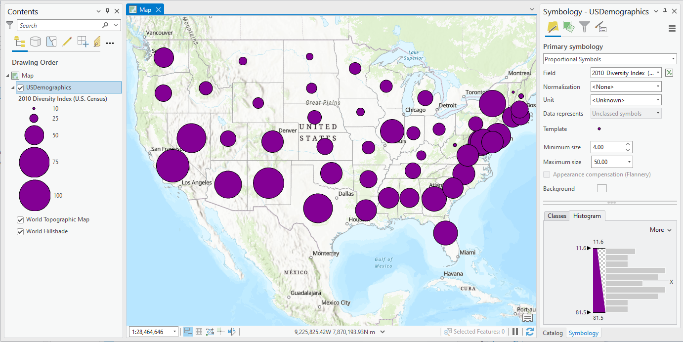

Proportional symbols renderer.
Renders a feature layer using proportional symbols to draw quantities. Proportional Symbols renderer
  var firstNumericFieldOfFeatureLayer = "NumericFieldInLayer";
  var sizes = GetFieldMinMax(featureLayer, firstNumericFieldOfFeatureLayer);
  ProportionalRendererDefinition prDef = new ProportionalRendererDefinition()
    LowerSizeStop = Convert.ToDouble(sizes.Item1),
    UpperSizeStop = Convert.ToDouble(sizes.Item2)
  CIMProportionalRenderer propRndr = (CIMProportionalRenderer)featureLayer.CreateRenderer(prDef);
  featureLayer.SetRenderer(propRndr);

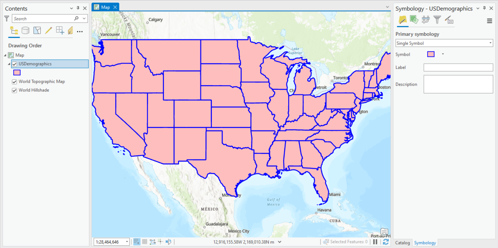

Simple Renderers
Simple Renderer for a Polygon feature layer.
Renders a Polygon feature layer using a single symbol. Simple Renderer for Polygon features
  //Creating a polygon with a red fill and blue outline.
  CIMStroke outline = SymbolFactory.Instance.ConstructStroke(
        ColorFactory.Instance.BlueRGB, 2.0, SimpleLineStyle.Solid);
  CIMPolygonSymbol fillWithOutline = SymbolFactory.Instance.ConstructPolygonSymbol(
        ColorFactory.Instance.CreateRGBColor(255, 190, 190), SimpleFillStyle.Solid, outline);
  //Get the layer's current renderer
  CIMSimpleRenderer renderer = featureLayer.GetRenderer() as CIMSimpleRenderer;
  //Update the symbol of the current simple renderer
  renderer.Symbol = fillWithOutline.MakeSymbolReference();
  //Update the feature layer renderer
  featureLayer.SetRenderer(renderer);

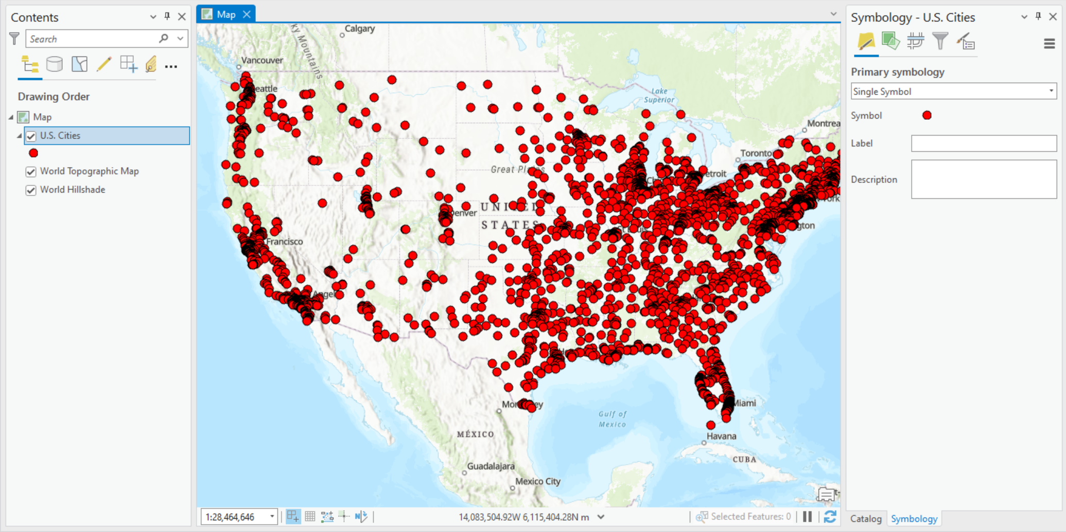

Simple Renderer for a Point feature layer.
Renders a Point feature layer using a single symbol. Simple Renderer for Point features
  var featureLayer = MapView.Active.Map.GetLayersAsFlattenedList().OfType<FeatureLayer>().FirstOrDefault(f => f.ShapeType == esriGeometryType.esriGeometryPoint);
    MessageBox.Show("This renderer works with a point feature layer", "Data missing");
  //Create a circle marker
  var pointSymbol = SymbolFactory.Instance.ConstructPointSymbol(ColorFactory.Instance.RedRGB, 8, SimpleMarkerStyle.Circle);
  renderer.Symbol = pointSymbol.MakeSymbolReference();

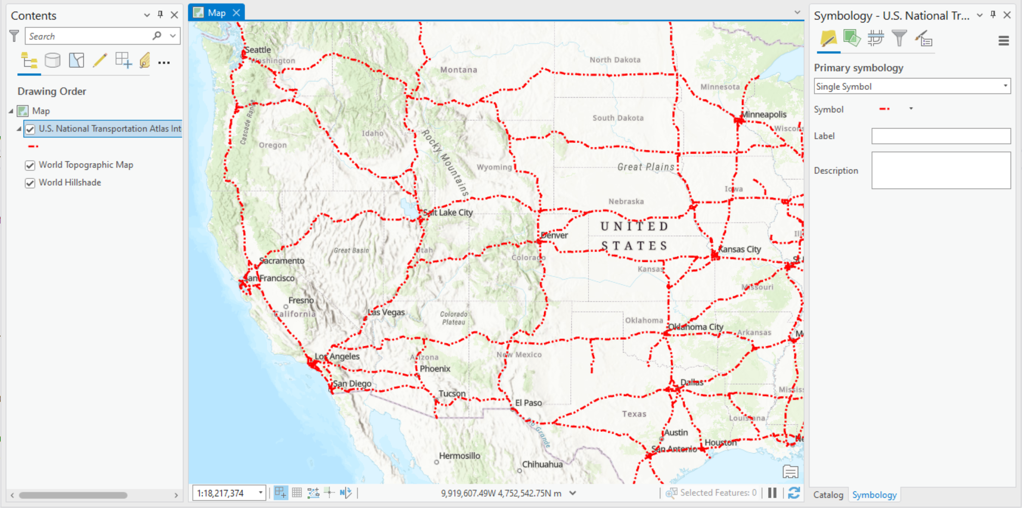

Simple Renderer for a Line feature layer.
Renders a Line feature layer using a single symbol. Simple Renderer for Line features
  var lineSymbol = SymbolFactory.Instance.ConstructLineSymbol(ColorFactory.Instance.RedRGB, 2, SimpleLineStyle.DashDotDot);
  renderer.Symbol = lineSymbol.MakeSymbolReference();

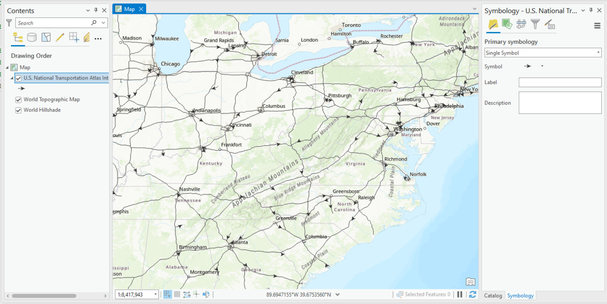

Simple Renderer for a Line feature layer using a style from a StyleProjectItem.
Renders a Line feature layer using a style from a StyleProjectItem. Simple Renderer Style item
  //Get all styles in the project
  var styleProjectItem2D = Project.Current.GetItems<StyleProjectItem>().FirstOrDefault(s => s.Name == "ArcGIS 2D");
  //Get a specific style in the project by name
  var arrowLineSymbol = styleProjectItem2D.SearchSymbols(StyleItemType.LineSymbol, "Arrow Line 2 (Mid)")[0];
  if (arrowLineSymbol == null) return;
  var renderer = featureLayer?.GetRenderer() as CIMSimpleRenderer;
  renderer.Symbol = arrowLineSymbol.Symbol.MakeSymbolReference();

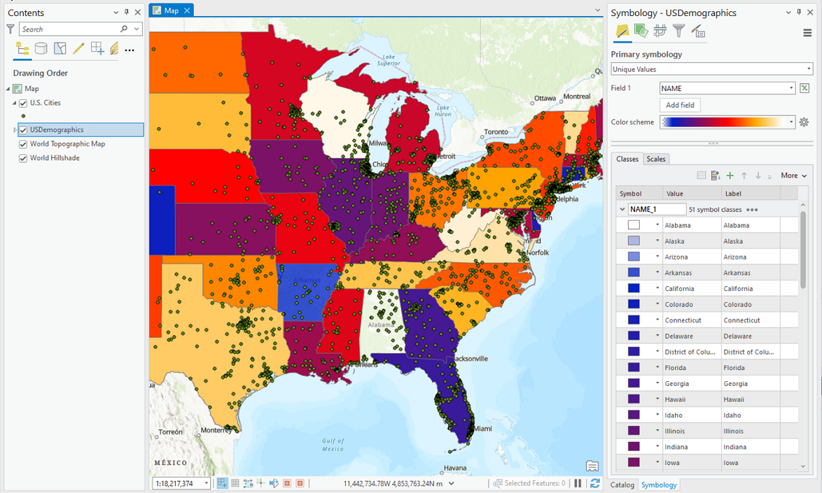

Unique Value Renderers
Unique Value Renderer for a feature layer
Renders a feature layer using unique values from one or multiple fields Unique Value renderer
  //construct unique value renderer definition
  UniqueValueRendererDefinition uvr = new
           UniqueValueRendererDefinition()
    //Refer to the function below to get a display field of the feature layer
    ValueFields = new List<string> { GetDisplayField(featureLayer) }, //multiple fields in the array if needed.
    ColorRamp = colorRamp, //Specify color ramp
  var cimRenderer = featureLayer.CreateRenderer(uvr);
  featureLayer.SetRenderer(cimRenderer);
