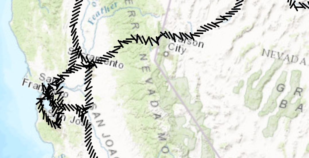

Line Symbology
Markers placed at a 45 degree angle
Create a line symbol with the markers placed at a 45 degree angle.
LineSymbolAngleMarker
//Create a line symbol with the markers placed at a 45 degree angle.
  //Create a marker from the "|" character.  This is the marker that will be used to render the line layer.
  //Note: Run withing QueuedTask
  var lineMarker = SymbolFactory.Instance.ConstructMarker(124, "Agency FB", "Regular", 12);
  //Default line symbol which will be modified
  CIMLineSymbol lineSymbolWithMarkersAtAngle = SymbolFactory.Instance.ConstructLineSymbol(ColorFactory.Instance.BlackRGB, 2, SimpleLineStyle.Solid);
  //Modifying the marker to align with line
  //First define "markerplacement"
  CIMMarkerPlacementAlongLineSameSize markerPlacement = new CIMMarkerPlacementAlongLineSameSize()
    AngleToLine = true,
    PlacementTemplate = new double[] { 5 }
  //assign the markerplacement to the marker
  lineMarker.MarkerPlacement = markerPlacement;
  //angle the marker if needed
  lineMarker.Rotation = 45;
  //assign the marker as a layer to the line symbol
  lineSymbolWithMarkersAtAngle.SymbolLayers[0] = lineMarker;

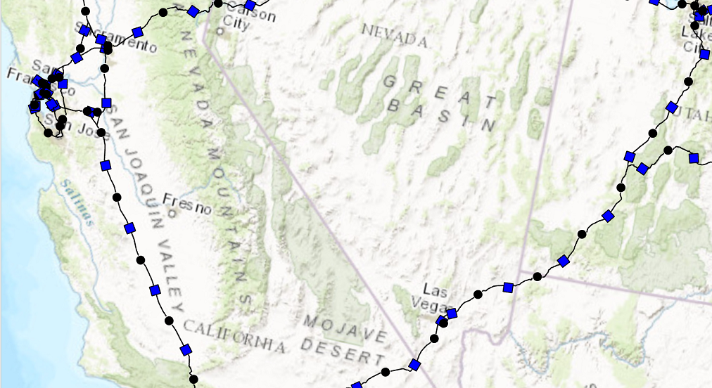

Dash line with two markers - Method I
Create a line symbol with a dash and two markers.
This line symbol comprises three symbol layers listed below:
  1. A solid stroke that has dashes.
  2. A circle marker.
  3. A square marker. LineSymbolTwoMarkers

Dash line with two markers - Method II
In this pattern of creating this symbol, a CIMVectorMarker object is created as a new CIMSymbolLayer. The circle and square markers created by ContructMarker method is then assigned to the MarkerGraphics property of the CIMVectorMarker. When using this method, the CIMVectorMarker's Frame property needs to be set to the CIMMarker object's Frame. Similarly, the CIMVectorMarker's Size property needs to be set to the CIMMarker object's size. This line symbol comprises three symbol layers listed below:
  2. A circle marker.

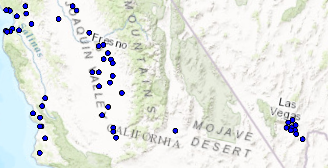

Point Symbology
Custom fill and outline
Creates a point symbol with custom fill and outline PointSymbolMarker
  var circlePtCustomFileOutlineSymbol = SymbolFactory.Instance.ConstructPointSymbol(ColorFactory.Instance.BlueRGB, 6, SimpleMarkerStyle.Circle);

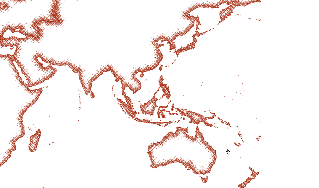

Diagonal cross hatch fill
Create a polygon symbol with a diagonal cross hatch fill.
PolygonSymbolDiagonalCrossHatch
var trans = 50.0;//semi transparent
  CIMStroke outline = SymbolFactory.Instance.ConstructStroke(CIMColor.CreateRGBColor(0, 0, 0, trans), 2.0, SimpleLineStyle.Solid);
  //Stroke for the fill
  var solid = SymbolFactory.Instance.ConstructStroke(CIMColor.CreateRGBColor(255, 0, 0, trans), 1.0, SimpleLineStyle.Solid);
  //Mimic cross hatch
  CIMFill[] diagonalCross =
              new CIMHatchFill() {
                  Enable = true,
                  Rotation = 45.0,
                  Separation = 5.0,
                  LineSymbol = new CIMLineSymbol() { SymbolLayers = new CIMSymbolLayer[1] { solid } }
                  Enable = true,
                  Rotation = -45.0,
                  Separation = 5.0,
  List<CIMSymbolLayer> symbolLayers =
      outline, .. diagonalCross
  //This is the polygon symbol with a diagonal cross hatch fill
  CIMPolygonSymbol diagonalCrossHatchFillSymbol = new()
    SymbolLayers = [.. symbolLayers]
  //To apply the symbol to a polygon feature layer
  //var renderer = theLayer.GetRenderer() as CIMSimpleRenderer;
  //renderer.Symbol = diagonalCrossHatchFillSymbol.MakeSymbolReference();
  //theLayer.SetRenderer(renderer);

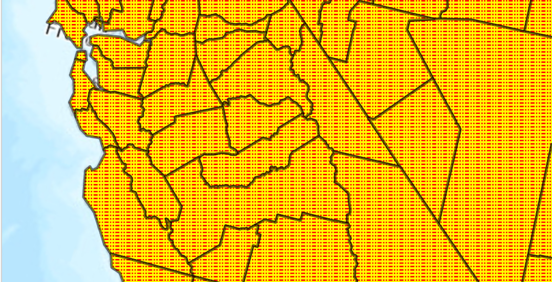

Cross hatch
Create a polygon symbol using the ConstructHatchFill method .
CIMStroke lineStroke = SymbolFactory.Instance.ConstructStroke(CIMColor.CreateRGBColor(51, 51, 51, 60), 4, SimpleLineStyle.Solid);
  //gradient
  var hatchFill = SymbolFactory.Instance.ConstructHatchFill(lineStroke, 45, 6, 0);
  List<CIMSymbolLayer> symbolLayers = new()
    hatchFill
  CIMPolygonSymbol crossHatchPolygonSymbol = new CIMPolygonSymbol() { SymbolLayers = symbolLayers.ToArray() };
  //renderer.Symbol = crossHatchPolygonSymbol.MakeSymbolReference();

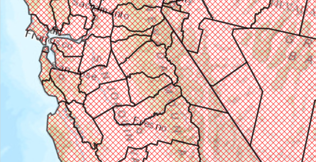

Dash dot fill
Create a polygon symbol with a dash dot fill.
PolygonSymbolDashDot
  var dashDot = SymbolFactory.Instance.ConstructStroke(ColorFactory.Instance.RedRGB, 1.0, SimpleLineStyle.DashDotDot);
  //Mimic cross hatch
  CIMFill[] solidColorHatch =
           new CIMHatchFill()
              Enable = true,
              Rotation = 0.0,
              Separation = 2.5,
              LineSymbol = new CIMLineSymbol(){SymbolLayers = new CIMSymbolLayer[1] {dashDot } }
           new CIMSolidFill()
              Enable = true,
              Color = ColorFactory.Instance.CreateRGBColor(255, 255, 0)
  List<CIMSymbolLayer> symbolLayers = [outline, .. solidColorHatch];
  //This is the polygon symbol with a dash dot fill
  CIMPolygonSymbol dashDotFillPolygon = new CIMPolygonSymbol() { SymbolLayers = symbolLayers.ToArray() };
  //renderer.Symbol = dashDotFillPolygon.MakeSymbolReference();

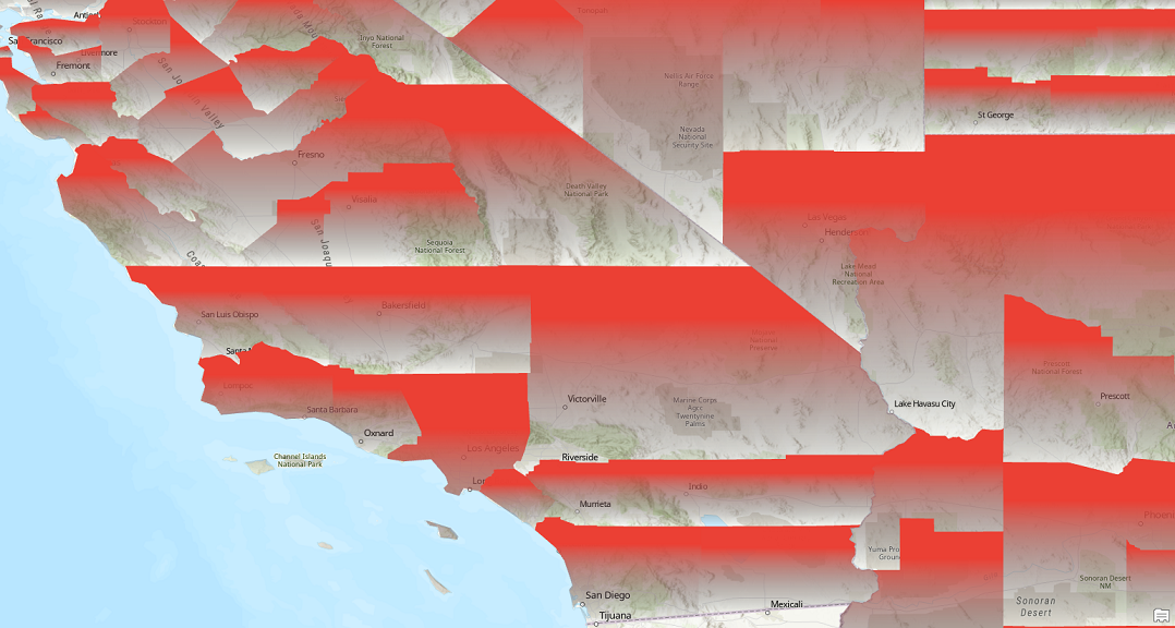

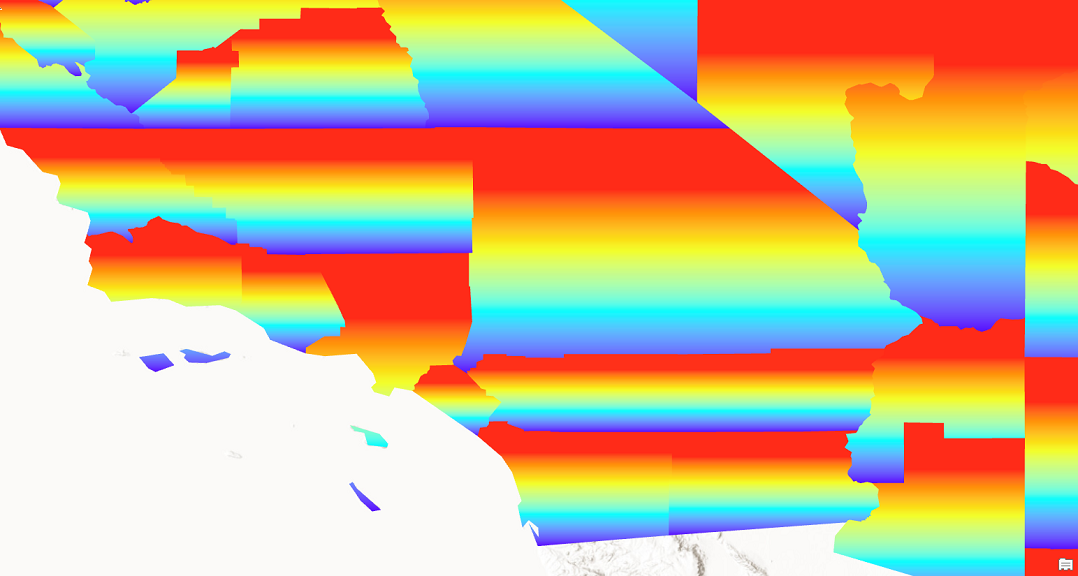

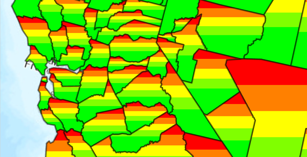

Gradient color fill using CIMGradientFill
Create a polygon symbol with a gradient color fill.
PolygonSymbolGradientColor
  1. Create a solid colored stroke with 50% transparency
  2. Create a fill using gradient colors red through green
  3. Apply both the stroke and fill as a symbol layer array to the new PolygonSymbol
  //Mimic cross hatch
  CIMFill solidColorHatch =
         new CIMGradientFill()
           ColorRamp = ColorFactory.Instance.ConstructColorRamp(ColorRampAlgorithm.LinearContinuous,
                                ColorFactory.Instance.RedRGB, ColorFactory.Instance.GreenRGB)
  List<CIMSymbolLayer> symbolLayers = new List<CIMSymbolLayer>
              outline,
              solidColorHatch
  CIMPolygonSymbol gradientColorFillPolygon = new CIMPolygonSymbol() { SymbolLayers = symbolLayers.ToArray() };
  //renderer.Symbol = gradientColorFillPolygon.MakeSymbolReference();
Gradient fill between two colors
Create a polygon symbol using the ConstructGradientFill method. Constructs a gradient fill between two colors passed to the method.
PolygonSymbolTwoColors
  //gradient fill between 2 colors
  var gradientFill = SymbolFactory.Instance.ConstructGradientFill(CIMColor.CreateRGBColor(235, 64, 52), CIMColor.NoColor(), GradientFillMethod.Linear);
              gradientFill
  CIMPolygonSymbol gradientFillTwoColors = new CIMPolygonSymbol() { SymbolLayers = symbolLayers.ToArray() };
  //renderer.Symbol = gradientFillTwoColors.MakeSymbolReference();

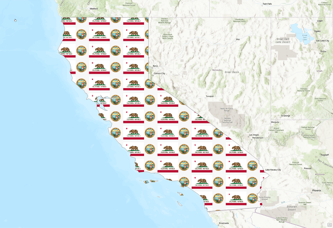

Picture fill
Constructs a picture fill with the specified parameters. ConstructPictureFill
  CIMStroke outline = SymbolFactory.Instance.ConstructStroke(CIMColor.CreateRGBColor(110, 110, 110), 2.0, SimpleLineStyle.Solid);
  //picture
  var imgPath = Path.Combine(Path.GetDirectoryName(Assembly.GetExecutingAssembly().Location), @"Images\CaliforniaEmblem.png");
  var pictureFill = SymbolFactory.Instance.ConstructPictureFill(imgPath, 64);
    outline,
    pictureFill
  CIMPolygonSymbol pictureFillPolygonSymbol = new CIMPolygonSymbol() { SymbolLayers = symbolLayers.ToArray() };
  //renderer.Symbol = pictureFillPolygonSymbol.MakeSymbolReference();

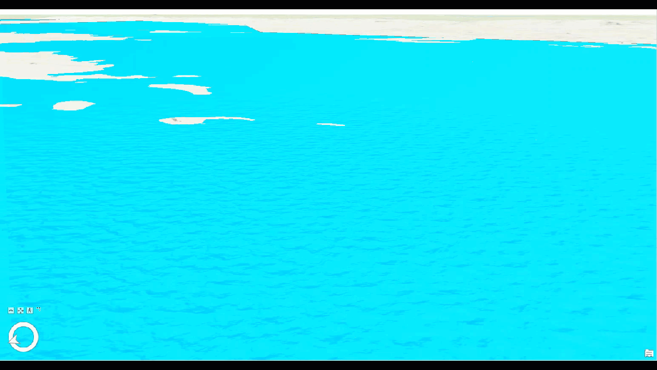

Animation water
Constructs a water fill of specific color, waterbody size and wave strength. This fill can be used on polygon feature classes in a Scene view only. ConstructWaterFill
  CIMStroke outline = SymbolFactory.Instance.ConstructStroke(CIMColor.CreateRGBColor(49, 49, 49, 50.0), 2.0, SimpleLineStyle.Solid);
  var waterFill = SymbolFactory.Instance.ConstructWaterFill(CIMColor.CreateRGBColor(3, 223, 252), WaterbodySize.Large, WaveStrength.Rippled);
              outline,
              waterFill
  CIMPolygonSymbol waterFillPolygonSymbol = new CIMPolygonSymbol() { SymbolLayers = symbolLayers.ToArray() };
  //renderer.Symbol = waterFillPolygonSymbol.MakeSymbolReference();

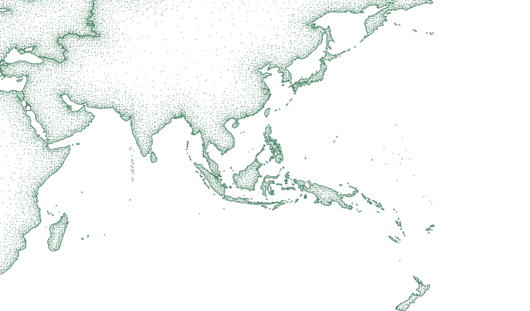

Pen and Ink: Stipple
Constructs a polygon symbol in the specified color representing a pen and ink stipple effect. See https://www.esri.com/arcgis-blog/products/arcgis-pro/mapping/please-steal-this-pen-and-ink-style/ polygonStipple.png
  //Stipple pen and ink
  var penInkRipple = SymbolFactory.Instance.ConstructPolygonSymbolWithPenInkStipple(CIMColor.CreateRGBColor(78, 133, 105), true);
  CIMPolygonSymbol penInkStipple = penInkRipple;
  //renderer.Symbol = penInkStipple.MakeSymbolReference();
Pen and Ink: Cross Hatch
Constructs a polygon symbol in the specified color representing a pen and ink cross hatch effect. See https://www.esri.com/arcgis-blog/products/arcgis-pro/mapping/please-steal-this-pen-and-ink-style/ polygonPNHatch.png
  //Cross Hatch pen and ink
  var penkInkCrossHatch = SymbolFactory.Instance.ConstructPolygonSymbolWithPenInkCrossHatch(CIMColor.CreateRGBColor(168, 49, 22), true);
  CIMPolygonSymbol penInkCrossHatch = penkInkCrossHatch;
  //renderer.Symbol = penInkCrossHatch.MakeSymbolReference();

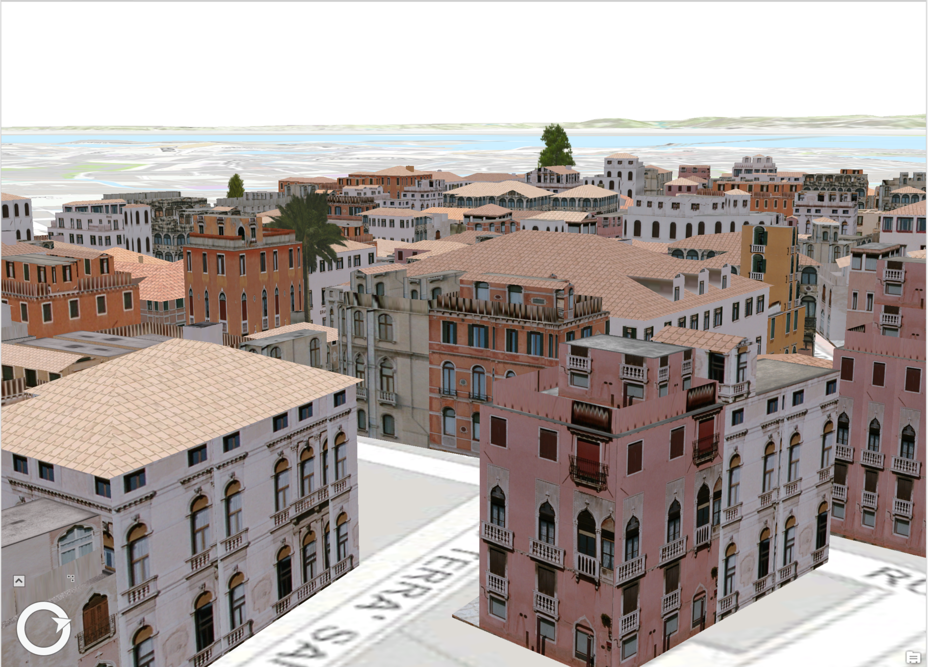

Procedural Symbol
Create a procedural symbol that can be applied to a polygon building footprint layer ProceduralSymbol Note: The rule package used in this method can be obtained from the Sample Data included in the arcgis-pro-sdk-community-samples repository.
  string _rulePkgPath = @"C:\Data\RulePackages\Venice_2014.rpk";
  //Polygon symbol to hold the procedural layer
  var proceduralSymbol = SymbolFactory.Instance.ConstructPolygonSymbol();
  //Array of layers to hold a procedural symbol layer
  CIMSymbolLayer[] proceduralSymbolLyr =
            new CIMProceduralSymbolLayer()
                PrimitiveName = "Venice Rule package 2014",
                RulePackage = _rulePkgPath,
                RulePackageName = "Venice_2014",
  proceduralSymbol.SymbolLayers = proceduralSymbolLyr;
  //renderer.Symbol = proceduralSymbol.MakeSymbolReference();
