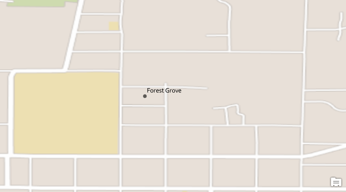

Creates a simple text symbol
Creates a simple black text symbol with a size of 8.5, Font Family "Corbel" and Font Style of "Regular". lineCallOut
//Create a simple text symbol
  //Note: Run this code inside a QueuedTask
  CIMTextSymbol simpleTextSymbol = SymbolFactory.Instance.ConstructTextSymbol(ColorFactory.Instance.BlackRGB, 8.5, "Corbel", "Regular");
  //Refer to the snippet "How to apply a Text Symbol to labels of a layer" below to see how to apply this text symbol to a label class

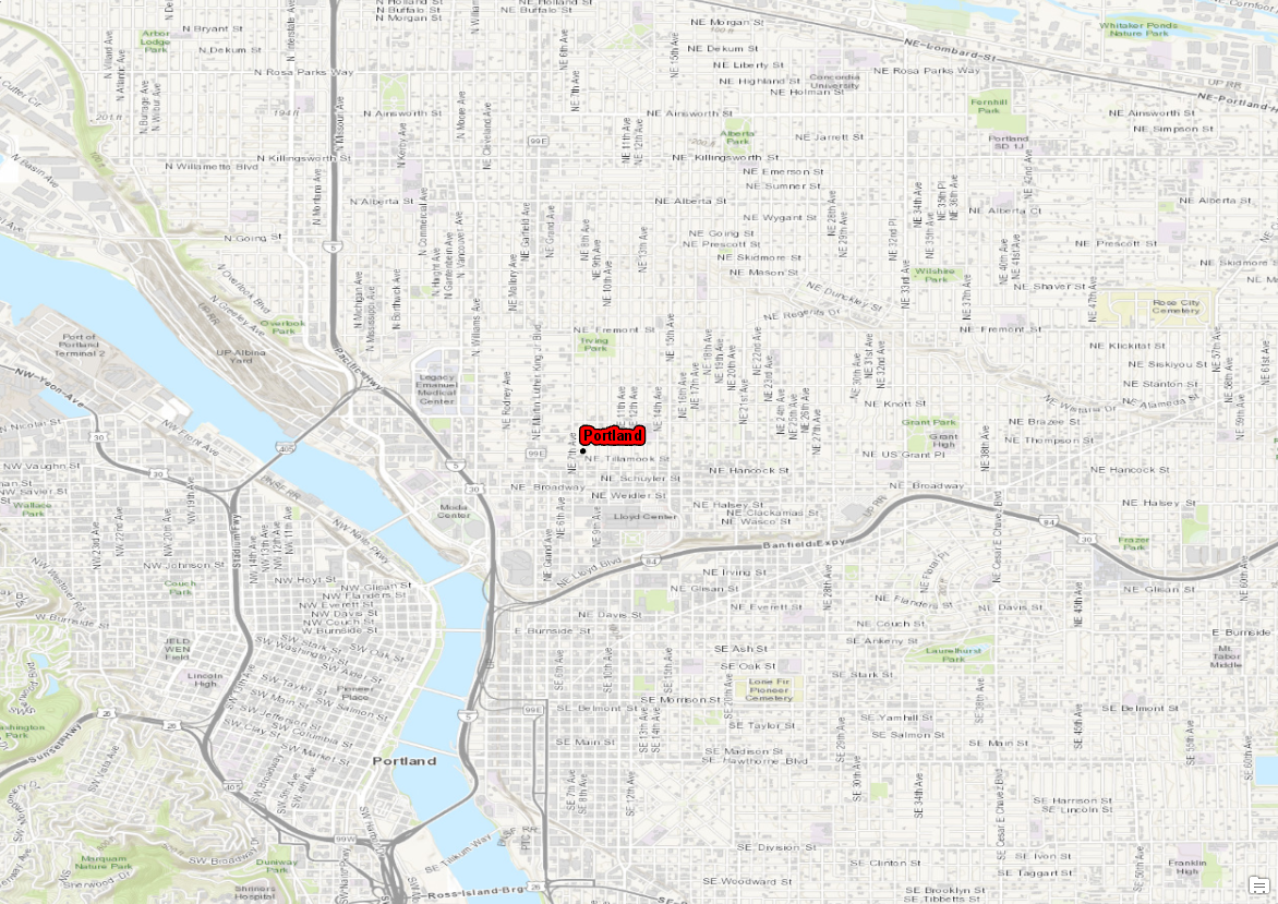

Snippet Creates a text symbol with a halo
Creates a text symbol with a red halo halo
//create a polygon symbol for the halo
  var haloPoly = SymbolFactory.Instance.ConstructPolygonSymbol(ColorFactory.Instance.RedRGB, SimpleFillStyle.Solid);
  //create text symbol using the halo polygon
  CIMTextSymbol textSymbolWithHalo = SymbolFactory.Instance.ConstructTextSymbol(haloPoly, 10, "Arial", "Bold");

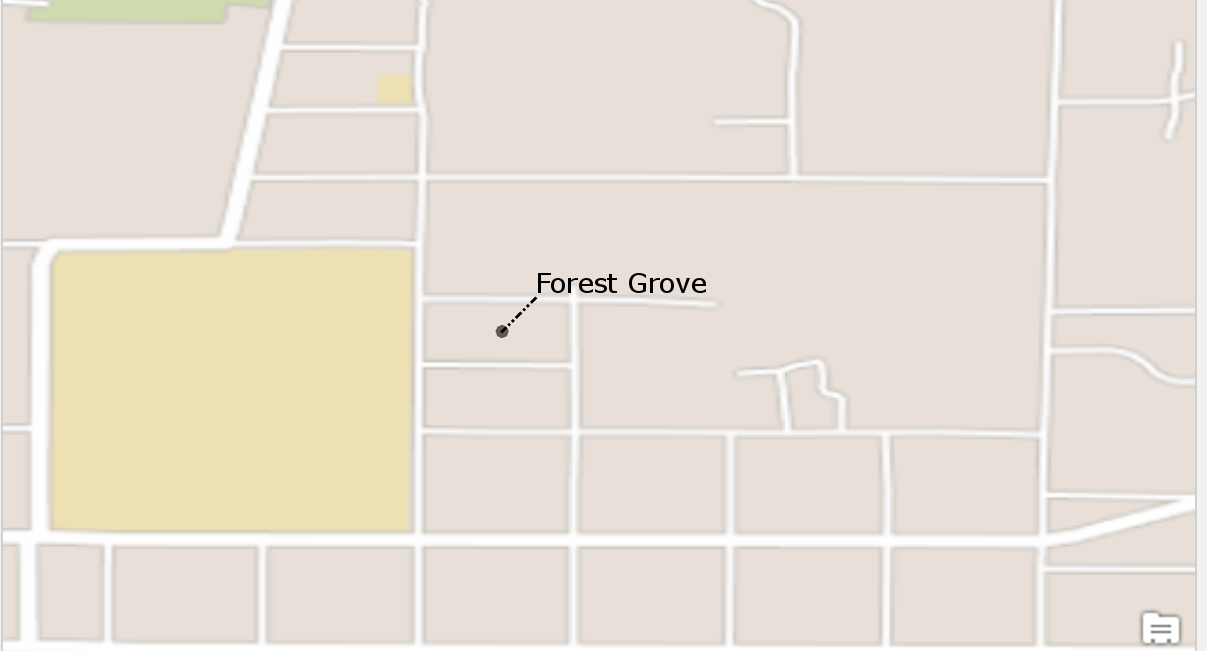

Snippet Creates a simple line callout text symbol
Creates a simple line callout text symbol. The CIMSimpleLineCallout created is a dash-dot-dash line symbol with an offset of 10 from the geometry being labeled. lineCallOut
//create a text symbol
  var textSymbolCallOut = SymbolFactory.Instance.ConstructTextSymbol(ColorFactory.Instance.BlackRGB, 10, "Verdana", "Regular");
  //Create a line call out
  var lineCalloutSymbol = new CIMSimpleLineCallout();
  //Get a line symbol
  var lineSymbol = SymbolFactory.Instance.ConstructLineSymbol(ColorFactory.Instance.BlackRGB, 1, SimpleLineStyle.DashDotDot);
  //assign the line symbol to the callout
  lineCalloutSymbol.LineSymbol = lineSymbol;
  //Offset for the text
  textSymbolCallOut.OffsetX = 10;
  textSymbolCallOut.OffsetY = 10;
  //Assign the callout to the text symbol
  textSymbolCallOut.Callout = lineCalloutSymbol;

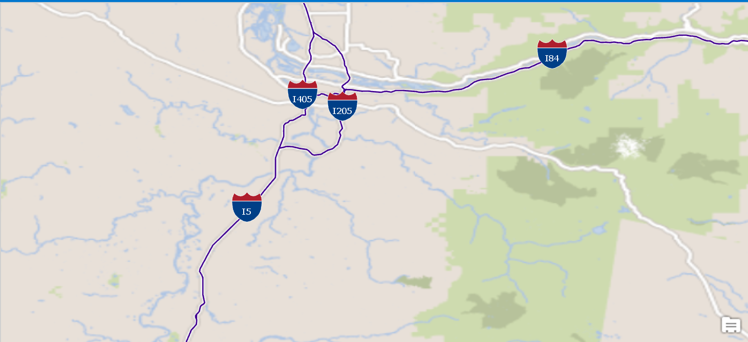

Snippet Creates a point callout text symbol
Creates a highway shield callout text symbol. The CIMPointSymbolCallout created is a highway shield point symbol from the ArcGIS 2D style. lineCallOut
  var textSymbolPointCallout = SymbolFactory.Instance.ConstructTextSymbol(ColorFactory.Instance.WhiteRGB, 6, "Tahoma", "Bold");
  //Create a call out
  var shieldCalloutSymbol = new CIMPointSymbolCallout();
  //Get a Shield symbolStyleItem from ArcGIS 2D StyleProjectitem
  var symbolStyleItem = GetPointSymbol("ArcGIS 2D", "Shield 1");
  //assign the point symbol (Highway shield) to the callout
  shieldCalloutSymbol.PointSymbol = symbolStyleItem.Symbol as CIMPointSymbol;
  shieldCalloutSymbol.PointSymbol.SetSize(18.0); //set symbol size
  textSymbolPointCallout.Callout = shieldCalloutSymbol;
  //Gets a Highway point symbol from a style
  static SymbolStyleItem GetPointSymbol(string styleProjectItemName, string symbolStyleName)
    var style2DProjectItem = Project.Current.GetItems<StyleProjectItem>().Where(p => p.Name == styleProjectItemName).FirstOrDefault();
    var symbolStyle = style2DProjectItem.SearchSymbols(StyleItemType.PointSymbol, symbolStyleName).FirstOrDefault();
    return symbolStyle;

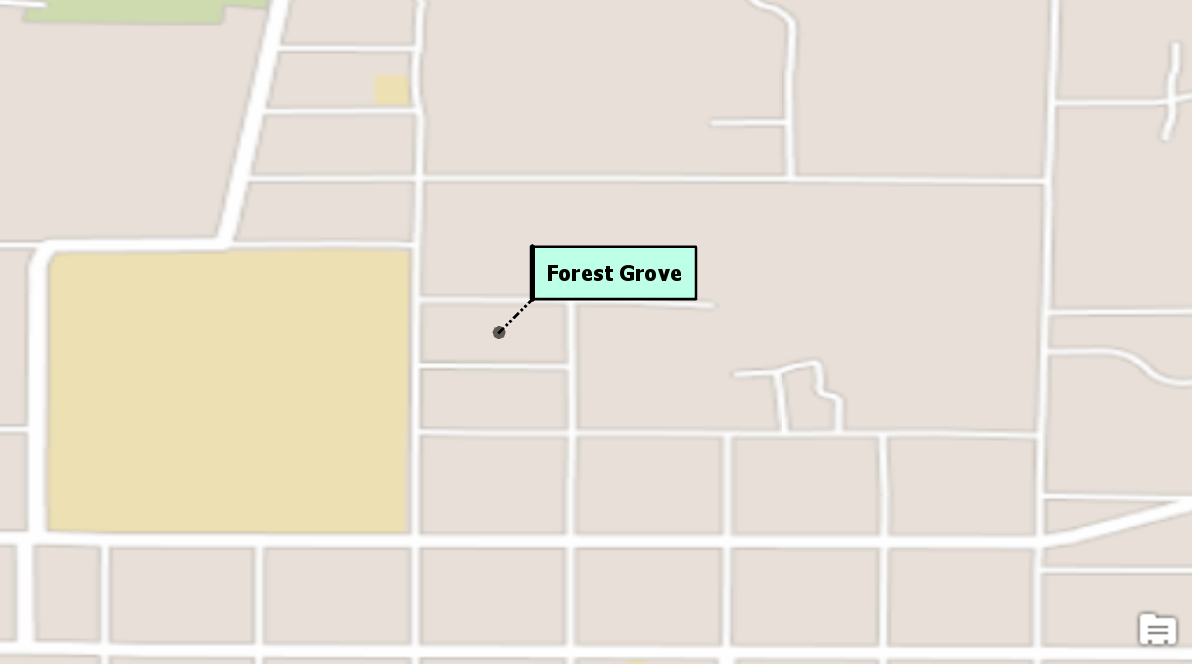

Snippet Creates a background callout text symbol
Creates a solid fill background text symbol with an Accent bar and leader line. The CIMBackgroundCallout created has a solid fill aqua polygon, with a black dash-dot-dash leader line and a solid accent bar. lineCallOut
  var textSymbolBackgroundCallout = SymbolFactory.Instance.ConstructTextSymbol(ColorFactory.Instance.BlackRGB, 8, "Tahoma", "Bold");
  //Create a call out
  var backgroundCalloutSymbol = new CIMBackgroundCallout();
  //Leader line
  //Get a line symbol
  //Create a solid fill polygon symbol for the callout.
  var aquaBackground = ColorFactory.Instance.CreateRGBColor(190, 255, 232, 100);
  var polySymbol = SymbolFactory.Instance.ConstructPolygonSymbol(aquaBackground, SimpleFillStyle.Solid);
  //assign the line to the callout
  backgroundCalloutSymbol.LeaderLineSymbol = lineSymbol;
  textSymbolBackgroundCallout.OffsetX = 10;
  textSymbolBackgroundCallout.OffsetY = 10;
  //Assign the polygon to the background callout
  backgroundCalloutSymbol.BackgroundSymbol = polySymbol;
  //Accent bar
  var accentSymbol = SymbolFactory.Instance.ConstructLineSymbol(ColorFactory.Instance.BlackRGB, 2, SimpleLineStyle.Solid);
  backgroundCalloutSymbol.AccentBarSymbol = accentSymbol;
  //Set margins for the callout
  backgroundCalloutSymbol.Margin = new CIMTextMargin
    Left = 5,
    Right = 5,
    Top = 5,
    Bottom = 5
  //assign the callout to the textSymbol
  textSymbolBackgroundCallout.Callout = backgroundCalloutSymbol;
