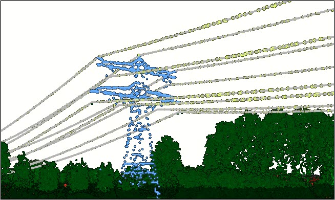

Illustration
Extract Power Lines From Point Cloud tool illustration
