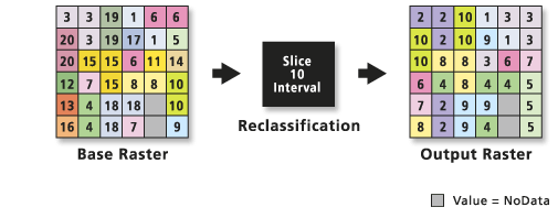

To divide the range of values into equal intervals, the Slice tool allows you to reclassify an input raster into intervals or area. For instance, if the range of values in an input raster is 1 to 200, and the number of intervals to slice is 10, the output raster will have 10 values ranging from 1 to 10. Cells with the value 1 to 20 on the input raster will be assigned 1, 21 to 40 will be assigned 2, and so forth.
The following example reclassifies the original values from base raster into 10 equal intervals to assign new reclassified values. The values range from 1 to 20 on the base raster and from 1 to 10 on the output raster.
Reclass by interval with Slice

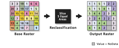

Slicing a raster into groups with equal areas, as with slicing into equal intervals, requires defining the number of groups into which to slice the output raster. Once the number of groups has been defined, the Slice tool attempts to distribute an equal number of cells in each group based on the count of cells in each zone. The number of values and the number of cells in each zone in the input raster and the specified number of groups will determine how close each output value or grouping is to containing the same number of cells.
The following example reclassifies the original values from base raster into five equal zones, each with the same number of cells (as close as possible).
Reclass by area with Slice
