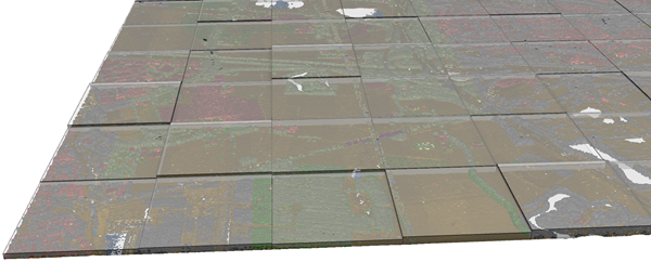

Creates polygon or multipatch output that captures the spatial extent and statistical information about one or more ASCII or LAS format point files.
Illustration
Usage
Each output feature will encompass the x,y extent of an input file. The features can be created as 2D polygons or multipatches depicting the z-range of each input file. The attribute table will have the following fields:
