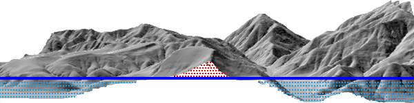

Summary
Calculates the area and volume of the region between a surface and a reference plane.
Illustration
Surface Volume tool illustration

Reference Plane
(Optional)
Specifies the direction from the reference plane that will be used to calculate the results.
  • Above the Plane—Volume and area calculations will represent the region of space between the specified plane height and the portions of the surface that are above the plane. This is the default.
  • Below the Plane—Volume and area calculations will represent the region of space between the specified plane height and the portions of the surface that are below the plane.
String
Plane Height
(Optional)
The z-value of the plane that will be used to calculate area and volume.
Double
