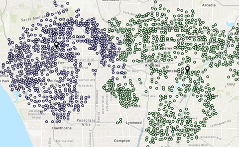

Consider an analysis in which an antique store owner is trying to better understand the distribution of customers who regularly shop at the store's two locations in Los Angeles County. The store owner wants to assess where the customers are driving from and how many customers are within 15 minutes of the antique stores.
Antique store locations and their customers on the map
Associate each antique store with its regular customers
The association between the antique stores and their customers is made using the Unique Store ID field from the antique stores layer and the associated Store ID field from the customer layer. The final geometry output shows rays from each antique store to its respective customers.

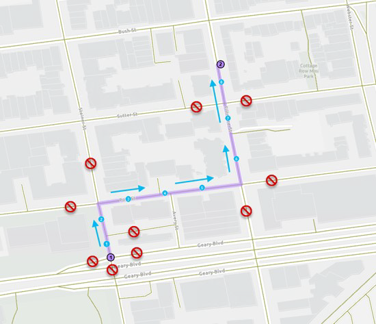

The second step in the analysis is to place the stores and the customers on the nearest street segments. This is an important step to get accurate results based on the network dataset. The store and customer points need to be snapped onto the streets that make up the network dataset. The algorithm will then solve for the shortest path between the antique store and its customers.
Solve for the store and each customer individually
Once the antique stores and their customers are located on the network and are also associated with each other, the algorithm solves for each store and its individual customers, respectively. To find the shortest path from a store location to a customer location, Dijkstra's algorithm maintains a set of junctions, whose final shortest path from the store has already been computed. The algorithm repeatedly finds a junction that has the minimum shortest-path estimate, adds it to the set of junctions previously calculated, and updates the shortest-path estimates. The algorithm continues until it returns the shortest path between the store and the customer location. The process is carried out for all customer points and the associated stores.
The following illustration shows how the algorithm only considers street segments (blue dots) that lead to the shortest path and ignores all other streets until it reaches the destination:
Streets considered for best shortest path are indicated on the map.
Note:
The geometry output of desire lines is not along the actual route; the algorithm returns straight lines with route measures, which are appended to the attribute table. The illustration is provided as a simplified representation of this process.

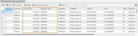

In the output attribute table, examine two key output fields. These fields are determined by the Distance Type and Measure Units parameters. The Measure Units parameter is further dependent on the Distance Type parameter. For example, Measure Units is set to Minutes by default, if Distance Type is set to Driving Time. Depending on the distance type and the measure units specified in the tool, the measures of the output along the shortest path are appended into the attribute table. The other attributes in the output table are from the input store and customer layers.
In this example, Distance Type is set to Driving Time and Measure Units is set to Minutes. Therefore, the output attribute table contains the following fields:
Output attribute table from tool

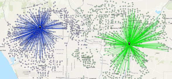

Draw desire lines that connect each store with its customers
As mentioned previously, the algorithm solver calculates, but does not display, the shape of the resulting shortest path. The algorithm only returns straight lines from origin to destination for faster performance and a clearer visual.
The image below shows the output from the Generate Desire Lines tool. The rays connect to customers who are within a cutoff of 15 minutes from the antique store. Customers that are not connected to the antique stores are those who lie outside the cutoff.
Output desire lines from tool
