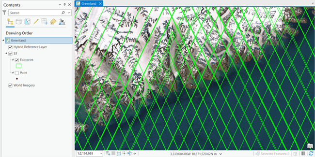

Trajectory layer
A trajectory layer allows you to visualize trajectory data in a map or scene. It includes a polygon feature layer that represents the trajectory footprints and a point feature layer that displays the measurement points. Each trajectory layer references a dense set of points from the input trajectory files.
