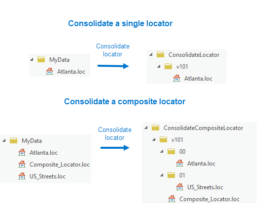

Illustration
Locator consolidated folder
The output folder structures of a locator and a composite locator that have been consolidated.
