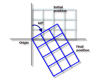

The following example shows a rotated fishnet constructed with the following parameter values:
  • Fishnet Origin Coordinate—(0, 0)
  • Opposite corner of Fishnet—(6.9, 4)
  • Number of Rows—3
  • Number of Columns—4
  • Y-Axis Coordinate—(6.9, 4)
When the tool runs, it first constructs a fishnet that is not rotated as shown in the following image:
Creating the cells
The next step is to rotate the fishnet by 60 degrees clockwise around the origin to obtain the final fishnet as shown in the following image:
Fishnet final position

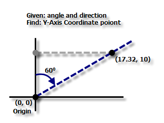

Calculate a value for the y-axis coordinate
If you know the angle of rotation, you can compute a value for the Y-Axis Coordinate parameter as described below.
Assume the fishnet is to be rotated 60 degrees clockwise. From the origin of the fishnet, draw a line so that it makes an angle of 60 degrees clockwise from the vertical axis (as shown in the image below). Any point on this line can be used as the value for the Y-Axis Coordinate parameter. Use a convenient value for the y-coordinate, and calculate the x-coordinate from the relation (assuming the origin is at 0, 0):
Tangent of angle = x-coordinate / y-coordinate
Fishnet Y-Axis point calculation
For example, the angle is 60 degrees. If the y-coordinate is 10, the x-coordinate will be 17.32:
\(\text{x-coordinate} \space = \space tan(60) \space * \space 10\)
