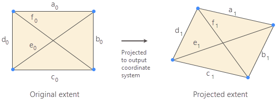

When projecting from GCS to PCS, or PCS to GCS, the output cell size is calculated based on the average of the ratios of the four sides and the two diagonals of the projected extent to the original extent. The following figure represents the original extent in PCS and the projected extent in GCS. The lengths of the sides and diagonals of the original extent are \(a_0\), \(b_0\), \(c_0\), \(d_0\), \(e_0\), and \(f_0\). The the corresponding lengths in the projected extent are \(a_1\), \(b_1\), \(c_1\), \(d_1\), \(e_1\) and \(f_1\).
Convert units method
The cell size of the projected extent is computed as follows:
\(CellSize_{projected} = \frac {\large 1}{\large 6 \space \Large {(\frac {a_1}{a_0} + \frac{b_1}{b_0} + \frac{c_1}{c_0} + \frac{d_1}{d_0} + \frac{e_1}{e_0} + \frac{f_1}{f_0}})} * CellSize_{original}\)
