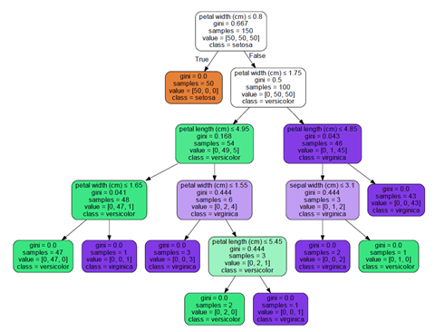

In the following example, a decision tree that classifies flowers based on the width and height of petals and sepals is shown:
Decision tree that classifies flowers example
