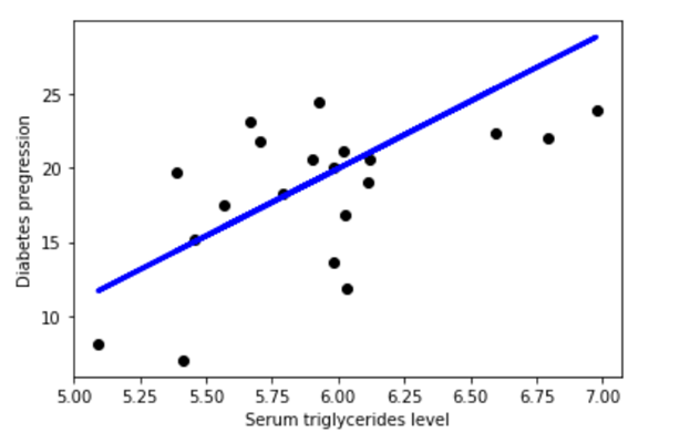

In the following image, a linear regression model is described by the regression line y = 153.21 + 900.39x. The model describes the relationship between the dependent variable, Diabetes pregression, and the explanatory variable, Serum triglycerides level. A positive correlation is shown. This example demonstrates a linear regression model with two variables. Although it is not possible to visualize models with more than three variables, practically, a model can have any number of variables.
Linear Regression example
A linear regression model helps in predicting the value of a dependent variable, and it can also help explain how accurate the prediction is. This is denoted by the R-squared and p-value values. The R-squared value indicates how much of the variation in the dependent variable can be explained by the explanatory variable and the p-value explains how reliable that explanation is. The R-squared values range between 0 and 1. A value of 0.8 means that the explanatory variable can explain 80 percent of the variation in the observed values of the dependent variable. A value of 1 means that a perfect prediction can be made, which is rare in practice. A value of 0 means the explanatory variable doesn't help at all in predicting the dependent variable. Using a p-value, you can test whether the explanatory variable's effect on the dependent variable is significantly different from 0.
