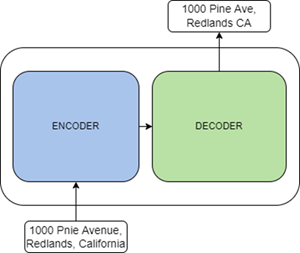

Transformer architecture
A high-level view depicts components of a Transformer.

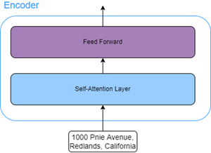

Encoder layers
A high-level view depicts components of an encoder.
All the encoders in the encoding component have identical structure. Each encoder has two sublayers:
  • Self-attention layer—This layer allows models to find other words in the input sequence to enhance encoding of a current word.
    As an example, consider the following input sequence: The man couldn't cross the road as he was injured. Here, the word he refers to the man who couldn't cross the road. A self-attention layer in this case will allow the model to associate the word he with the word man.
  • Feed forward layer—This layer accepts the output from the attention layer and transforms it into a form that the next encoder can accept.

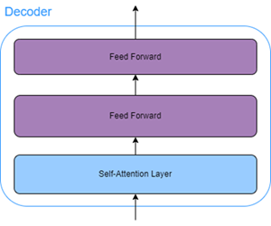

All the decoders in the decoding component have an attention layer, also referred to as encoder-decoder attention, in addition to the self-attention and feed forward layer. This encoder-decoder attention layer allows the decoder to focus on certain sections in the input sequence.
Decoder layers
A high-level view depicts components of a decoder.
