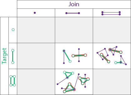

A spatial join matches features from the join layer to the target layer based on the features' relative spatial locations.
The following legend applies to all the examples in this topic:
  • Target features—Green
  • Join features—Purple
  • Target feature that exhibits the selected spatial relationship with join feature—Red highlight

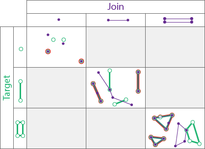

Equals
A target feature is equal to a join feature if their interiors are identical and the geometry types are the same.
In the following image, the target features in green are outlined in red when they are equal to the purple features:
Spatial relationship type Equals

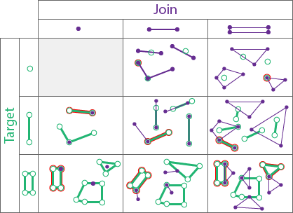

Intersects
A target feature intersects a join feature if it shares any portion of its geometry with the join feature. If a target feature contains, is within, crosses, touches, or overlaps a join feature, it intersects.
In the following image, the target features in green are outlined in red when they intersect the purple features:
Spatial relationship type Intersects

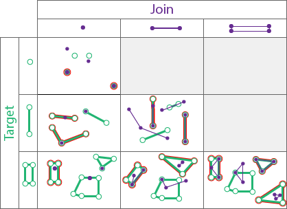

Contains
A target feature contains a join feature if the join feature is a subset of the target feature, with intersecting interiors. If the join feature is on the boundary and intersects the interior, the target feature contains the joined feature. If the join feature is only on the boundary (and not the interior), the target feature does not contain the joined feature.
This is the opposite of the Within operator.
In the following image, the target features in green are outlined in red when they contain the purple features:
Spatial relationship type Contains

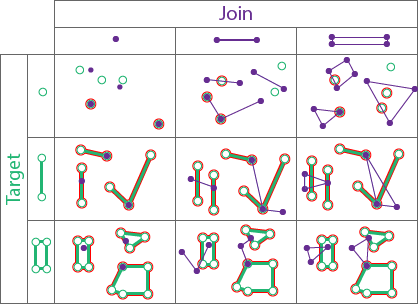

Within
A target feature is within a join feature if it is completely inside the join feature. A feature is within if the intersection of the interiors is not empty and the target feature is a subset of the join features. If there is no intersecting interior, the join feature is not within the target feature.
This is the opposite of the Contains operator.
In the following image, the target features in green are outlined in red when they are within the purple features:
Spatial relationship type Within

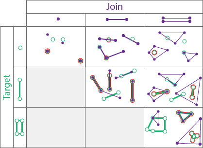

Crosses
Two polylines cross if their intersection contains only points, and at least one of the points of intersection is internal to both polylines. A polyline and polygon cross if a connected part of the polyline is partly inside and partly outside the polygon. A polyline and polygon cross if they share a polyline in common on the interior of the polygon, which is not equal to the entire polyline. The target and join features must be either polylines or polygons.
In the following image, the target features in green are outlined in red when they cross the purple features:
Spatial relationship type Crosses

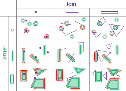

Planar Near and Geodesic Near
Conceptually, these operators buffer the target features using the specified distance and return all the target features that intersect the join features with the buffer applied.
The Geodesic Near operation is the same as Planar Near, except geodesic distance is used rather than planar distance. Choose this operator if your data covers a large geographic extent or the coordinate system of the inputs is geographic.
In the following image, the target features in green, with a near distance buffer (light green), are outlined in red when they are near the purple join features:
Spatial relationship type Near (Planar and Geodesic)
