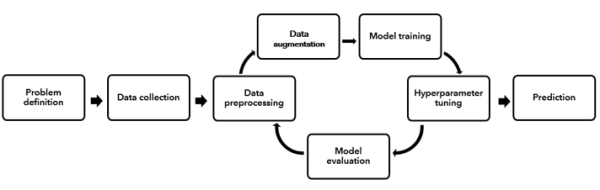

A typical deep learning (DL) project workflow begins with identifying the business problem and formulating the problem statement or question. This is followed by a series of steps, including data preparation (or preprocessing), model training, hyperparameter tuning, and model evaluation. This is an iterative process and the optimal model is often only reached after multiple iterations and experiments.
Deep learning workflow
