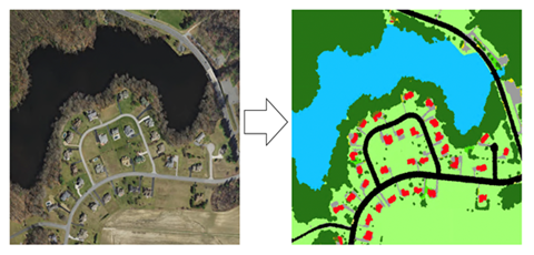

Semantic segmentation
Semantic segmentation, also known as pixel-based classification, is an important task where classification of each pixel belongs to a particular class. In GIS, you can use segmentation for land cover classification or for extracting roads or buildings from satellite imagery.
An example of semantic segmentation is shown.
The goal of semantic segmentation is the same as traditional image classification in remote sensing. This is usually conducted by applying traditional machine learning techniques, such as random forest or maximum likelihood classifier. Like image classification, there are also two inputs for semantic segmentation:
  • A raster image that contains multiple bands
  • A label image that contains the label for each pixel

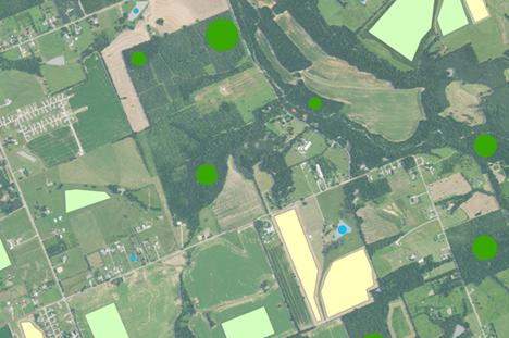

Training with sparse data
Not every pixel in an image is used in the classification of training samples. This is known as sparse training samples. Below is a diagram of the image and sparse training samples being selected. In this case of sparse training samples as below, you must set the ignore class parameter to 0. This will ignore the pixels that have not been classified for training.
Sparse training samples
An example of sparse training samples is shown.
