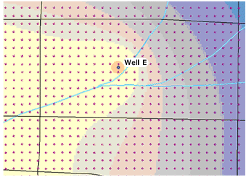

In the following image, Porous Puff and Particle Track were used to examine the distribution and track of a contaminant.
Examining distribution and track of a contaminant

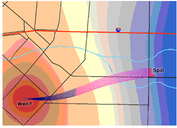

The following image demonstrates tracking particles from a contaminant spill to a pumping well using the Particle Track tool. From this analysis, you can determine whether the contaminant is getting into the drinking water for a nearby town.
Tracking particles from a contaminant spill to a pumping well
