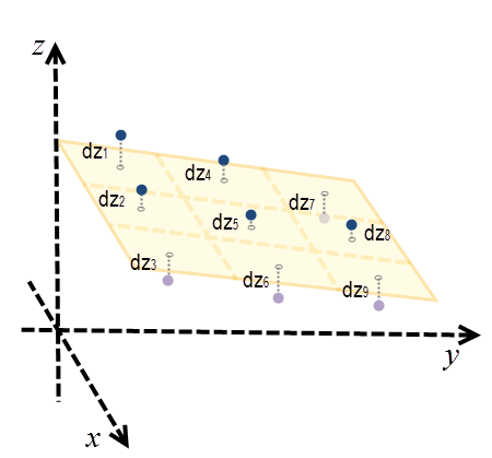

To calculate the aspect at each location, a 3 by 3 cell neighborhood plane is fitted around each processing cell using the Least Squares Method (LSM). The best fit in the LSM minimizes the sum of squared difference (\(dz_i\)) between the actual z-value and the fitted z-value. See the illustration below for an example.
Least Squares Fitting example
Here, the plane is represented as \(z = Ax + By + C\).
For each cell center, \(dz_i\) is the difference between the actual z-value and the fitted z-value.
The plane is best fitted when \(\large \sum \limits_{i=1}^9\) \(\large dz{_i}{^2}\) is minimized.
