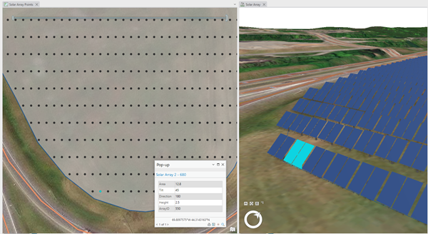

A solar panel array
The size and orientation of a solar panel array can be represented by point features with attributes for area, offset, tilt and direction.

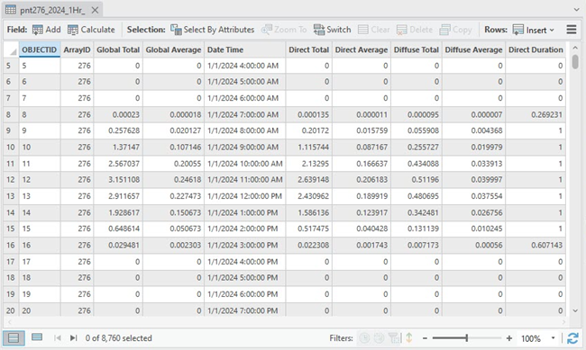

The result for time interval analysis is a time series feature table containing one-to-many records for each input feature and time interval. Analyze and explore the results with statistical analysis or visualize the data using charts to gain additional insights.
An example of the output attribute table for a solar power array is shown below.
Time series feature table result

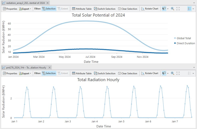

Some examples of the graphs for solar potential energy, duration, and hourly peak amount are shown below.
Time series chart
Explore feature solar interval results or visualize data with charts.
