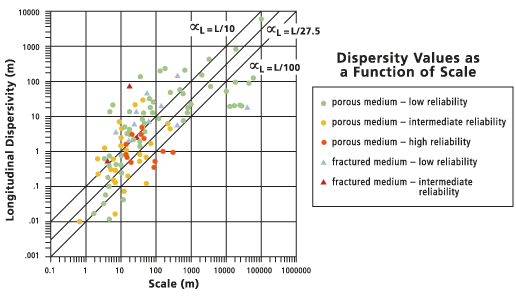

The following graph summarizes a variety of data from the published literature and relates longitudinal dispersivity to the scale of the problem of interest, meaning the distance from the source location to the point of observation.
Graph of Dispersivity values as a function of scale
The solid line (the center line) in the graph represents the default value for longitudinal dispersivity calculated by the Porous Puff tool.
The line is created from a linear regression fit of to L resulting in or , in which the length of the travel path L is the observation scale.
The statistics of this regression are also shown. The dotted outer lines are placed at and for comparison.
This default calculation should be used for guidance only, since some researchers denounce the use of such a universal fit. For any particular scale or site, valid dispersivities may range over two orders of magnitude, with the more reliable estimates tending toward the lower values. Rather than using the default value, which has no theoretical basis, you should perform several simulations using a range of dispersivities. Considering a suite of outcomes is more valid than using the results of one simulation.

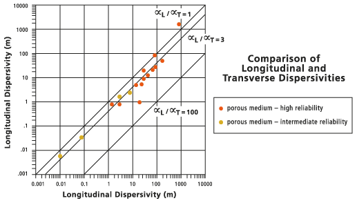

Similar caveats apply to the estimation of the ratio of longitudinal to transverse dispersivities presented in the following figure. These values are commonly related by a simple ratio, though again, you should experiment with a range of values.
Comparison of dispersivities
Graph comparing longitudinal and transverse dispersivities
The default dispersivity ratio is indicated by the solid line (the center line) in the figure below. The dotted lines (the outer lines) are placed at and for comparison.
