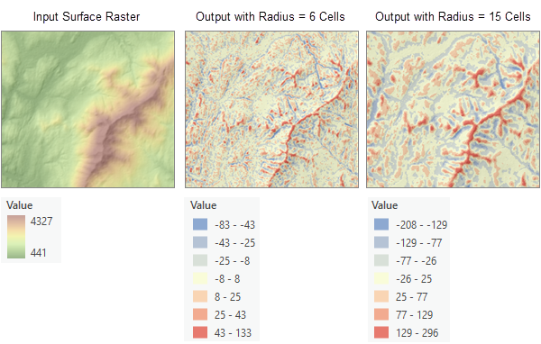

Topographic Position Index tool input and output rasters
The Topographic Position Index tool output rasters are calculated using circular neighborhoods with two different radiuses
