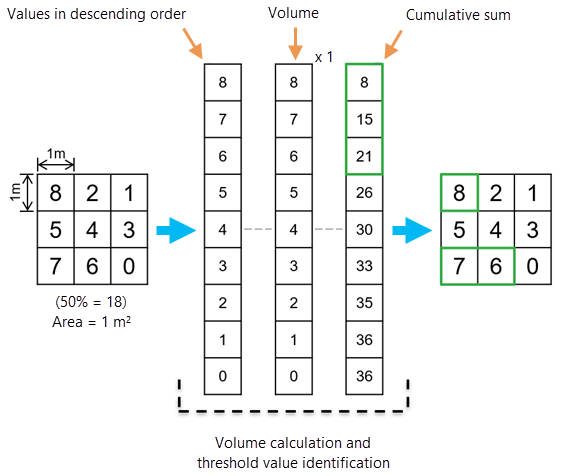

Workflow example
Assume a raster with 9 cells, and each cell has a cell area of 1 (\(A_i\) = 1). The following are the raster values:
Row 1:
8
Row 2:
5
Row 3:
7
6
The value list is: {8, 2, 1, 5, 4, 3, 7, 6, 0}.
The total volume of the raster is:
\(V_{total}\) = (8 + 2 + 1 + 5 + 4 + 3 + 7 + 6 +0) × 1 = 36.
The volume percentiles can now be calculated. For example, the following shows 50 percent, 75 percent, and 90 percent of the values:
\(p\) = 50 percent:
\(V_{50}\) = 0.50 × 36 = 18
\(p\) = 75 percent:
\(V_{75}\) = 0.75 × 36 = 27
\(p\) = 90 percent:
\(V_{90}\) = 0.90 × 36 = 32.4
By sorting the cell values in descending order (densest first) and accumulating value × area, you can calculate the cumulative volumes \(C_k\) at each value.
\(k\)
Value, \(d_{(k)}\)
\(C_k\)
8
8
7
15
6
21
5
26
5
30
6
33
7
35
8
36
9
36
To calculate 50th percentile volume contours from the example data, the target volume at that percentile is: 18 (\(V_{50}\) = 18). From the table above, the cumulative volume at \(k\) = 2 is 15. This is less than the target volume.
\(C_3\) = 15 (< 18)
At \(k\) = 3, the cumulative volume is 21. It is larger than the target volume. Therefore, this is the threshold volume and the value (6) at \(k\) = 3 will be the threshold value.
\(C_3\) = 21 (> 18) => \(k^*\) = 3
All the values at or above this point will be included in the volume contour.
Volume percentile contour calculation example
