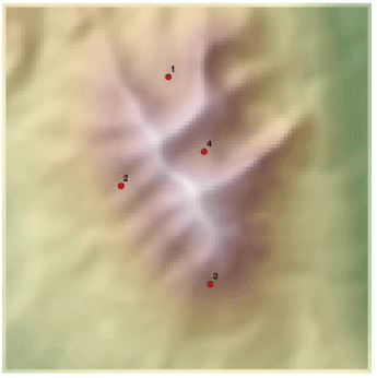

In the following graphic, four locations (numbered red points) have been selected along a hillside that represent potential sites for a vineyard. To maximize crop growth, it must be determined which location will have the maximum amount of sun exposure during the growing season (April–October).

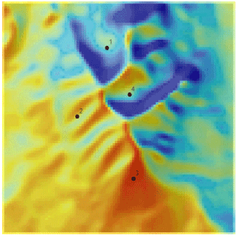

Using the area solar radiation analysis, the global insolation (direct+diffuse, WH/m2) has been calculated for the entire study area showing where the highest amounts of radiation are during the summer months (red = high insolation; blue = low insolation).
