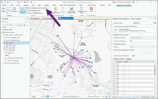

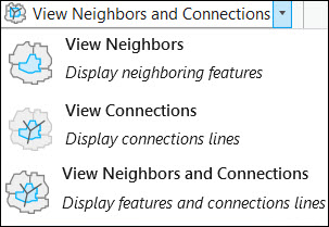

On the Neighborhood Explorer ribbon, in the Explore section, click the View Options drop-down menu and select a visualization option.
  • View Neighbors—Features in the neighborhood are visualized. If the layer contains polygon features, each neighbor is outlined in black. If the layer contains point or line features, the neighbors are symbolized with a different size and color.
  • View Connections—Neighbor connections (lines) that connect the focal feature to each of its neighbors are visualized. If the layer contains polygon or line features, a line connects the centroid of the focal feature to the centroid of each neighbor.
  • View Neighbors and Connections—Both visualization strategies are applied. It emphasizes the neighbors and displays neighbor connections.

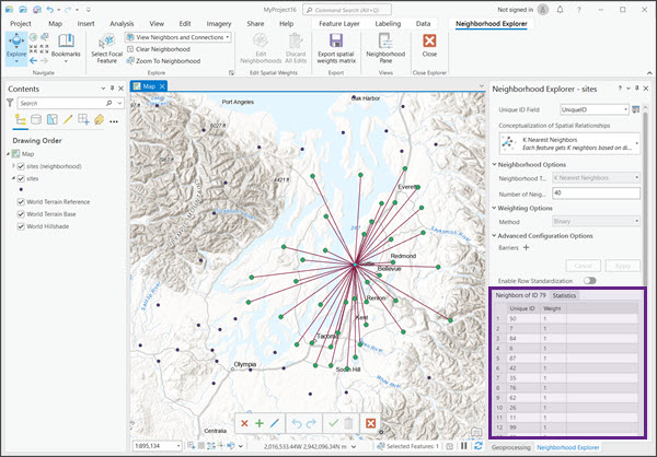

Neighbors table
The Neighborhood Explorer pane includes a table with the neighbors of the selected focal feature. You can view the table on the Neighbors of ID tab followed by the ID of the selected focal feature.
Neighbors table
As you select different focal features, the table updates with the neighbors of the new focal feature. The table includes a Unique ID column, with the ID of the neighbors, and a Weight column, with the spatial weights of the neighbors. If the Enable Row Standardization toggle button is on, the table includes a Standardized Weight column with row standardized weights. The row standardized weight of each neighbor is its weight divided by the sum of the weights of all the neighbors in the neighborhood.
You can also use the table to locate a neighbor on the map. Select a row in the table to highlight that feature on the map.
