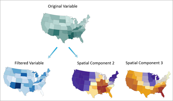

Illustration
Filter Spatial Autocorrelation From Field tool illustration
