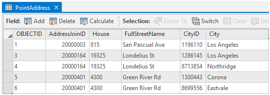

Reference data attribute table with two features with the same AddressJoinID value
In the table above, records with OBJECTID values of 3 and 4 define the same point address record because they have the same AddressJoinID value. These two addresses are located in the same city, which are valid alternate values (for example, Los Angeles and Northridge). However, the CityID values for those records are different, and the CityID value is the primary identifier for the city. This discrepancy causes a conflict because the two alternate names for the same city should have the same Join ID value.
