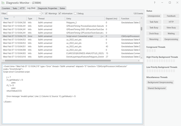

To help locate the problem, Business Analyst has implemented Python script logging in diagnostic mode.
To activate diagnostic mode, press Ctrl-Alt-M to open the Diagnostic Monitor and run the process that caused the error. In the Diagnostic Monitor window, click the Log tab, choose the error, and view the available options.
