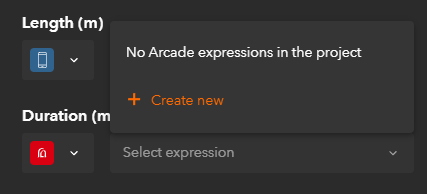

  3. On the Data tab, from the drop-down menu of the capture field, choose Arcade expression, and select Create new.
    Create a new Arcade expression.
  4. Write an expression with the aid of the Profile variables and Functions menu items.
  5. Provide a label for the expression, and choose Create.
The label of the expression that you just created is displayed in the capture field on the Data tab of the web designer. This expression is also available for re-use in the capture field of other buttons in this project.
