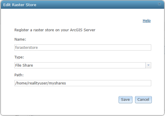

Register the file share raster store with ArcGIS Reality Server
  1. Sign in to ArcGIS Server Manager and browse to Site > Data Stores.
  2. Register a file share raster store. For the Path, enter the path of the folder in the Linux system (for example, /home/realityuser/myshares).
    Register fileshare rasterstore

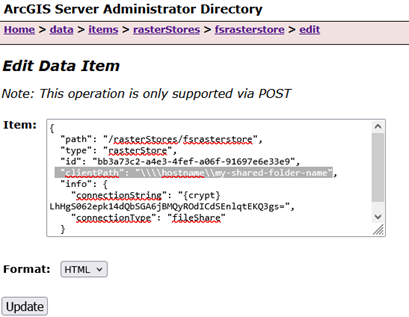

  3. Sign in to the ArcGIS Server Administrator Directory at https://webadaptorhost.domain.com/<webadaptorname>/admin.
  4. Browse to data > items > rasterStores and click the raster store name in the Child Items section.
  5. Click Edit.
  6. Add the clientPath parameter with the value pointing to the Samba path configured earlier (for example, \\HostMachineName\my-shared-folder-name).
    Edit client path
  7. Click Update.
