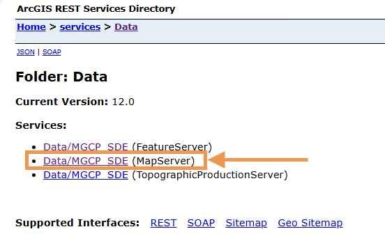

After the service is published, an
.sdeconnection file for the topographic data geodatabase must be saved where the Topographic Mapping product data files are installed on the server machine. The connection file must be named the same as the service ID of the MapServer service, for example,257da19aa16f4fe08cbbd438d42d260a.sde.
