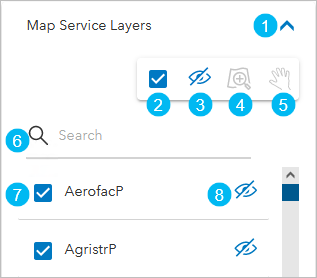

  4. Expand the Map Service Layers drop-down menu.
    Expanded Map Service Layers section in the Export Settings pane
    The numbers in the following table correspond to the numbers in the image above:
    Item
    Description
    1
    Expand or collapse the Map Service Layers menu.
    2
    Include or exclude all map service layers.
    3
    Show or hide all of the listed layers on the map in the app.
    4
    Zoom to the layer in the map that is selected in the list. The selected layer must be visible in the app's map.
    5
    Pan the map to the layer that is selected in the list. The selected layer must be visible in the app's map.
    6
    Search for specific layers.
    7
    Include or exclude a layer's data in the exported map product. If these are unchecked, the layer still appears in the exported map product without any data.
    8
    Show or hide the layer on the map in the app.
